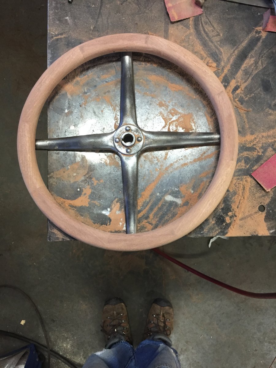

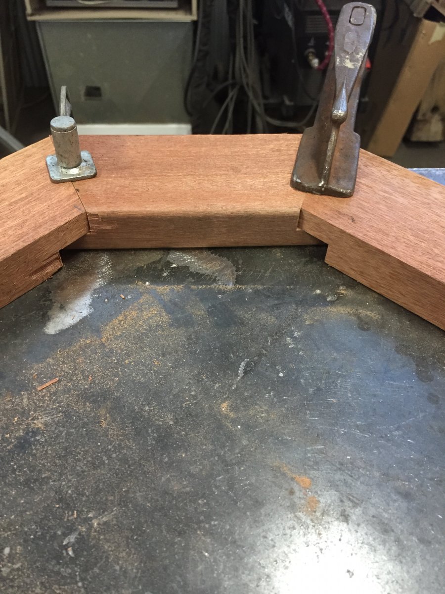

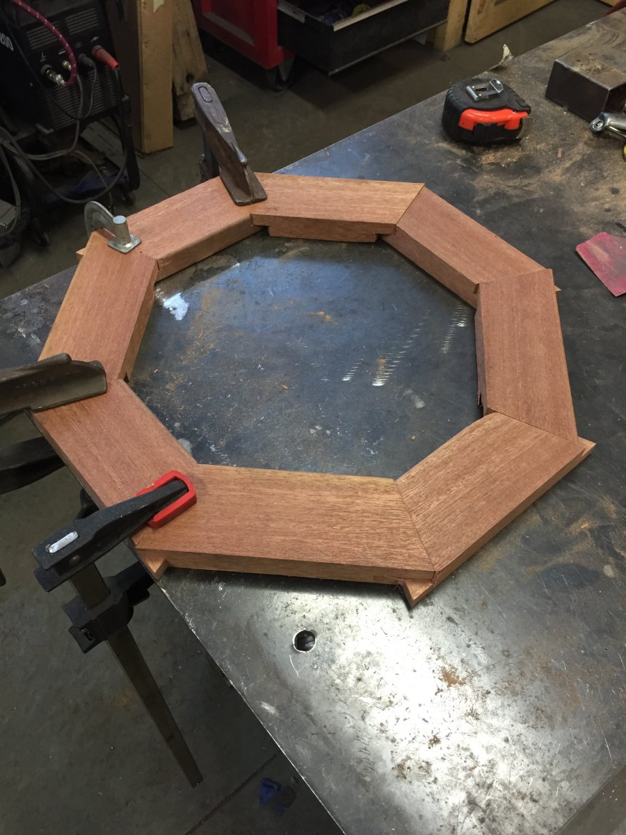

    Got my rim ruffed in after work today. Thinking I will need to add a fastener at the glue joints. I am also going to wrap the rim with a friction type string to give it the old timey race car vibe. IMG_2697.JPG IMG_2698.JPG IMG_2699.JPG

  23. gdaddy
    Joined: Mar 6, 2010
    Posts: 138
    gdaddy
    from nw fl.
    very nice , wood , steel and leather , what could be better ?

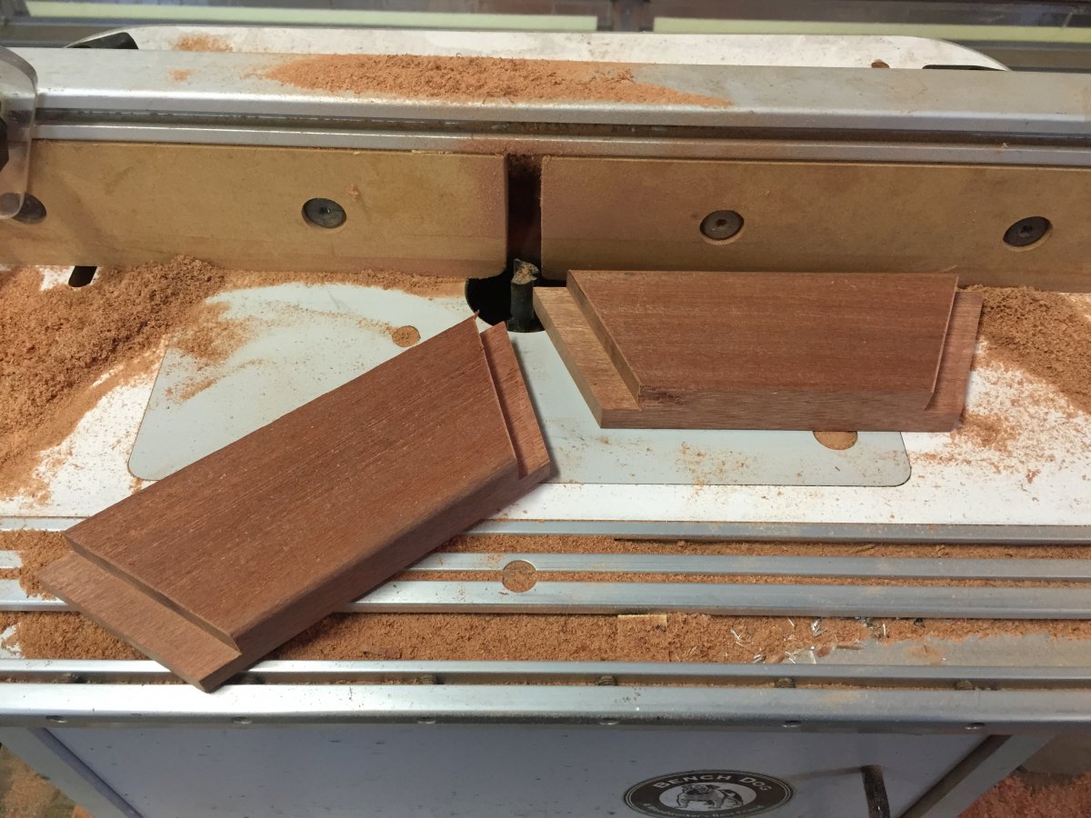

    How the heck did you do that on a lathe?
  26. rusty rocket
    Joined: Oct 30, 2011
    Posts: 2,652
    rusty rocket
    Well I'm a trim carpenter by trade. A good carpenter never tells his secrets!! O.K. I used a miter saw, router table and some sandpaper. Thats it.
    Gotgas, sodakmini and Stogy like this.
  27. Stogy
    Joined: Feb 10, 2007
    Posts: 5,791
    Stogy
    I see you have the tools of the trade (including your thinking mind) with the alignment fixture...Yeah you should be proud.

    Nice typo Rat...:D...cedars to soft but it would smell good...Rusty whats the wood tell us...
    Now Rusty's gonna say Cedar and make me look like an Ass...:confused::D
  30. rusty rocket
    Posts: 2,652
    rusty rocket
    It is called Batu. It is a Brazilian Mahogany.
