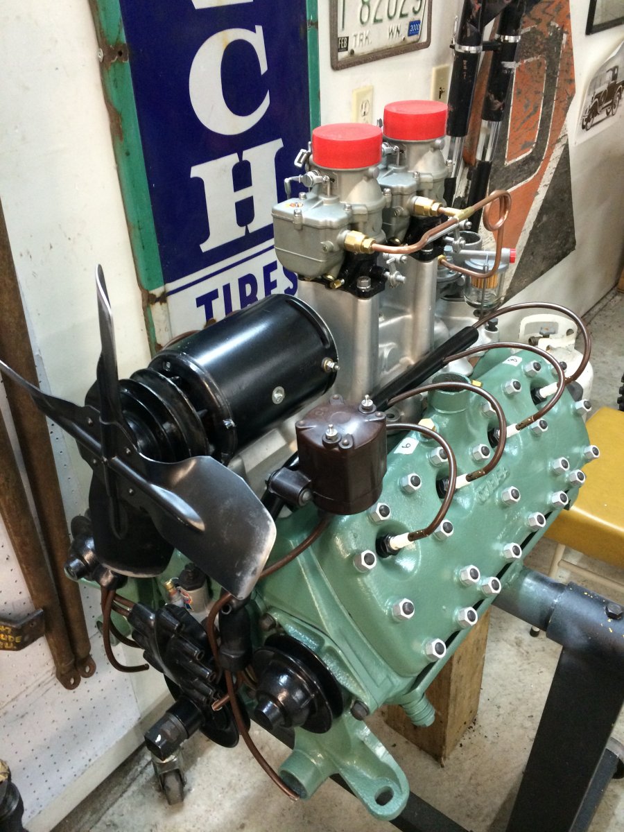

  8. flatheadtommy
    Joined: Oct 21, 2013
    Posts: 1,012
    flatheadtommy
    This is my 32 with a 50 Mercury engine with the correct placement of the fan. IMG_1449.jpg

  9. IMG_0012.JPG You would have LOTS of room if you went back to a 39 and earlier fan/hub style generator. The '32 fan is an easy one spot as it has a long hub to project the fan closer to the radiator where they got shorter (closer to generator) as years went on.

    That is exactly where I'll be directing my efforts. Thanks for the pictures. Was it difficult to put the early heads on your 8ba?

    Thanks for the pictures. I can see that you have a shorter hub, forward of the fan pulley, than I have on my fan. My fan, hub and, pulley are all one piece and cannot be shortened. What I need is the same exact fan that you are running. If I can score that I believe I will have it whipped. Can you tell me what that fan came off of? Good looking peek-up by the way.

  27. It is the fan set-up from a '48-'49 Ford pickup and others. Here's a drawing I copied from Mac VanPelt's website.
    It uses the wide belt.
