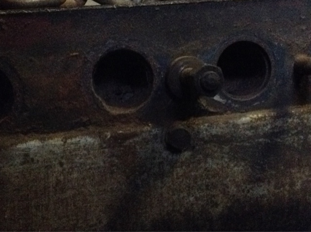

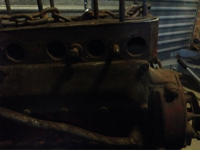

  1. Today I picked up this 1928 early engine, all looks like it would be great,,,but the exhaust ports are heavily rusted, bores are 60 over, no crack but has this heavy rust in the exhaust,ports. ImageUploadedByH.A.M.B.1418895184.073388.jpg ImageUploadedByH.A.M.B.1418895205.565198.jpg ImageUploadedByH.A.M.B.1418895231.790340.jpg
    Wanted it more for its reciprocating assy, sump and oil pump, but do I keep this engine block for future use or just scrap?
    Is there much "meat" in the exhaust ports for porting out, if so how much?

  8. If the block is not cracked too bad it is worth saving.
    Meat and Model A/B blocks are two words never used in the same sentence.
    The ports have very little material to remove for porting. With the combined rust in the water jacket and the external rust it will be thin.
    The early '28 blocks did not have the rib supports like the later ones around the rear main but probably will have the 5 bearings on the cam. The cam itself may be desirable if it is not too worn out on the center journal.
    Take it apart and do a crack check, I wouldn't put a OHV head on it but as a Flatty it should be fine.

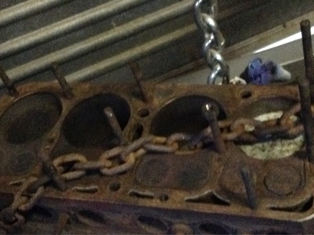

  11. Pulled the engine down today. Engine is a very early A, 5 cam bearing, beaver tail crank, pity about the exhaust ports being rusted, having a good look over they are too far gone. ImageUploadedByH.A.M.B.1419042253.881504.jpg ImageUploadedByH.A.M.B.1419042284.558653.jpg
  12. Looks kinda like the stuff that I put up with 50 years ago, as a kid. It DO make good hand-grenades, though! Careful! Keep the revs down!

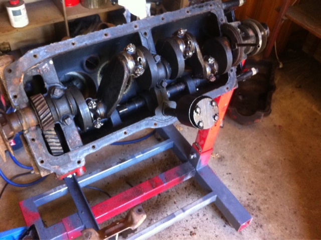

    Question on crank bolts, could I get away with just 4 bolts or do I need to have the extra holes drilled into the crank?
    Reason I ask ImageUploadedByH.A.M.B.1419229920.539233.jpg ImageUploadedByH.A.M.B.1419229944.391265.jpg is I just picked up my machined crank from my machinist.
    Bring it back to him with the crank adaptor or just use 4 ARP bolts?
