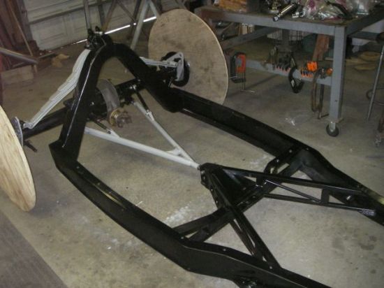

    When I built my rear axle locater "A" frame I made it from some late 30s rear wishbones and I ground the weld off to make them smooth. My rear suspension consist of my "A" frame that is connected to the bottom axle housing with pretty stout tabs on both sides of the center section and the center of the "A" frame has a 3/4 inch Heim joint that mounts to the center crossmember right under the drive shaft front U joint. To keep the rear end from rotating I have a pair of adjustable links that connect to the top of the axle housing and then to about the center of the links that I made from the wishbones. Well I have a habit of doing a short burn out when I come into my garage and I think this practice is what have caused the lower wishbone sections to start bending and one is cracking along the weld area that I ground smooth. Now I have a little shit box 2 liter 4 banger for an engine and my car weights around 1500 so if this can happen with this small motor a good V8 would have bent these into pretzels a long time ago. One of the things that you will find when you grind Henry's weld off is that it is pretty poor and is filled with pin holes and slag. If I were to do it again, I would grind out most of the original weld and then completely reweld, which is what I am presently doing. I am also adding some section to the area that is bending to eliminate that problem. Probably won't stop doing the burn outs.
