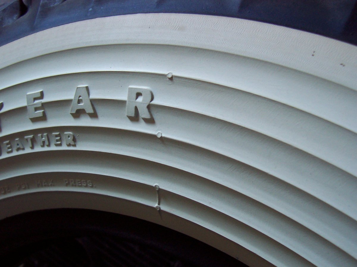

    Long story short Coker tire will accept 4 returned new Firestone 820x15 4 1/4" whitewall bias ply tires due to my displeasure at the randon rubber tits and pits in the whitewalls. Each tire has a flaw in the exact same position showing as either a pit or tit. They say replacements will be identical.
    I can shave the tits. Has anyone sanded flaws off whitewalls and if so please explain your process. I won't get than all but I think I can really inprove the finish. 102_2385.JPG 102_2386.JPG 102_2388.JPG

    I have taken a sharp new utility knife blade and trimmed the knobs off. Looks pretty smooth on my blackwalls where I took the time.

    If you don't want to send them back, try a nail clipper with a convex head. That should clean up the tits anyway.

  9. Actually you don't have to fix them that is the way that they came back when Firestone made them. All new tires used to have tits. I suppose that they could come sans tits, but someone is going to have to cut them off and that is a lot of extra overhead for a part that is considered to be a utility part.
    You can shave the tits with a razor blade. sometimes you get black spots where the tit used to be. That can be cured with a white crayon.

    but there's a few threads on buffing black sidewalls to remove the the lettering and makings. 80 grit on a DA seems to be the the way to go.

    You could wet sand with 2000 grit after you cut off the excess rubber. But you must sand in circular motions around the whole tire so that you do not get flat spots.
    Firestones are made in copies of original molds. Molds only have so long of a shelf life. I have not seen this dramatic of an excess rubber issue but then again it depends on the size as well. Remember Coker makes like a 500 to 1000 tire run at one time, which is why they are advising that the new set will look the same.

    I counted 60 + - highs that I can trim off each tire and 20 + - lows that I may sand.
    I'll use a skiving tool for trimming and that should help the appearance quite a bit.
    I won't settle for anything less than the widest white bias ply available even if it means extra effort.

    Hey guys I want to clear up some confusion on what you are seeing on this Firestone tire. As others have mentioned, it is part of the tire building process and while it may appear to some as a flaw or blemish, it is not. As the tire heats up in the mold the rubber must have somewhere to expand, the molds has vent relief holes drilled in them. The vent relief holes is where the rubber flows out and you get tits on the tire. Since the Firestone tires have lettering in the whitewall, we cannot buff the whitewall completely smooth. As far I know, this is how they appeared originally. If you think it doesn’t look good and would rather have a completely smooth whitewall, check out our BFG Silvertown tires. They do not have lettering in the whitewall so we are able to buff out all the mold tits, leaving a clean, smooth whitewall.

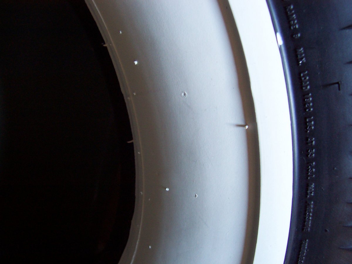

    I appreciate the response Jess. I attached more photos. The flaws appear to be too random and numerous to all be vents. 60 (sixty) specks, tits, pits etc. each tire. Why are the black back sides flaw and nearly vent free? What exactly besides the raised letters prevent the side walls from being buffed to a higher standard? Is it buffer operator error or is the buffer too cumbersome to individually buff the flaws away? Do you buff with an abrasive or a liquid of some sort? Magnified photos on the Coker web site of these tires show a blemish free ww. I understand evenly spaced tits for venting but this example seems flawed. I will most likely detail these tire to my satisfaction . 102_2392.JPG 102_2393.JPG 102_2394.JPG 102_2395.JPG 102_2396.JPG See my next post. Thanks. John

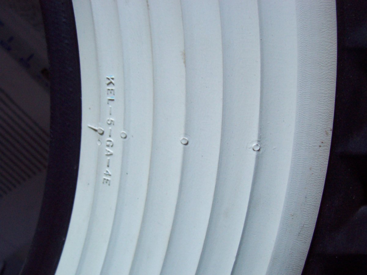

    The attached photos are of a tire that came in with a vehicle. I am in no way claiming that they are from Coker.
    Raised letters in whitewalls with evenly spaced and identical vent hole remnants I guess. This is acceptable in my mind. Just an example. John 102_2389.JPG 102_2390.JPG 102_2391.JPG
