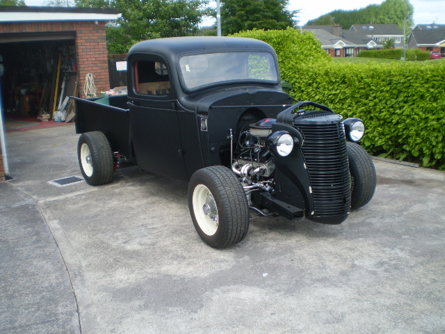

    beautiful work,there is also an opening for 38 chevy pu headlight stands.got some cast here with thicker wall and smaller openings.had to finish machine them myself..loctited studs inplace of threading bolts into the casting.made mounting them easier.stock made from poor quality alloy (pot metal )cast them in aluminium.light units are heavy and side mounted
