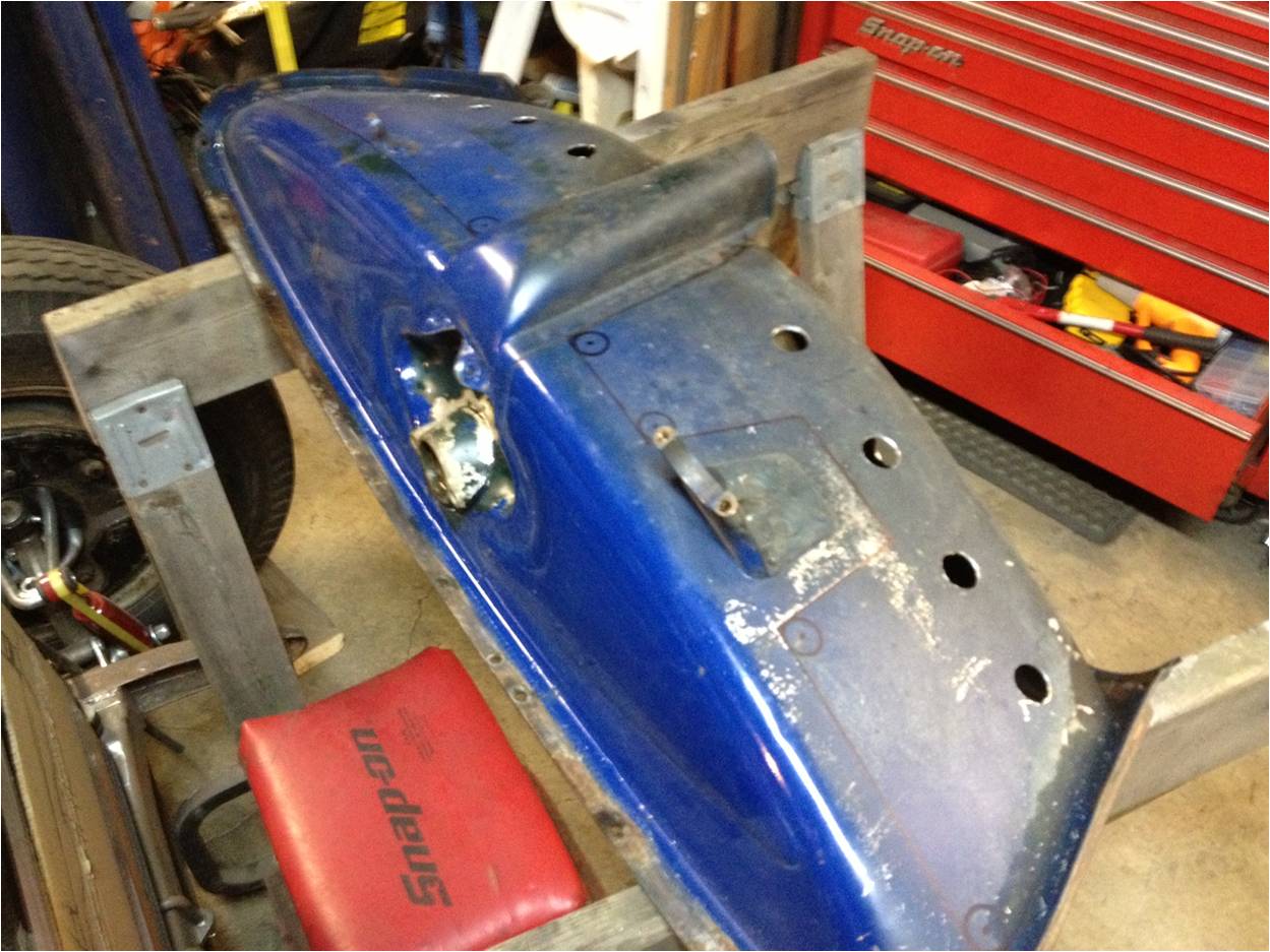

    Just did this on Sunday. Mine has been empty for about 3 months with the cap off but still smelled strong enough for me to worry about how to do it.
    First I rinsed with water, a full tank + sloshing it around. Did this twice.
    Next I used a carbide hole saw and put a bunch of holes in the part I was cutting out. My logic was that if there was a 'poof', I wanted to minimize pressure build up. You might say drilling holes could spark, and yeah, you're probably right. I was suited up pretty well with ear/eye/hand protection.
    Strapped it to a table and (still suited up) put a propane torch in each hole I drilled. Was totally fine. Then proceeded to finish it with combination cut-off wheel and plasma cutter.

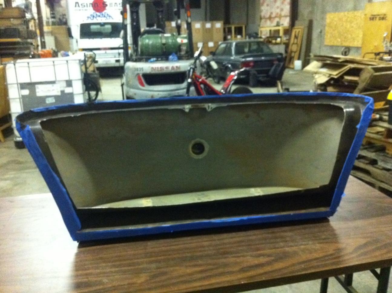

  20. The fuel tank removal went very well, I am quite content with the results
    Four steps:
    Good dish soap and hot water wash
    Drill and few holes and cut two large "windows" with a jig/reciprocating saw
    Rough trim with a zip disc
    Scribe a clean line around the left over edge leaving 1/2" of "lip or rib" and re-cut to line and tidy up with a sanding disc
    I left the rib to prevent the cowl top turning into an oil can.
    05snopro440 likes this.
