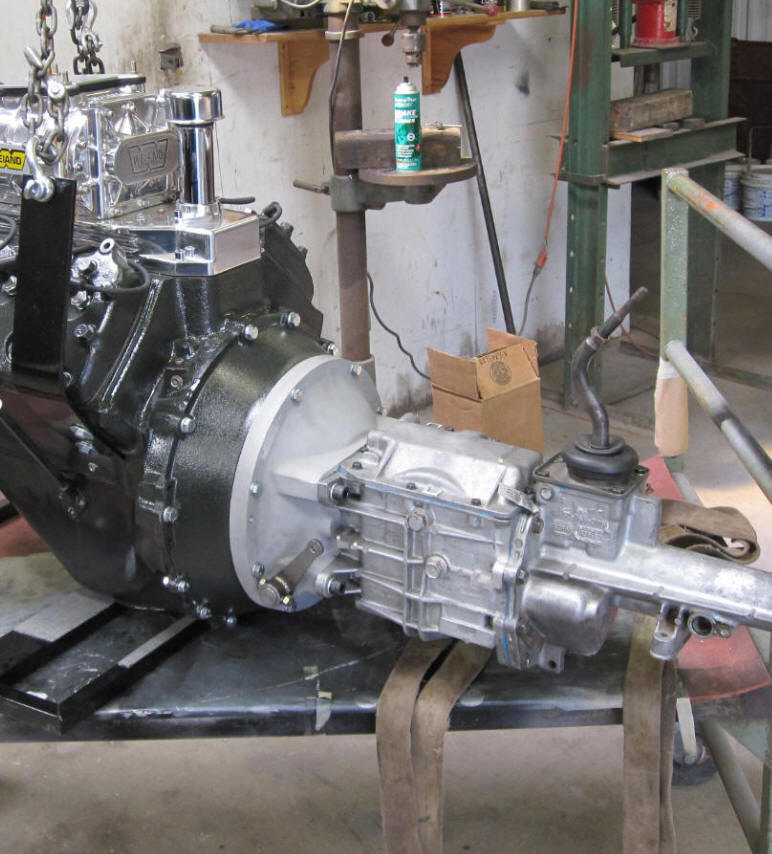

  11. NMCarNut
    Joined: Nov 28, 2009
    Posts: 635
    NMCarNut
    +1 on Cornhusker. Gary will sell you just the adapter or up to a complete kit including clutch:
