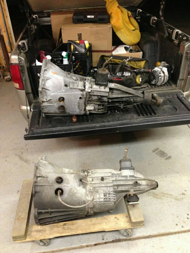

    These are the S10 NV3500.

    Mine certainly isn't a NV3500. It appears that I have the fairly useless 4cyl only trans. Dang!

    I thought the 2.2's had the NV1500

    I have a NV3500 in my hot rod, but its the one out of a 4.3L s-10. the 2.2 S-10 tranny is useless

    i concur, if it is out of a 98+ 4cyl, it is an NV1500. I've pulled mine out a couple of times. Unfortunately though, it will only fit the 2.2 4cyl's, can't swap bell housings or anything.

    Your wrong.

    :D. Ahhh....it has to be true....it has a decal. :D

    A crooked decal to boot. Nice!
