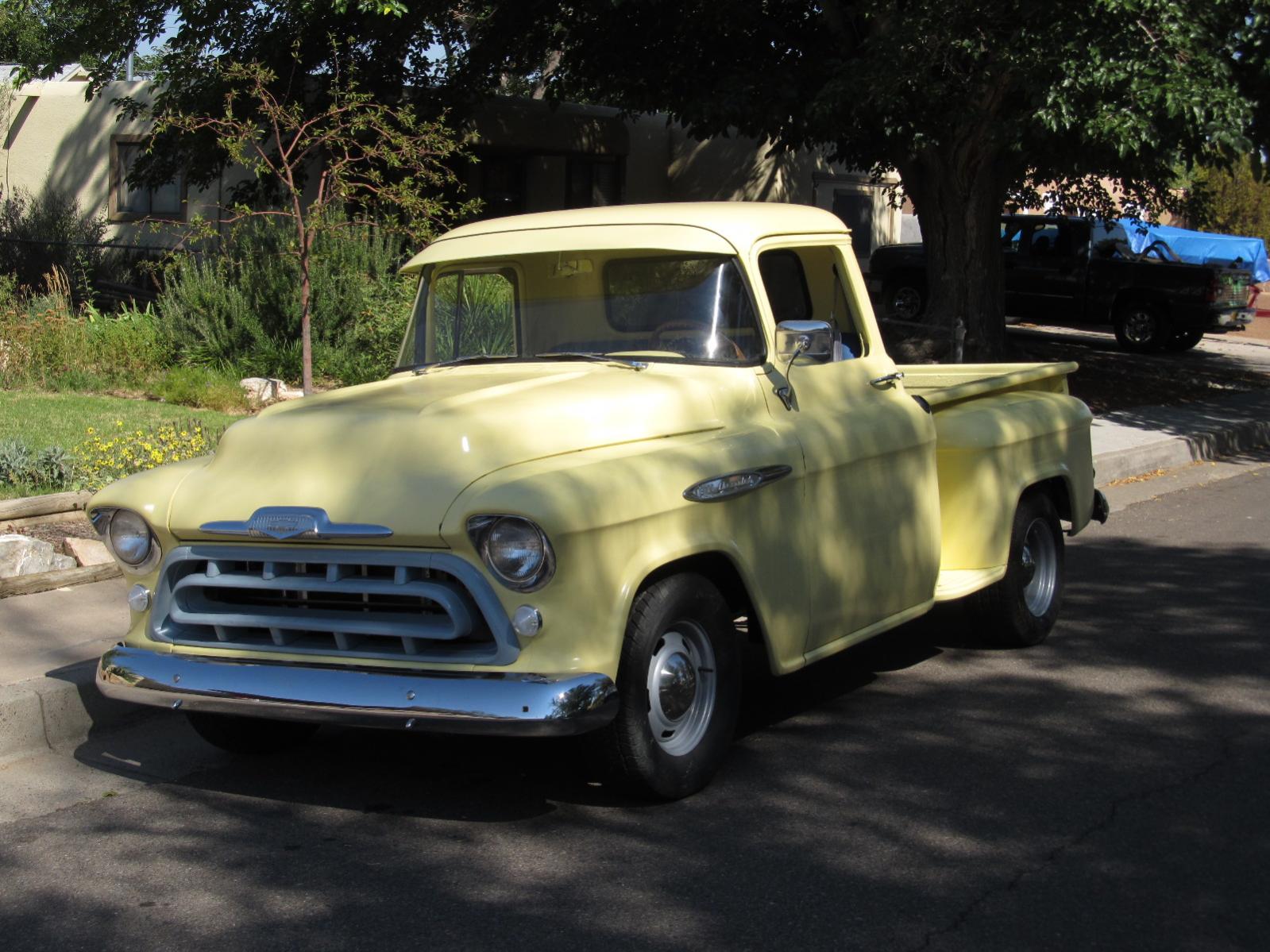

  30. classic gary
    Joined: Sep 24, 2009
    Posts: 504
    classic gary
    Harbor Frieght 9.99 gun
    rustoleum primer
    rustoleum 1 gallon yellow
    rustoleum 1 quart white
    turned this into this
    (but I will not do it again)
