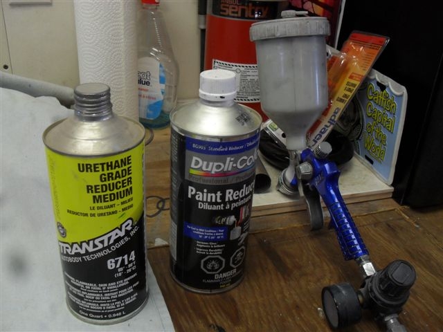

    A 1.8 tip is a tad large for topcoating, you may see even better results by stepping down to a 1.3 to 1.4 size tip. That 1.8 gun would kick ass for high build!

    You used 4 paint 1 thinner. What percentage hardner?????????????

    You stated that you used 4 parts 1 part of thinner. What percentage hardner did you use??????????

    Do the hardener as marked on the hardener container. Farm and Fleet and Tractor Supply have enamel hardener.

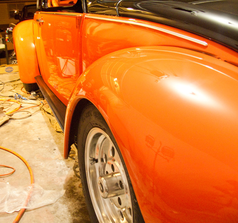

    Here's a couple shots of my last daily driver , shot with RustOleum satin black , thinned with acetone & shot through my siphon-feed gun . Turned out great & got lots of compliments , even after I told 'em it was RustOleum , lol !
    BTW , I had no intentions of ever repainting over it with "real" car paint - it was a daily driver & not worth a big $$ paintjob .

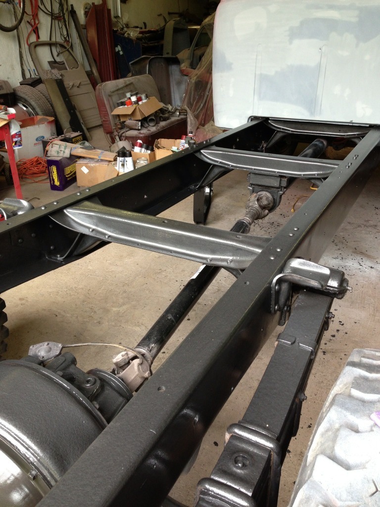

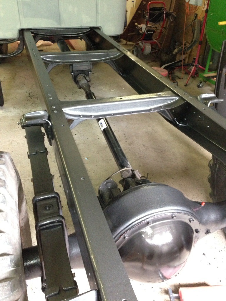

    I used rustoleum on the back of my 1952 Ford F-8. It's a "hammered" finish. Used it on other things and if prepped correctly, its fine. Plus I can get it in quarts, and use it in my HVLP gun. I'm not into show vehicles for the most part. My vehicles are driven.

    ImageUploadedByH.A.M.B.1379285340.908762.jpg ImageUploadedByH.A.M.B.1379285355.371505.jpg

    Looks good, and Urethane is a super hard shiny finish. I will not shoot this stuff though, do not like ISOs, and am not really set-up to deal with them.
