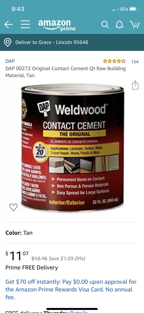

    Hey there, question:
    Is this a good glue to use for running board covers?
    I have an old set of 33-34 Ford running board covers, but I have no glue, and the online auto vendors, have their own labels covering the can so I’m just wondering is it worth it to buy their stuff, or just get my own glue?
    Thanks Rick!

  3. Yes it is. I've used it multiple times on covering running boards.

  4. 19Fordy
    Joined: May 17, 2003
    Posts: 8,027
    19Fordy
    That's what I used 40 years ago. Running board covers still holding.

  5. olscrounger
    Joined: Feb 23, 2008
    Posts: 4,770
    olscrounger
    ^^^ this--I have used it as well--works great

  6. hotrod1948
    Joined: Jan 17, 2011
    Posts: 512
    hotrod1948
    from Milton, WI
    It is what I used to attach Drake covers to original steel running boards on my 48 Ford. I did clean both the board and covers with lacquer thinner and used a scotch bribe pad to slightly rough up the back of the rubber cover.

  7. tim troutman
    Joined: Aug 6, 2012
    Posts: 846
    tim troutman
    didn't work well enough for me pulled it off cleaned it off started again .used lexal clear adhesive. word of warning make sure you put the cover were you want when you start it is not coming back off!

  9. paul55
    Joined: Dec 1, 2010
    Posts: 3,490
    paul55
    from michigan
    We've used vinyl top adhesive with very good results.
