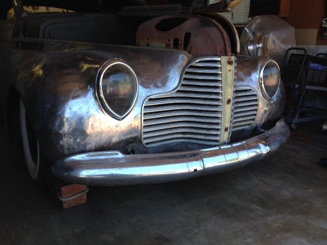

    So I'm trying to stay organized and efficient on this car. Its just to clean to just start hacking away with out doing my research. Every night I go and just stare at it and measure and remeasure. That being said I'm going to work from the front to the back. So I am going to start on the headlights. I'm going to put on 37/38 Ford headlights. I love the glass lenses. To me the Halogen bulbs on the stock front end just doesn't look finished to me. Plus when I set the Ford one up they look to match the grille so well.
    What do you guys think?
    Ranchero59, brEad, 54delray and 6 others like this.

    gatz
    Nice work. The Ford lights look great.....it'll keep people guessing.
    Will be watching this.

    That Henry teardrop design is way cool and the last of butterflies hooded Buicks-you nail it! More pics & updates...

    Ok what a F'd up month August was. I felt like shit just was going down hill and I had no time to play on the car. The good news is this car and my finished 53 stayed intact during a 6.0 earthquake in my home town. The bad news I had a 6.0 earthquake in my home town and my barbershop downtown was a mess.
    Here's what I did get done. So I am trying to work from the front to the back. Except I am going to skip the hood. I need some reinforcements to help me on that. Front bumper time. Again they are 41 cad bumpers. I had to make a few pie cuts to get the shape I liked and A LOT of getting up and down until I got the bumper brackets right. I like how it turned out what do you guys think?
    Next I wanted to make a splash pan (or whatever you want to call it) to cover the bumper brackets. So I made bucks and formed it. Using my shrinker and stretcher I was able to get them to curve down at both of the ends

    No worries and thank you for sharing your opinion. I knew the headlights where going to be the love it or hate it thing on my car. Everyone got mad when I shaved off the port holes on my 53. Luckily I'm not building the car for you.
    I drive the shit out of my cars and I did a little test/ mock up with that angle before I welded them in. Passed with flying colors.

  21. Hmmm.........I must admit the Ford headlights are growing on me. Ya have to understand us old farts were accustomed to seeing the 40-41 GM h-lights in 35-36 Fords back in the day. They were the cat's pajamas!
    As for the hardtop chop, well its............right on.. Subscribed.

    36 ROKIT. Thanks, yes I understand its not the "normal" treatment to the headlights. But for some reason I have always loved them and I think the fit nicely next to that grille. Like I said it will be the thing that some will love it and some will hate it. Thanks again for your input. I love learning and growing as a regular car guy. I hope to hear from you on other steps along the way.

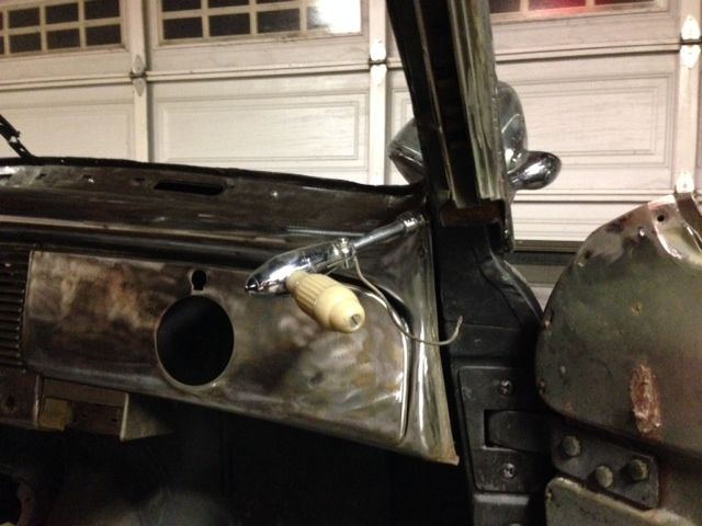

    Here's a little up date. I mounted my Appletons on the car this week. Something I thought would be so simple took me 3 nights after work. LOL its done and they turn out how I wanted them too.

    112's ?
  29. DirtyNapkin
    Joined: Jun 17, 2012
    Posts: 374
    DirtyNapkin
    from Napa, Ca
    Yep. You are correct.
