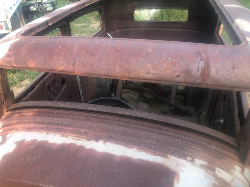

    I got a big hole to fill in the roof of my 32 Plymouth sedan and looking for ideas. Other than cutting a roof out of something else, what other options? I'm going to have a friend that does wood work to make the bows or cross pieces. It has a recess of close to an inch and then it has the groove around it where I guess you nailed the original on. That groove all the way around and the fact that it has a contour both ways presents a problem. I was thinking of a piece of plywood, padding and marine vinyl but I don't think it would contour right with the roof and end up with flat spots.

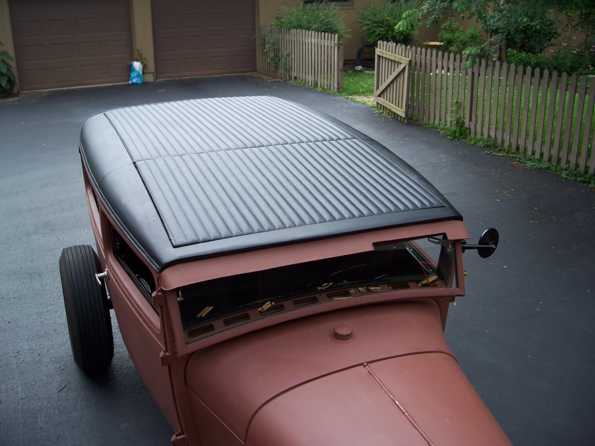

    I have seen the roof filled with a recessed piece of metal then a tuck and roll upholstered insert made and attached in the recessed area

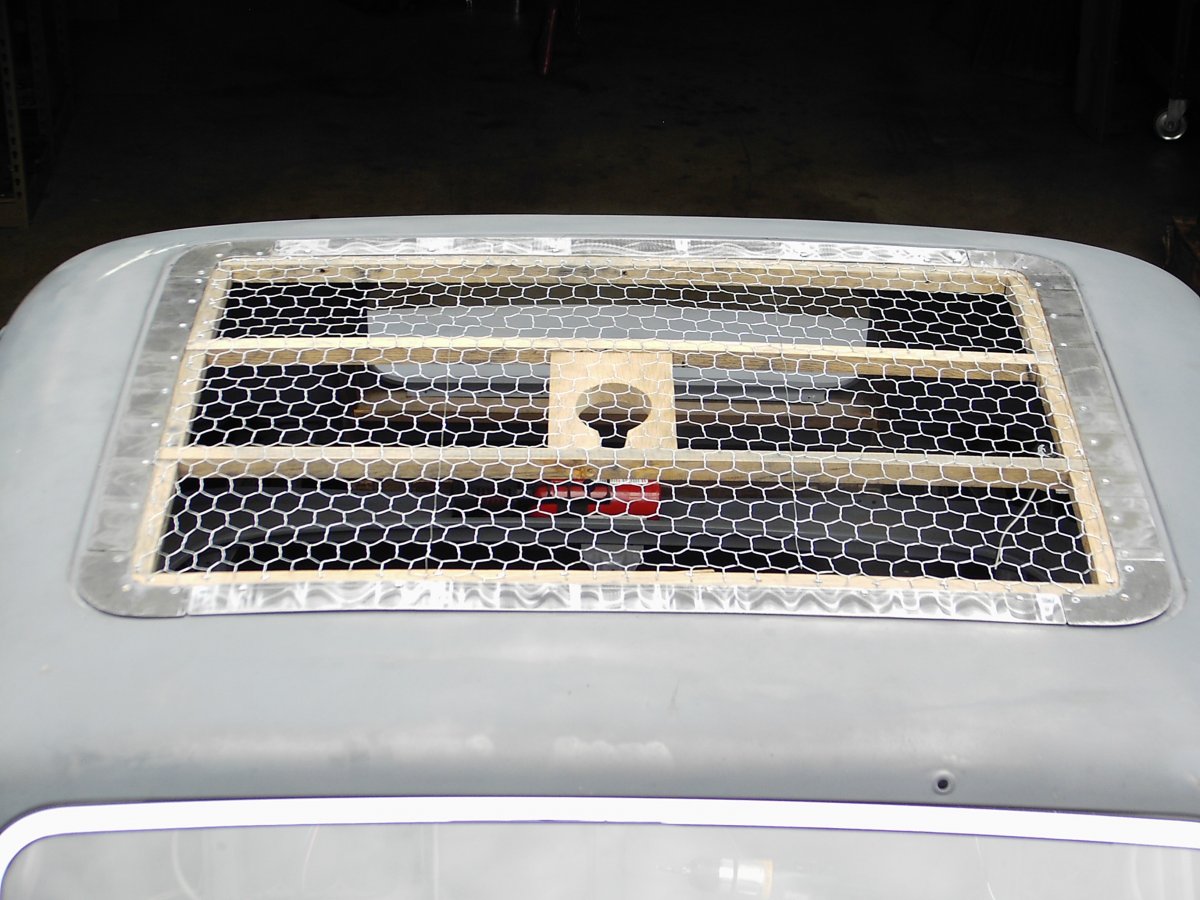

    Only did one on a 30A sedan the factory way,back in 1963 with a buddy,it wasn't a big deal. We made new wood all around,rim bows and slats. made the wood so it was 1/4in. below the steel top edge,tack in chicken wire as straight as we could. Added padding of cut to fit tarp in 3 layers with 1/4in. thick cotten between 2 of the trap. Over top of that a finish top of white vinyl/used for rag top cars,with tack strip trim. It would been better to use steel roof of a van or wagon. But the top we did the factory way lasted over 10 years in Florida sun.

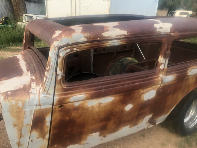

    Here is 2 bad pics, I can take better ones tomorrow. If you look at the corner of the top one you can see where the nails and strip I guess goes. The opening itself might not be to bad but I don't know what to do with that outer groove. I thought about a sheet of plywood covered and fastened from underneath. This was before I got the car and looking at this pic I didn't know how much contour it had. IMG_0430.jpg IMG_0429.jpg

    Mike - go back and look at my Prefect /roof insert. I am going to cover it after paint with the factory ford insert /black vinyl. I am going to put the factory Ford rubber seal around edges / back in the grooves. I used the factory wood bows to get the curvature/contour right. I actually used a sheet of aluminum-.040 I think ( I had it left over from another job). used door skin adhesive to set it to the bows - Lets just say it aint moving
    Your top contour and opening looks similar to mine- I know of a similar situation where a late model dodge mini van top/skin was cut and used for the insert -blocked and hammered the toe steps and inserted into the grooves - then used 1/2 X 1/2 steel bows- turned out neat and clean.

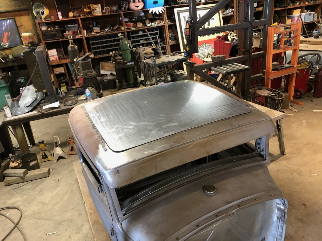

    If the 32 Ply about same size opening of 32 Ford , 4x8 16 ga $80 English wheel harbor freight $350 , & about 30 mints to crown . English wheel is not as complicated as it looks.

    It would take me 30 minutes , to cut and plan an attack on filling the top. I know nothing about shaping a piece of steel to fit an opening . I cut a buck from plywood , and took it to a scrap yard to find the correct donor top . 65 Mustang , and 53 Stude was the answer for my 3W . Once it was trimmed to correct size , the real work started , when attaching it to the car . Slow Slow steady process is best as I can describe the process. Small welds hammer and dolly and again slow . It took me about a week to slowly attach the insert , I’m sure it could have been finished faster by a pro , but the babies needed shoes , so it was up to me to do it good or bad .

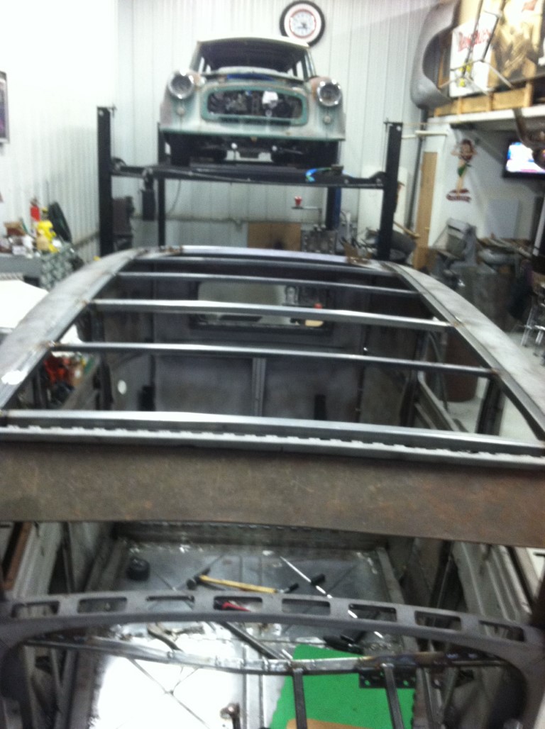

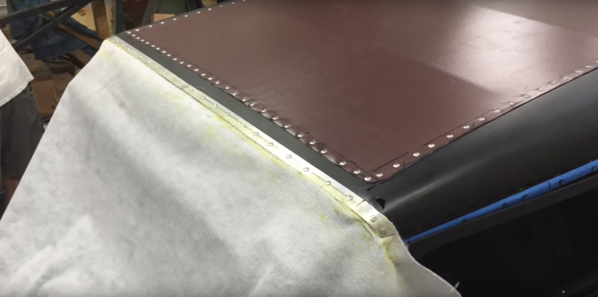

  26. Here are a couple pictures of how we built the roof structure on my friend's "A" and how his buddy layed out the fabric support.
    I rolled out some 1x1 & 3/4x3/4 16 ga tube for the roof structure and welded it in place. We made 2x2 wood frame and stretched the support membrane (think billboard fabric) over it. That was then layed over the roof, the taut material was then riveted down, after that the frame was trimmed off (you can see it leaning against the door in one of the pics), he then glued down foam, followed by the roof topping, and finished it off with hide-em.
    roller (2).JPG IMG_2517 (Medium).jpg Screenshot (14) (Medium).png Screenshot (18) (Medium).png
    I have always felt a fabric roof was part of what made old cars neat; so I'm not much for filled roofs and the ribbed panels are even worse.

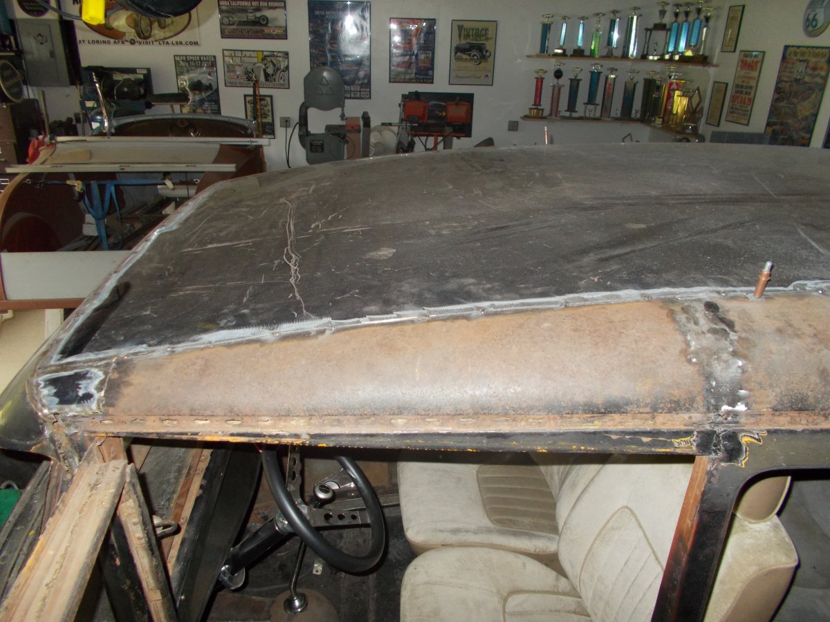

    A trick for picking a roof at a crushing yard...
    take a strip of wooden strapping...
    lay it across the to be filled roof left to right and mark for width...
    then lay it lengthwise and mark for length...
    hold the strip so that the gap between the strap and roof is even on both sides...
    measure that gap... write the width's gap measurement on the strap...
    measure front to back, write it next to the length mark on the strap...
    take the strapping with you to the yard...
    by laying it on in both directions of a donar's roof you can see at a glance if the gaps are close and if that roof should fit...
    helped a buddy pick an insert at the crushing yard, he used a Volvo wagon without a sunroof or ribs to fill a '30 tudor and it just barely fit...
    take your measurements and compare them to the '30 tudor's and see if a Volvo roof will work...
    if so, have the yardman cut it to be as big as possible...
    has a few cross braces "super glued" to the roof skin... be very careful as running a scraper between the roof skin and braces can easily crease the skin.
    IMO...maybe just cut the braces at the insert size, install it and then tack the leftover braces back on and then tack them to the mopar roof's insert edges...
    DSCN0817.JPG .
    used a club cab dodge pick up roof [no ribs] to fill my '30 coupe... DSCN0774.JPG

    You could do something like this...**clic pic** sedan top 013.JPG sedan top 014.JPG sedan top 015.JPG
