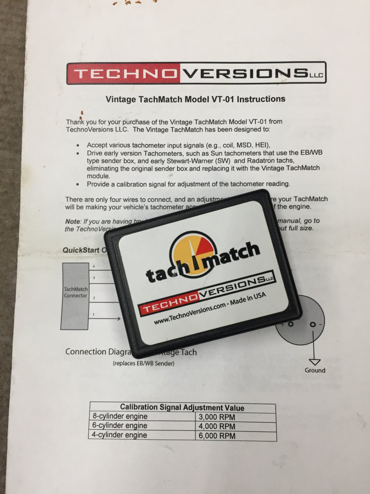

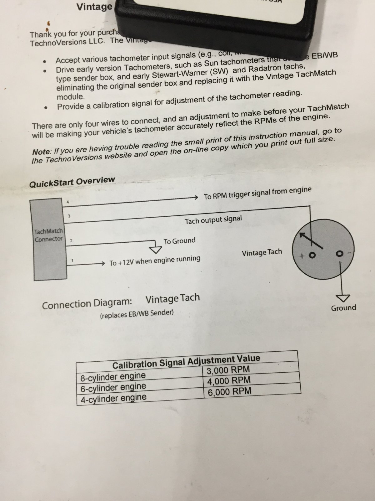

    Ok I fixed the tach. First I removed the cover from the sun transmitter and found just what I thought I would. Lots of corrosion and missing batteries. Those batteries have been out of production for a long time. A few years ago I had bought an electronic tach driver called Tachmatch from a company called techno versions and had not used it so I decided to put it in this car 7278C9C0-07EA-49E0-9E25-A25F26684A1E.jpeg C89B1848-02B6-4B8E-8E90-0ACB83FCD854.jpeg
    I mounted inside the original sending unit
    I did the calibration per the instructions and put the cover back on 10A90BD1-A330-4217-BB3D-8D7F794BF3AB.jpeg
    Pics of a working tachometer
