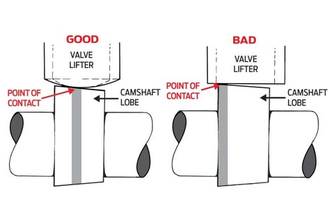

    Someone correct me if I'm wrong ...don't the ramps on a flat tappet cam keep it from walking ?

    The taper of the lobes mating with the crown of the lifter pull the cam back toward the block, controlling "walk" with a flat tappet cam.

    You are correct. But I suspect that at the transition between accel and decel there may be some cam walk going on. Comp cams says .004" to .010" is the range for endplay. Why not control that range down to .005" or so? I put in so many cam buttons with roller cams, it was just natural to install a button with the FT cam. They're cheap. There is also the consideration that any forward movement of the cam retards the timing. I think that button helps maintain a consistent spark, too.

    I don't see why accel or decel would affect the loads and subsequent direction of thrust on the cam, BUT I do agree with you on using a button anyway. It sure can't hurt and may well help when the cam tries to move forward for any reason. Not a bad plan at all.
