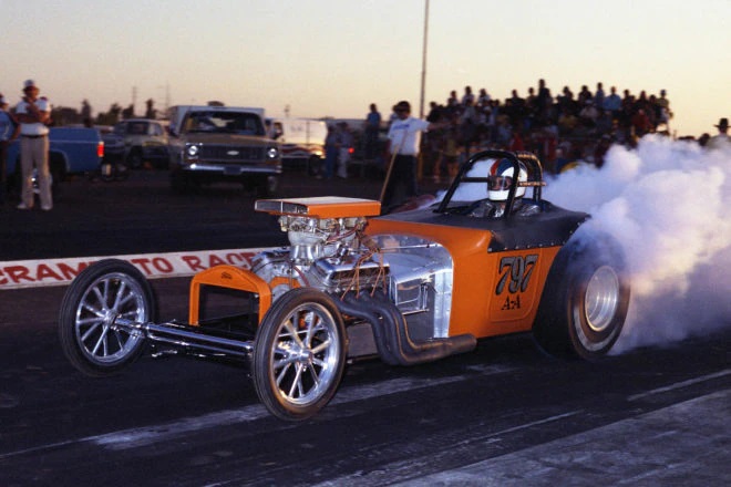

    i was wondering who came up with the modern style of roll cage for altereds. did nhra pay a designer or did some altered guy come up with it? or what?

    A picture of what your looking at..

  11. upload_2021-11-25_9-56-57.jpeg This is an altered chassis from S&W
    Here's a cool vintage one.
    Another. [​IMG]

    chevy57dude, thank you. the s&w pic and the vintage pic is what i was talking about. what i was referring to was the two bars over the drivers head. everybody is right though as i didn't say what years i was talking about. i build altereds for fun and profit. a lot of the former and very little of the latter. i build them for 10 seconds and slower. less rules and $$. i build them as a t bucket chassis with the legal tube size for the rest with the same overhead helmet and shoulder bars per the rules. nothing goes as fast as an altered for cheap money. i also like transformer cars too. i like any altered. thanks for the replies.
