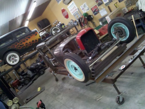

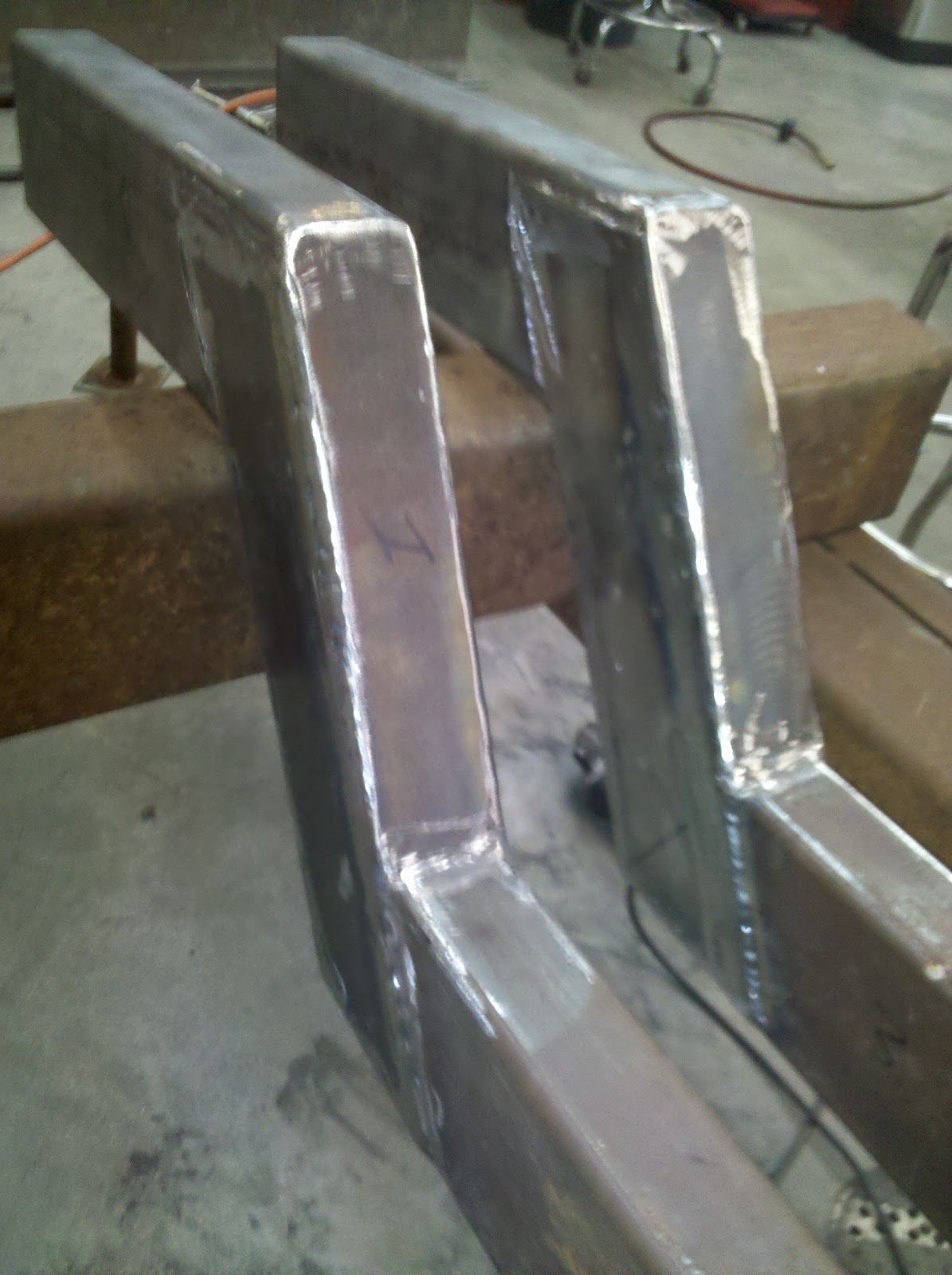

    Dad and I have been getting hot on the coupe finally and taking lots of pictures...thought i'd start this thread and share.

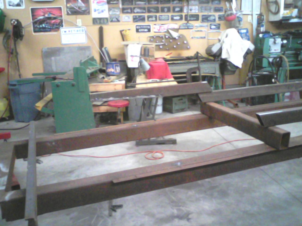

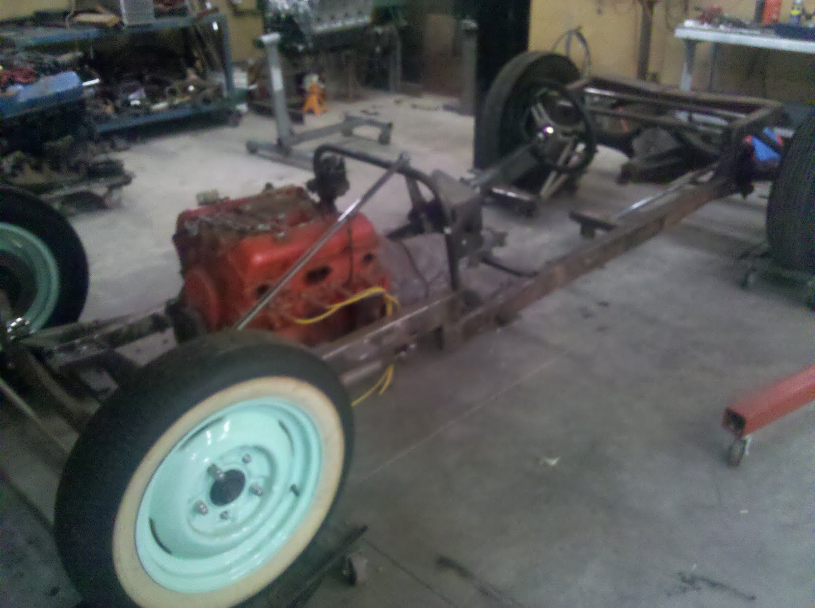

    Here are a few shots of the existing frame. We'd hoped to use this frame but its been through the ringer so to speak and the amount of work needed to clean it up just made us realize we'd better off building our own frame from scratch. ​

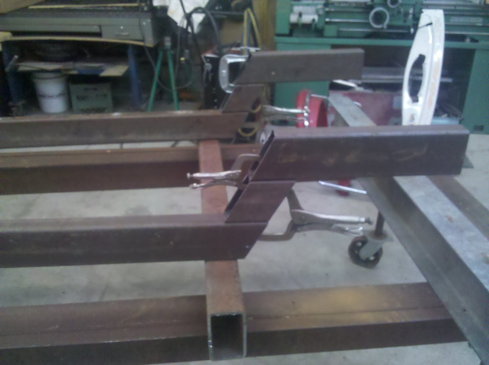

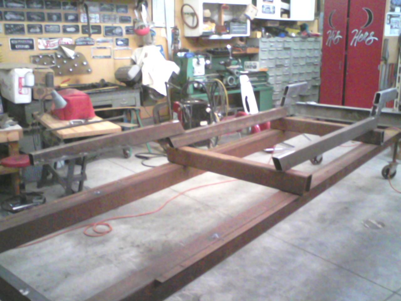

    Here's the beginings of the new frame. I like it better already.​

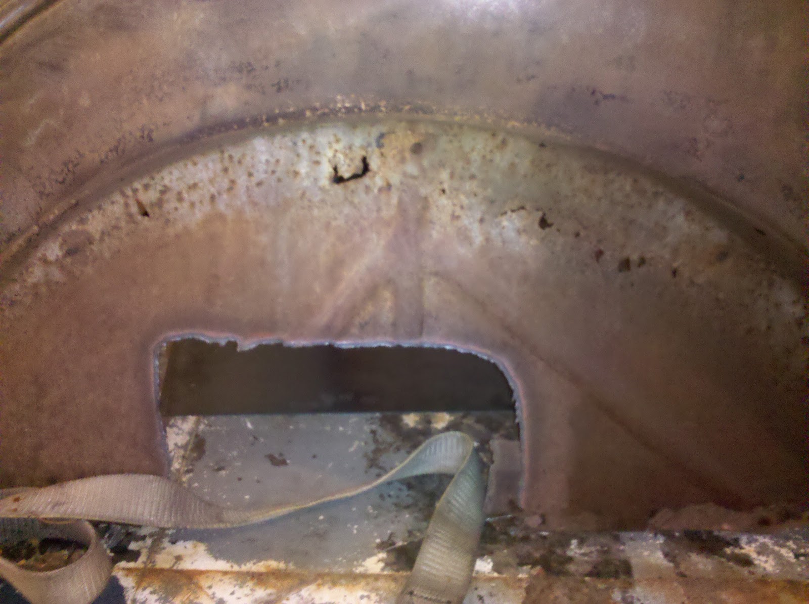

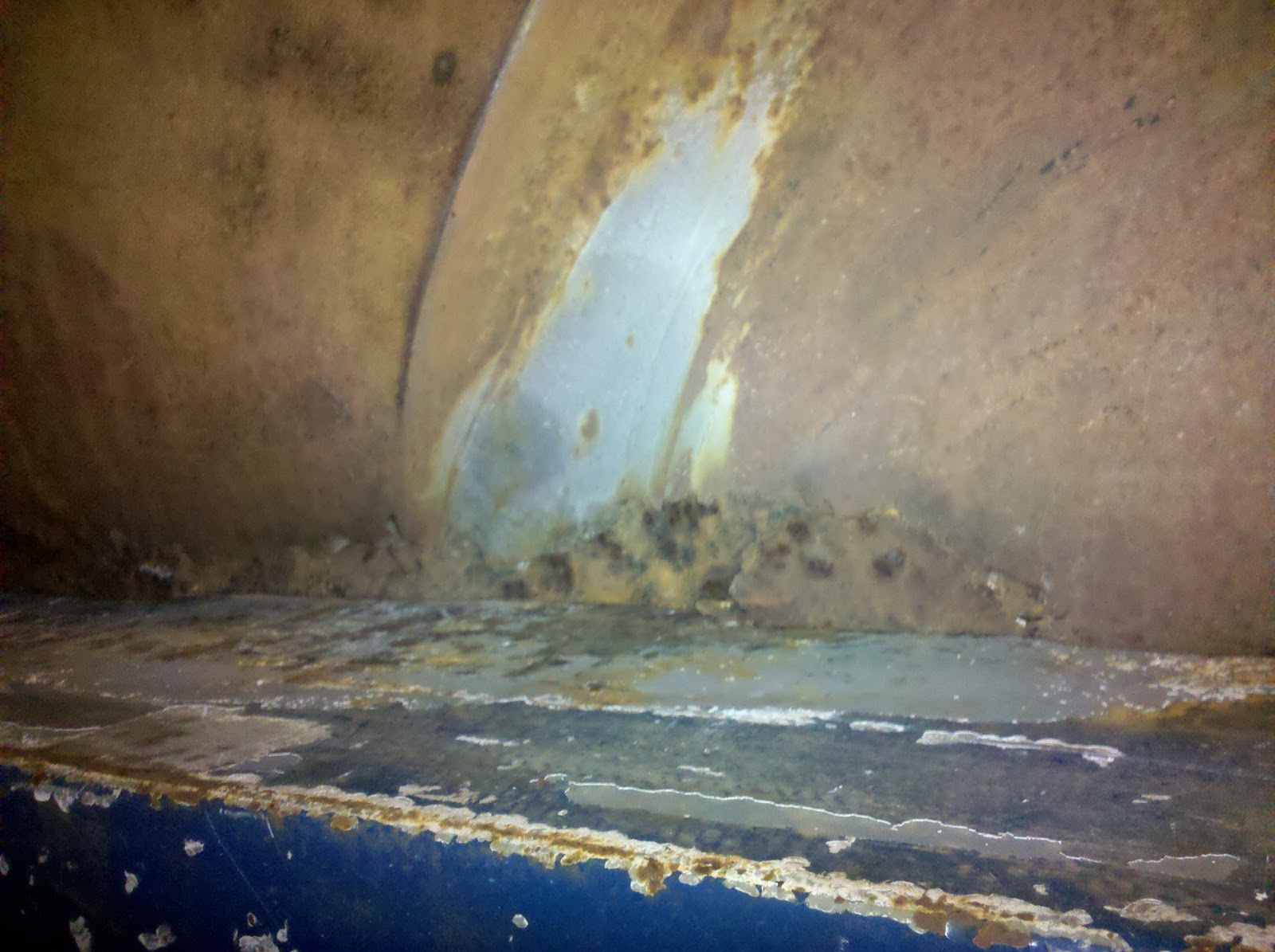

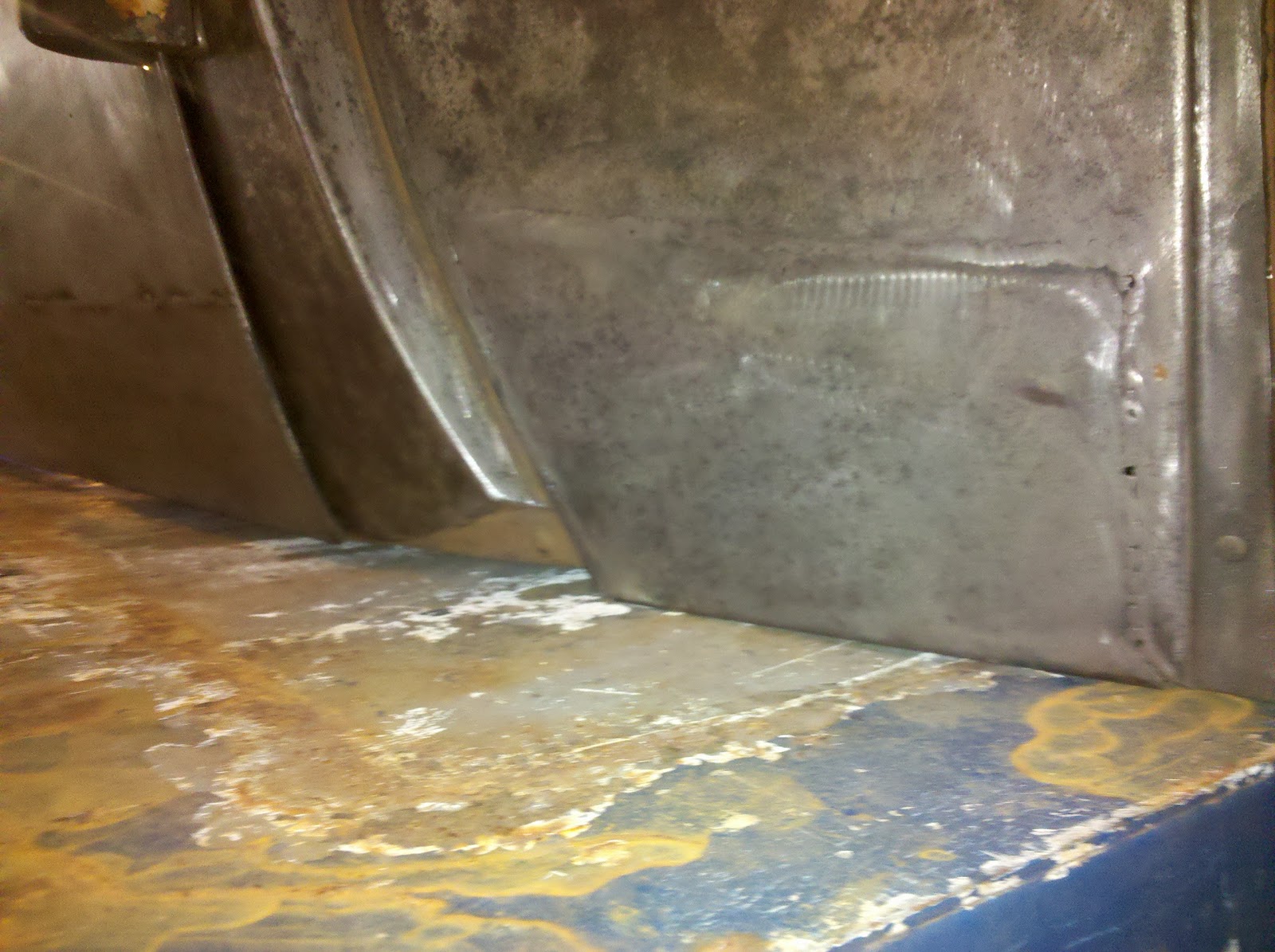

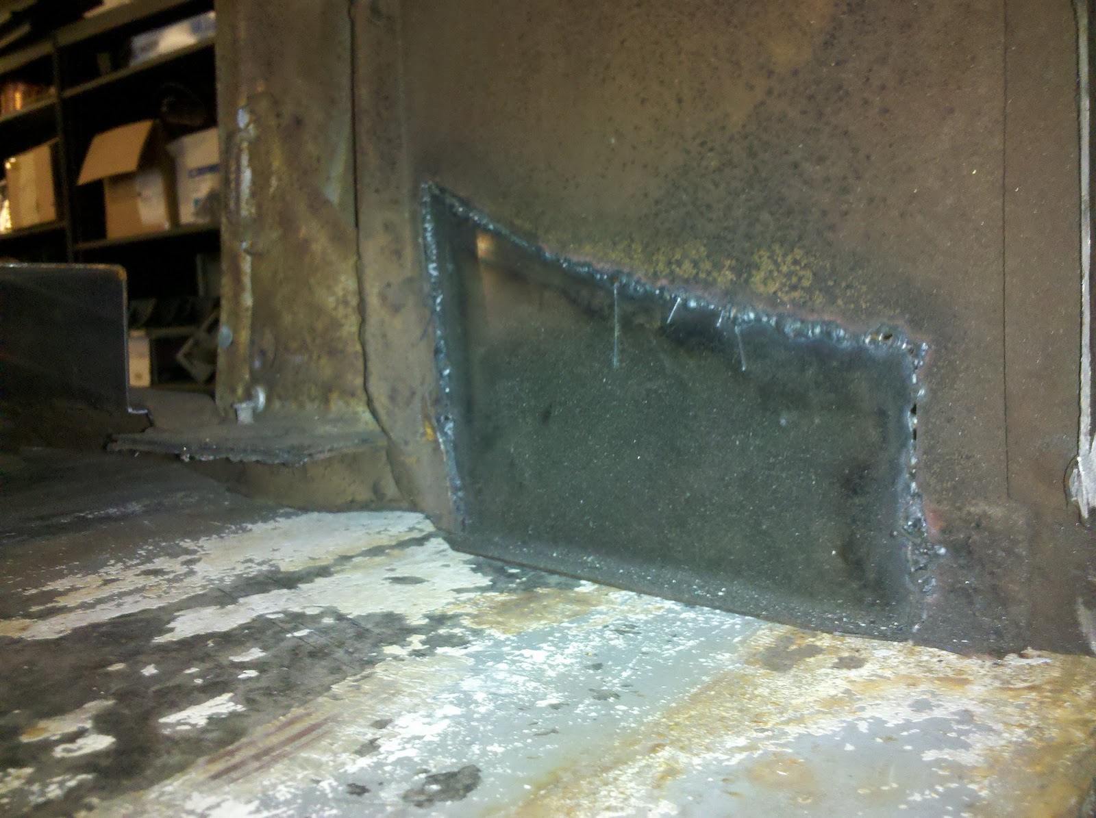

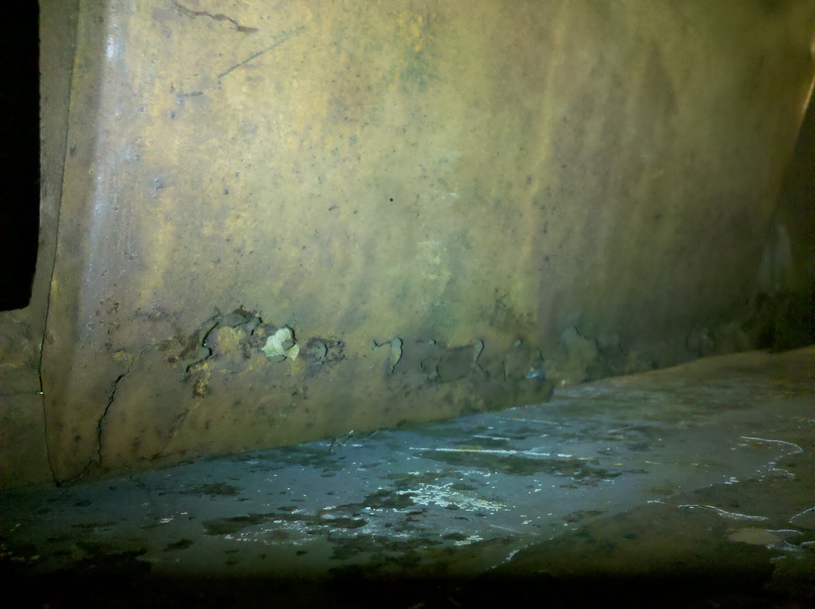

    With the body off the frame I can finish addressing the cancer in the back half. I'be replacing the inner fender panels and patching some areas in the lower areas
    FIRE GOOD!​

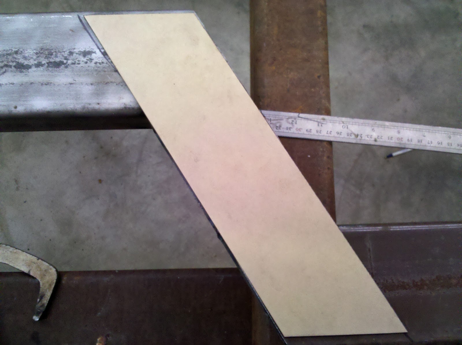

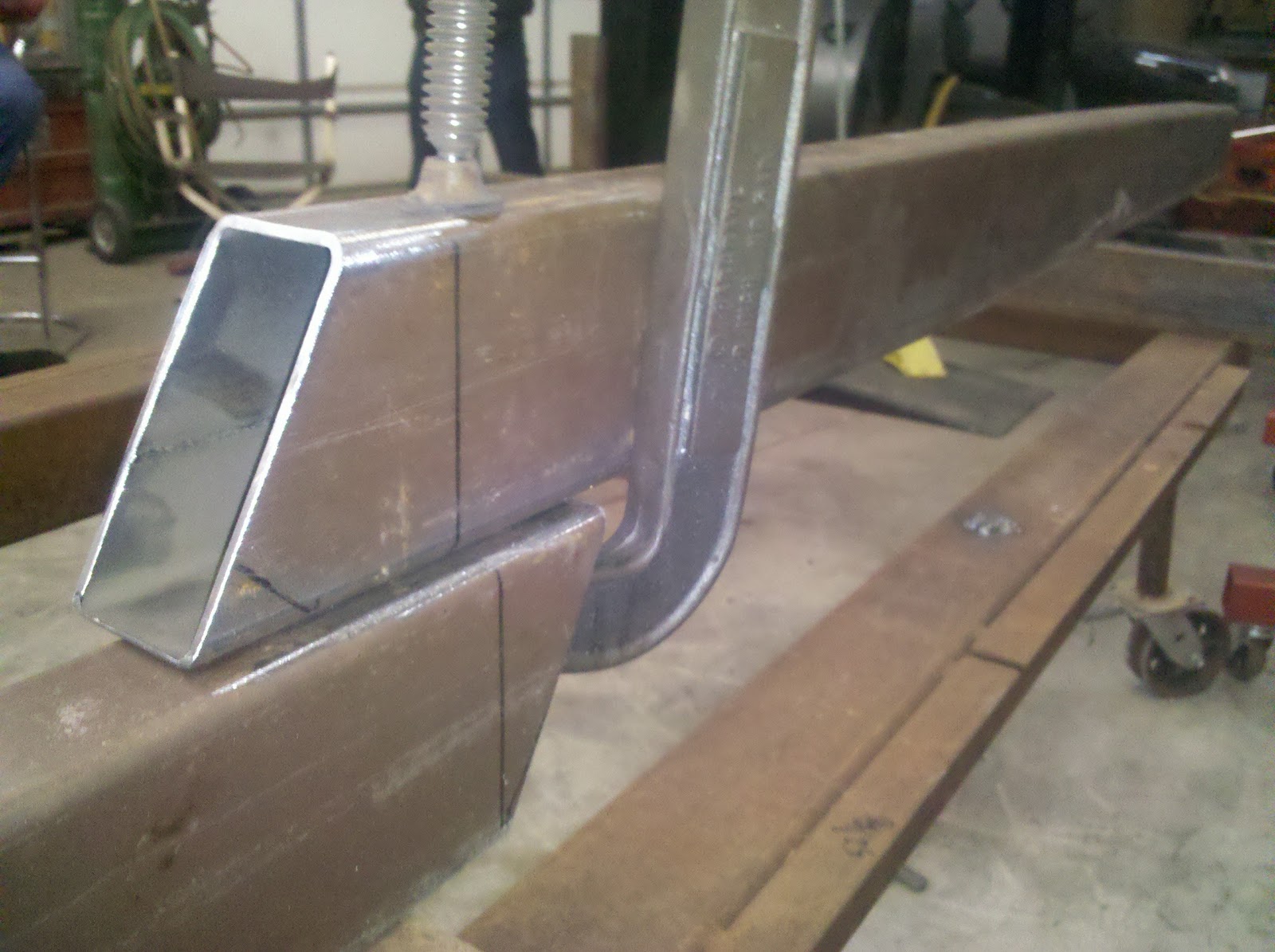

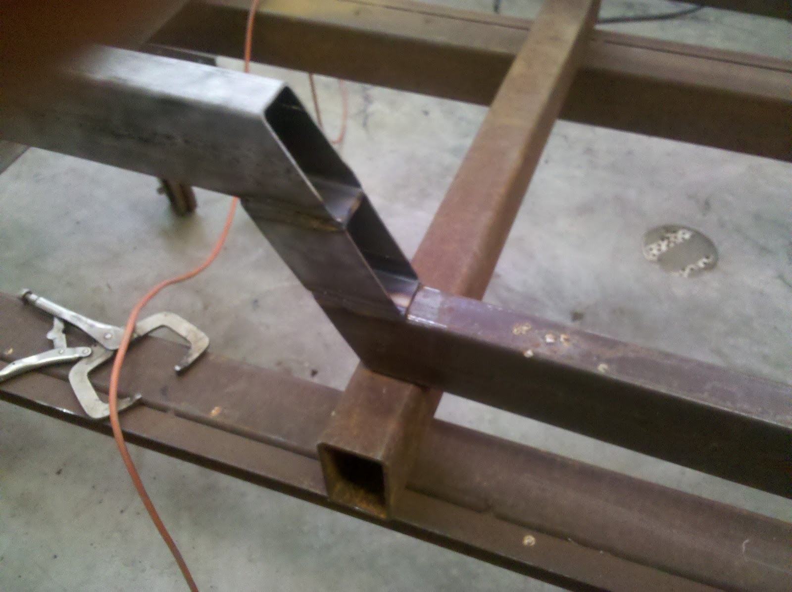

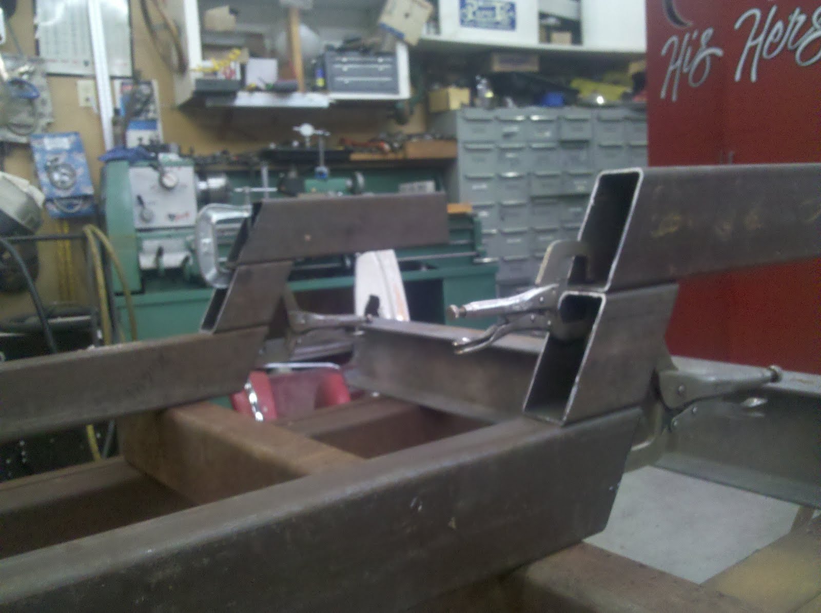

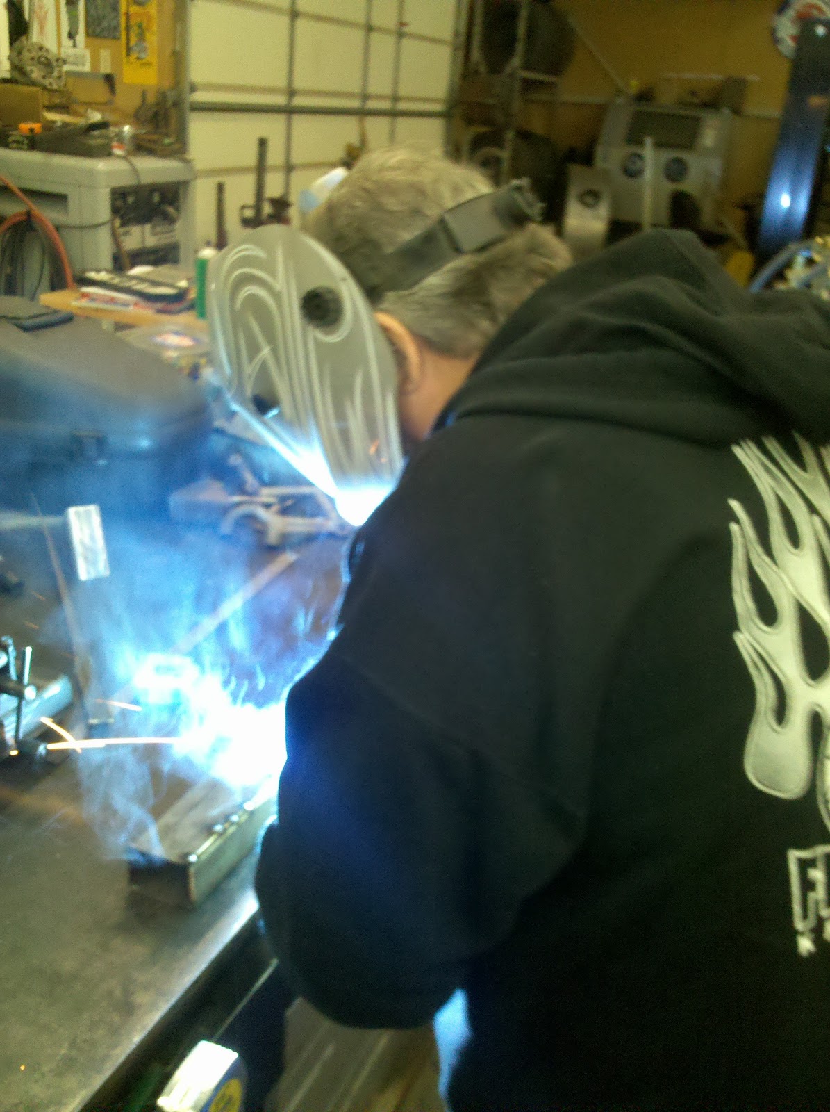

    This shows the pinch on the front frame horn tacked​
    unboxed rear kick up of 8"​
    front kick up of 4"​

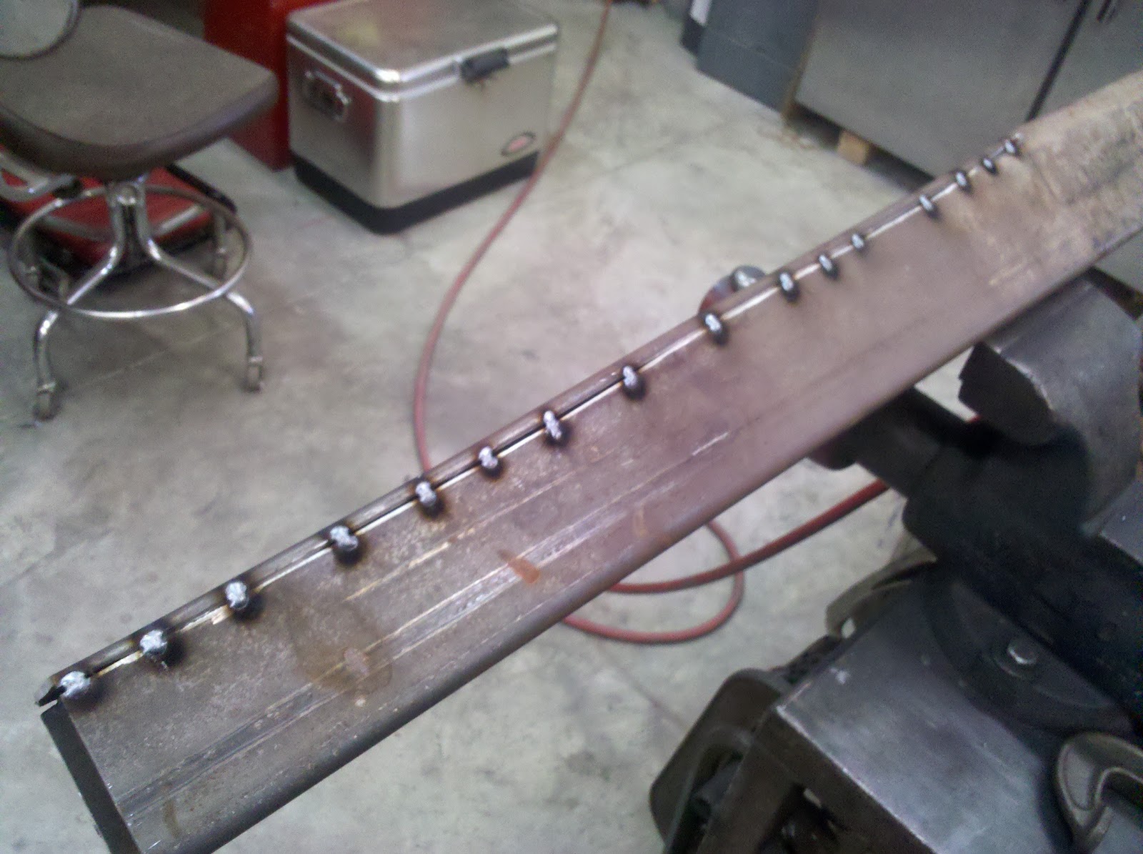

    union negotiated break?​
    Security patrol​

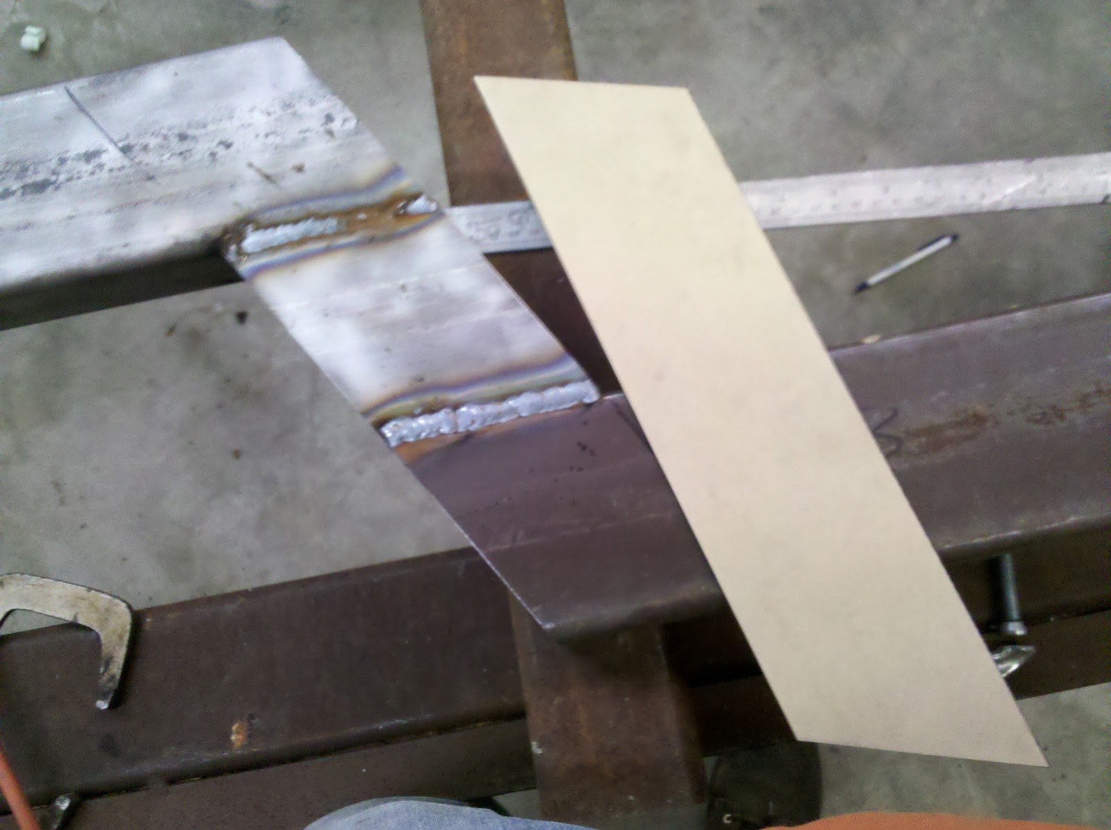

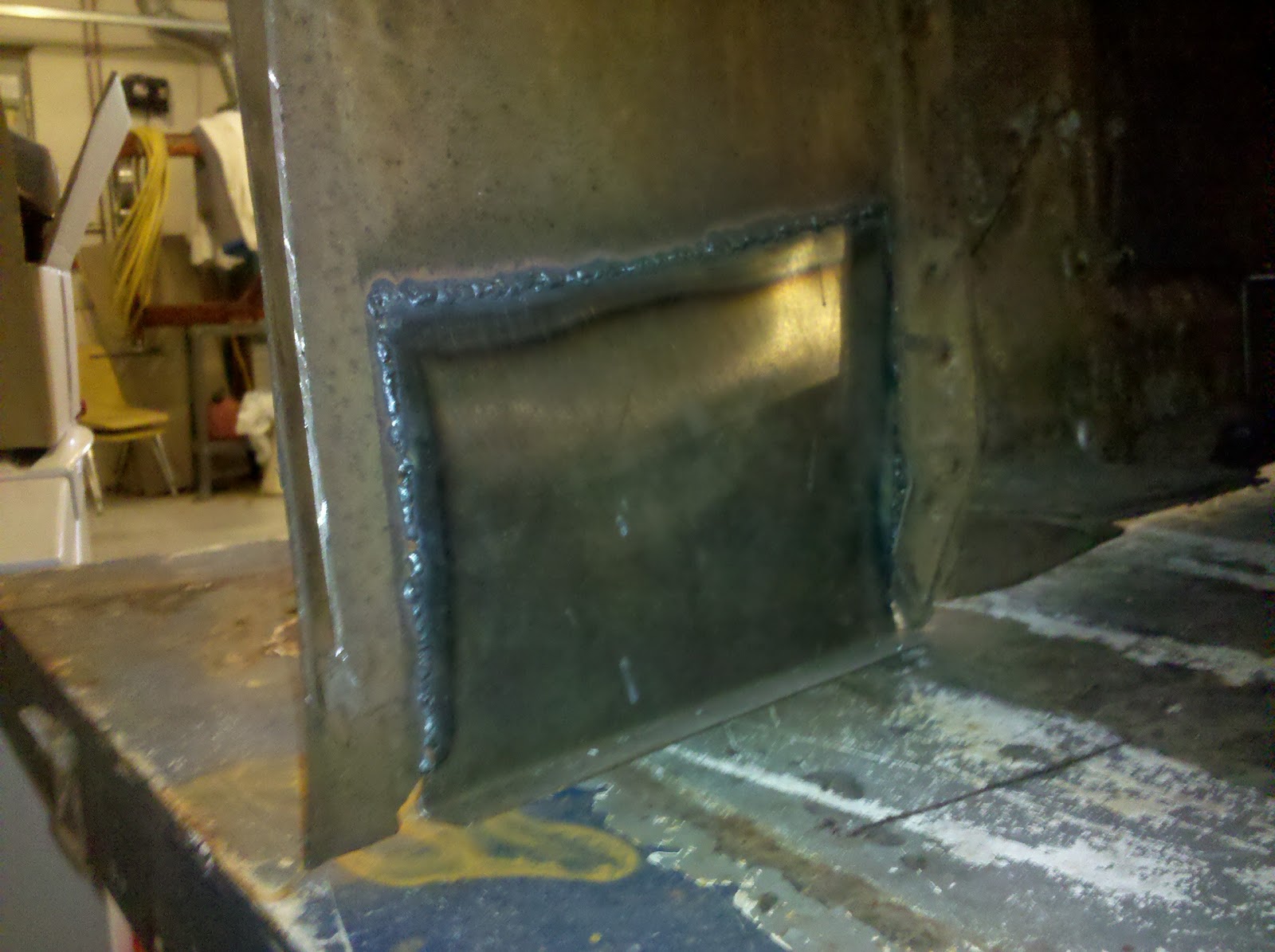

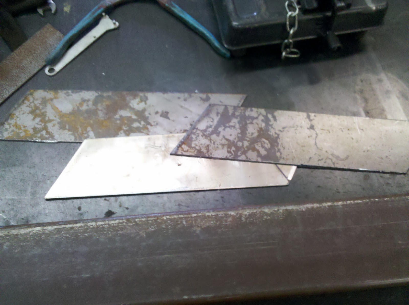

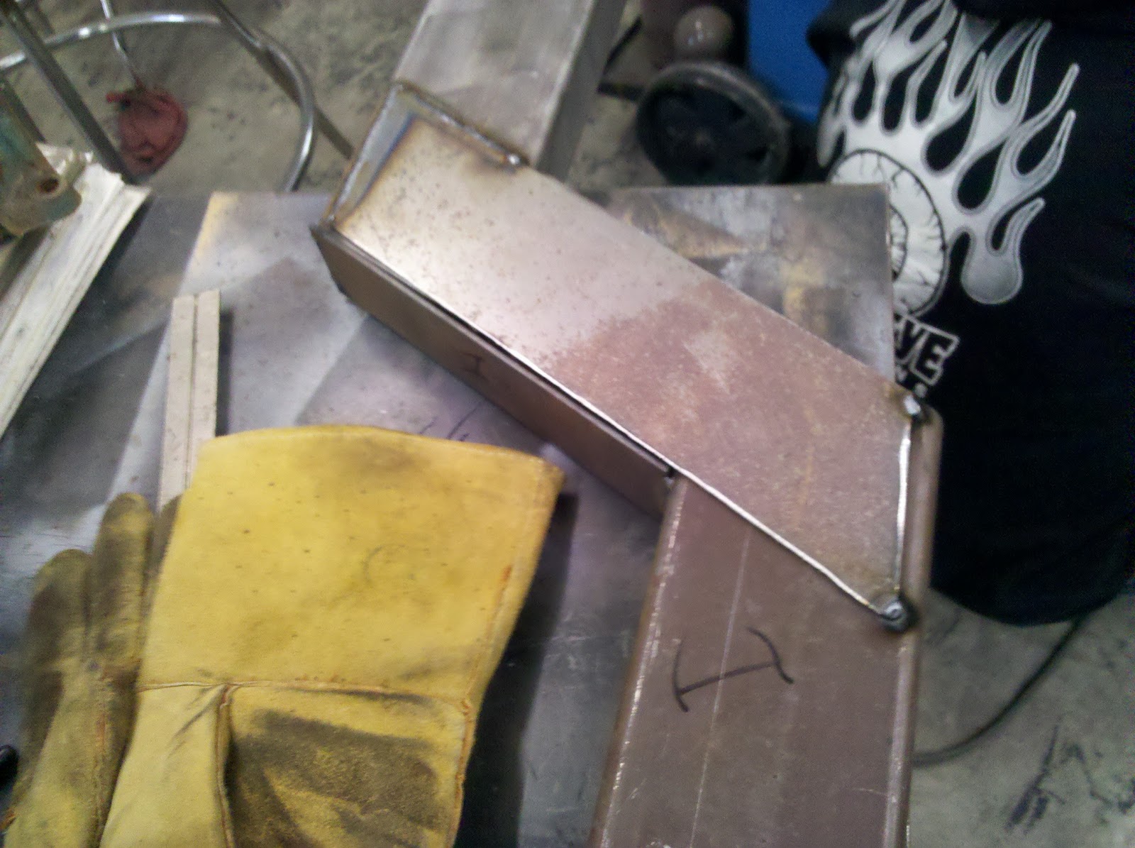

    cardboard template for rear kickup boxing​
    rear kick-up's all nice and boxed​

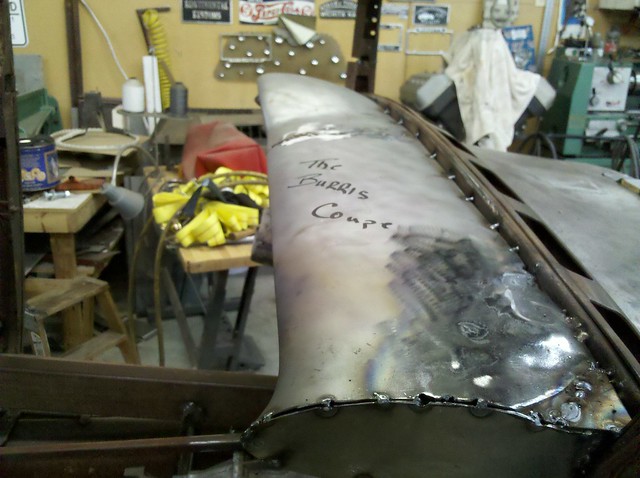

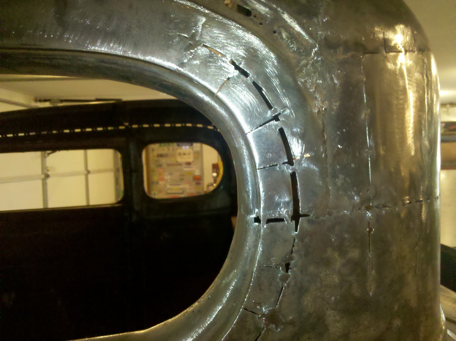

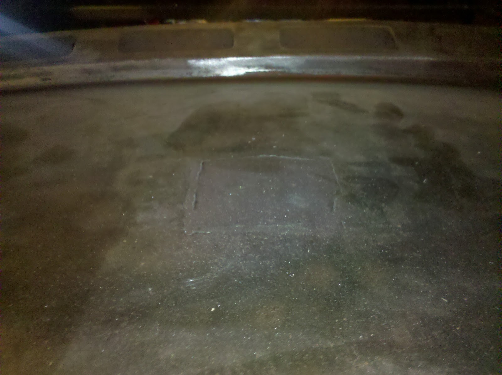

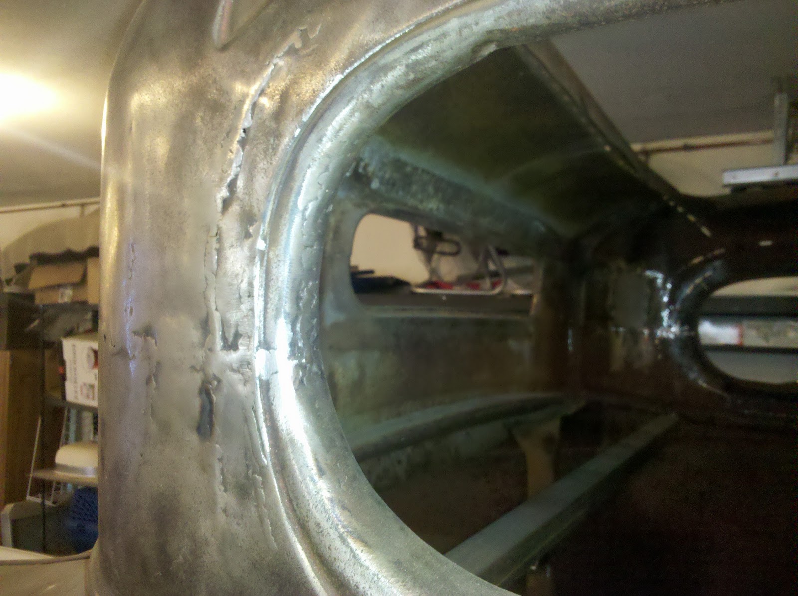

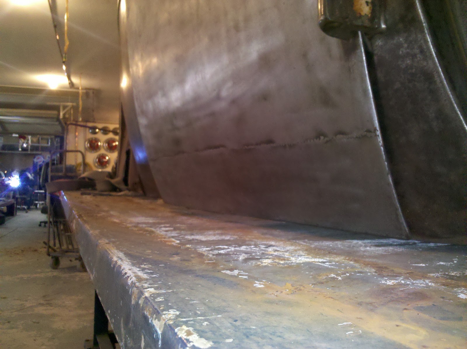

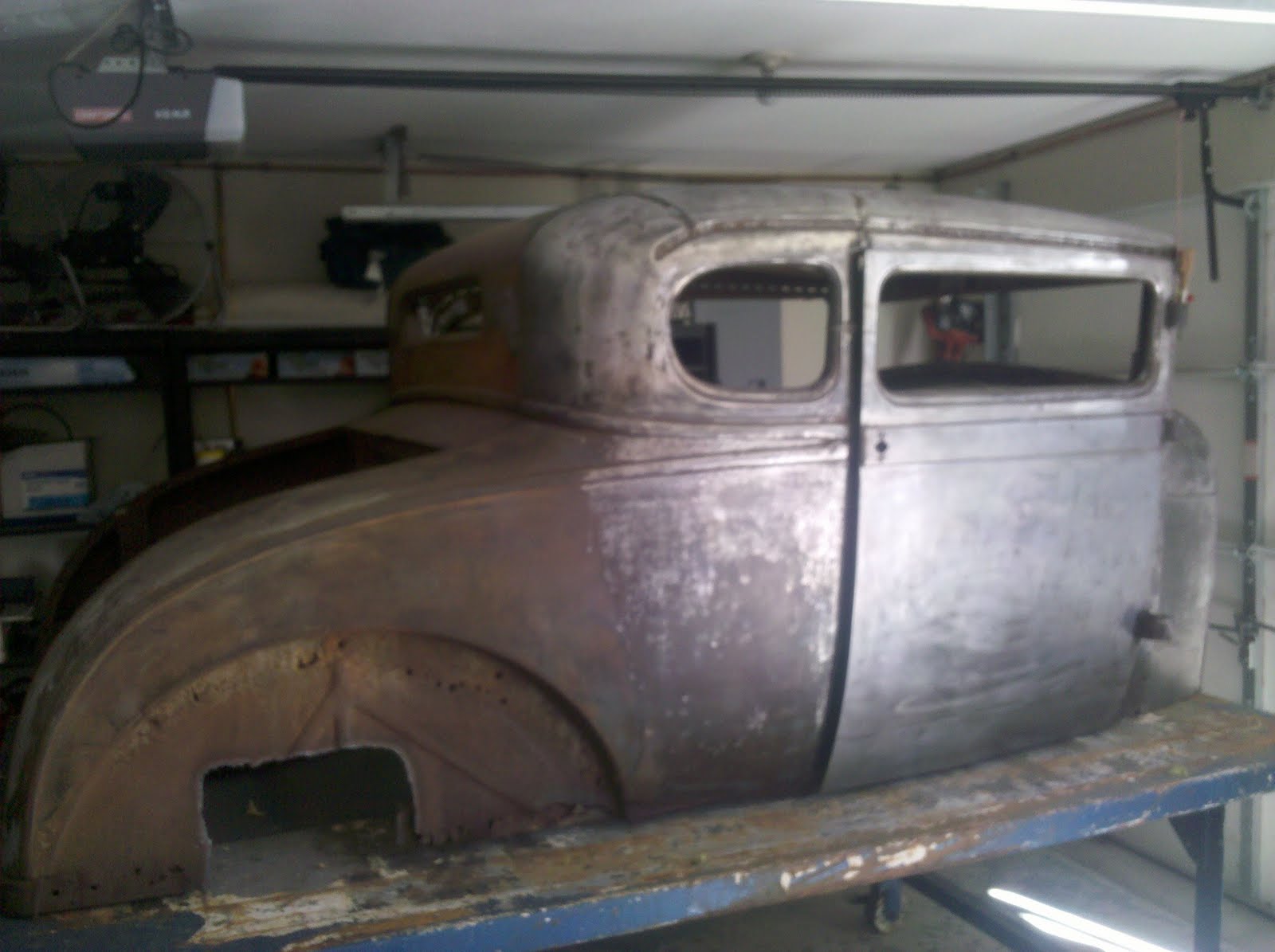

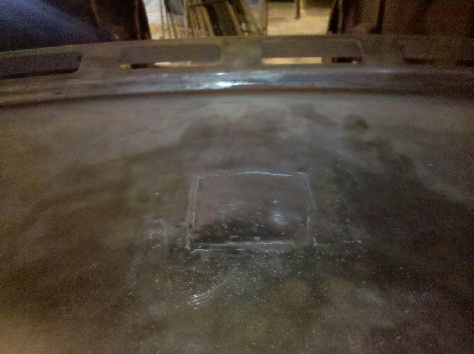

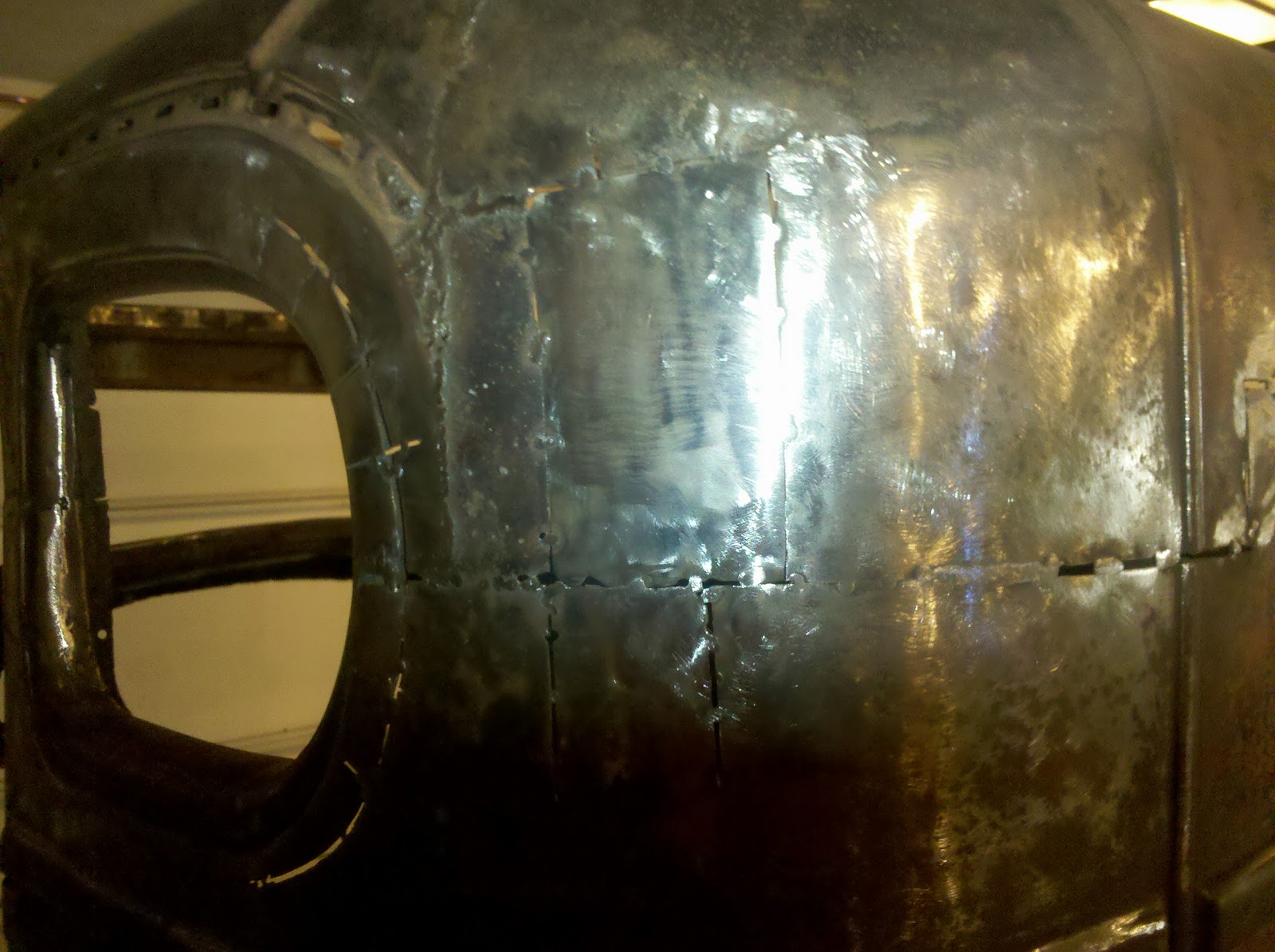

    I also took a bunch of pix of the body as it is right now. You can see I've done some patching here and there on the cowl and got most of the top welded up. I did most of this work last winter and sprayed it all down with Gibbs to keep the rust from coming back. Haven't done much of anything behind the doors yet. The driver's side door is still off the car and needs to have the lower 4" section patched but otherwise in pretty decent shape.​

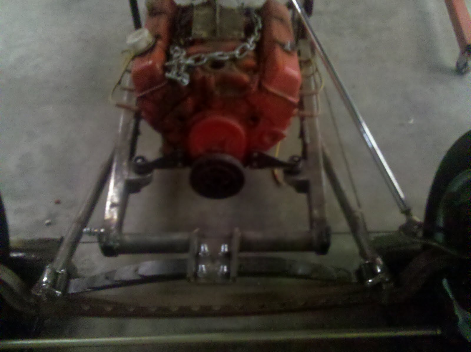

    We...well, dad... got a little bit done this week. He got the front cross member put in and one cross member in the rear installed. He also got the front end bolted up and the split wishbones welded to the frame. He tacked some mounts for the radiator just guessing on the height without having the body back on the frame.

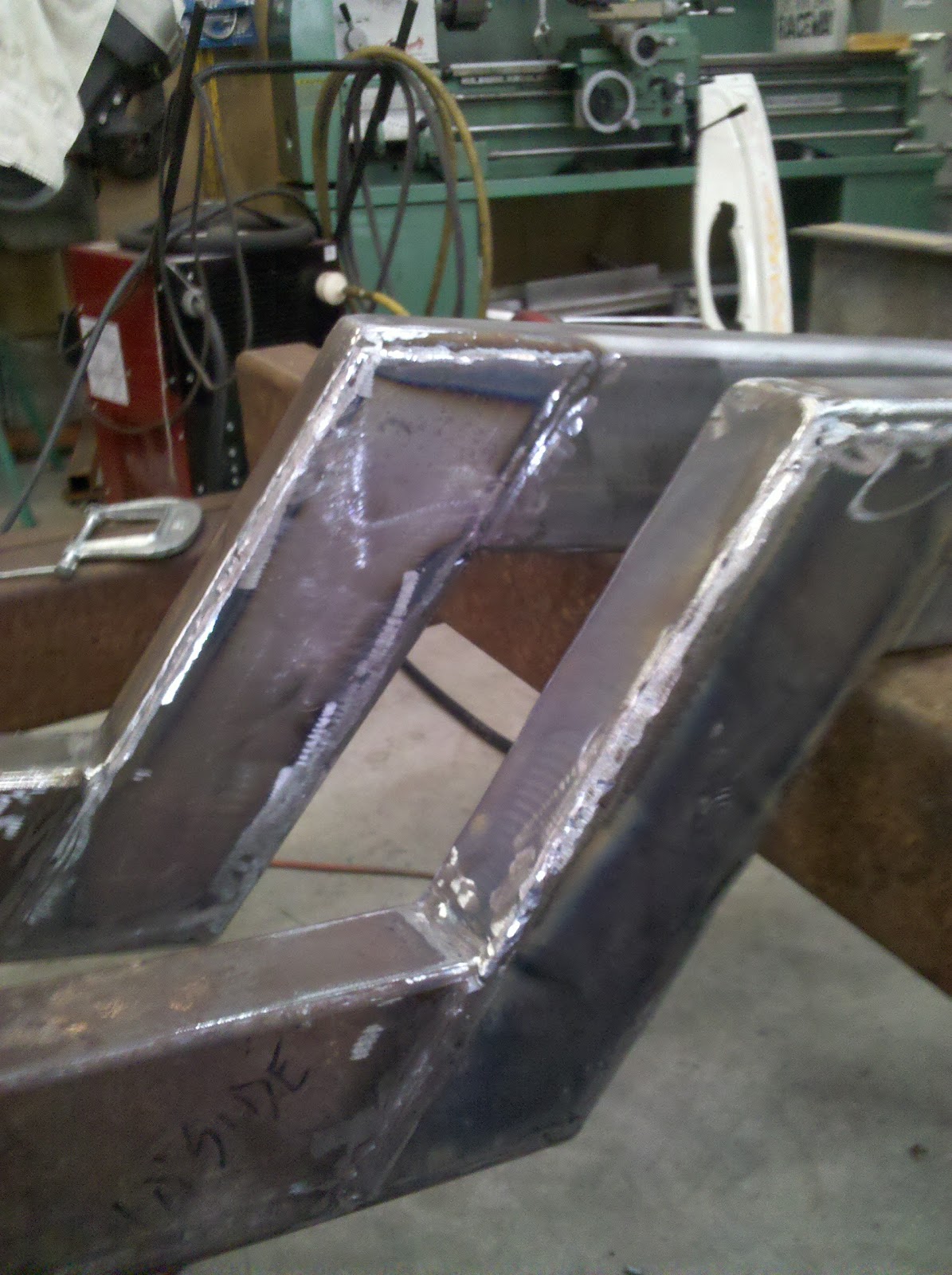

    I went down today and cut the plates for boxing the front Z but his wire feed welder kept jamming up so we didn't get any more welding done.
    A couple friends stopped in so while we had a few hands we decided to set the body back on the frame and see how things were coming together. We obviously need to lower the radiator smidge Oh well...minor details.
    Next up is getting the rear end back under the car. Instead of using the 32 cross member and model a transverse leaf sprint we're going to use coil springs.
    Then we can get the motor positioned and figure out our motor mounts and transmission cross member.

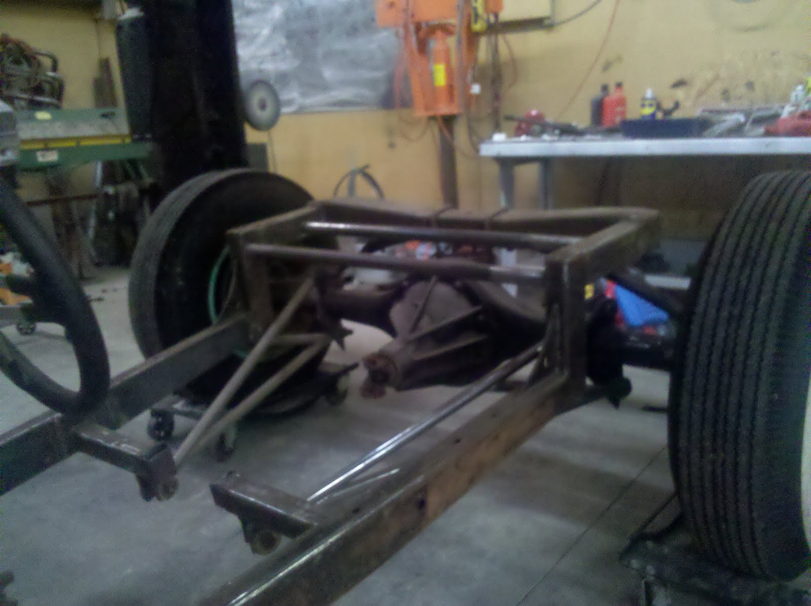

    we decided to go with the jag rearend
    Put some exhaust together
    And we just decided to go with the olds dash today.
    I'm hoping to get back down there tomorrow and get a few more things finished up on the suspension. We'd like to get it back down on the ground soon.

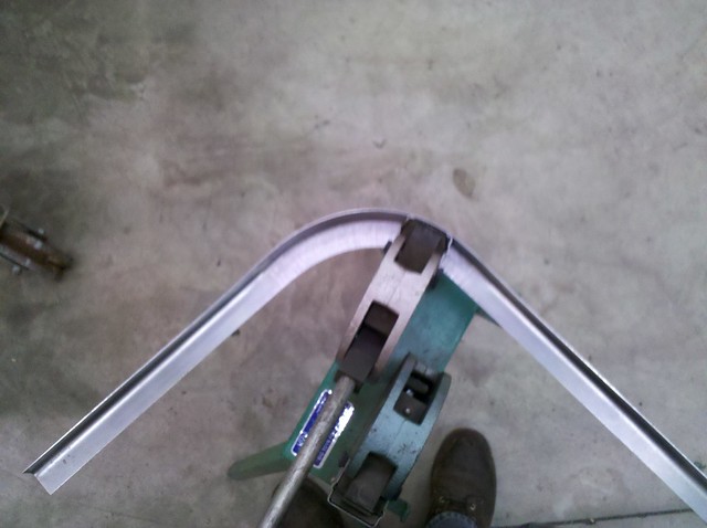

    Yesterday was more a shop cleanup and piddle around a bit. We both had evening plans so we didn't get a ton done. I did drag out the shrinker stretcher and built one of the radius for the whole in the top

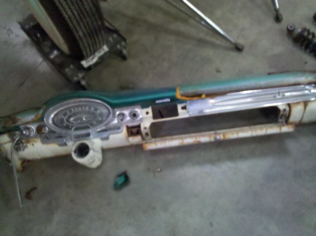

    He got a great start on the Olds dash too. Here he is making the first cuts.
    After cutting it down to size he was able to get it into the blast cabinet. I'm super happy with this...it's gonna be KOOL

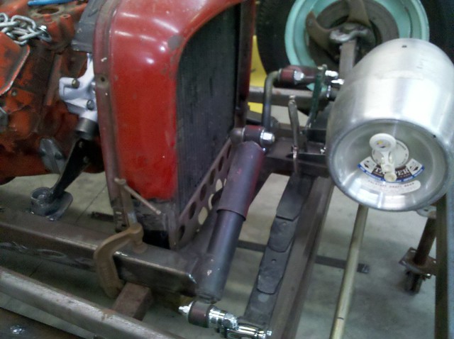

    Got a quick update. When i got down to Dad's on Sunday he'd already got the dash in. It's every bit as kool as i'd imagined. It's going to take some work to get is all smoothed out but you get the idea.
    He'd also pulled the trigger on the front shocks. Hub came up with this idea....I've not seen anyone do it this way...at first I wasn't completely sold on it but the more i stare at the more i like it. I can imagine it looking pretty sweet all dressed out it chrome.

  22. Car looks good so far, Except for the front shocks. I would rethink that setup entirely. It looks unworkable in my humble opinion. Looks like it will only move about an inch. You will feel every little hole in the road. The tank looks kinda like an afterthought as well. The car doesn't need it to be cool. Sometimes less is more. Take my opinion as you will. I am really nobody of any importance.

    farmer12
    This is one great build. Keep up the good work! (must agree on the front shocks though)

    I agree on the shocks too..

    Yea...I'm not 100% sure if they'll work aesthetically or functionally. Of course if it doesn't function properly then looks are of little concern but I'm willing to take the chance until I learn why it doesn't work. I've got mixed reviews about the front shock setup both online and off but nobody's told me why it won't work yet. Either way it can be easily changed if I do find that it rides like poo.
