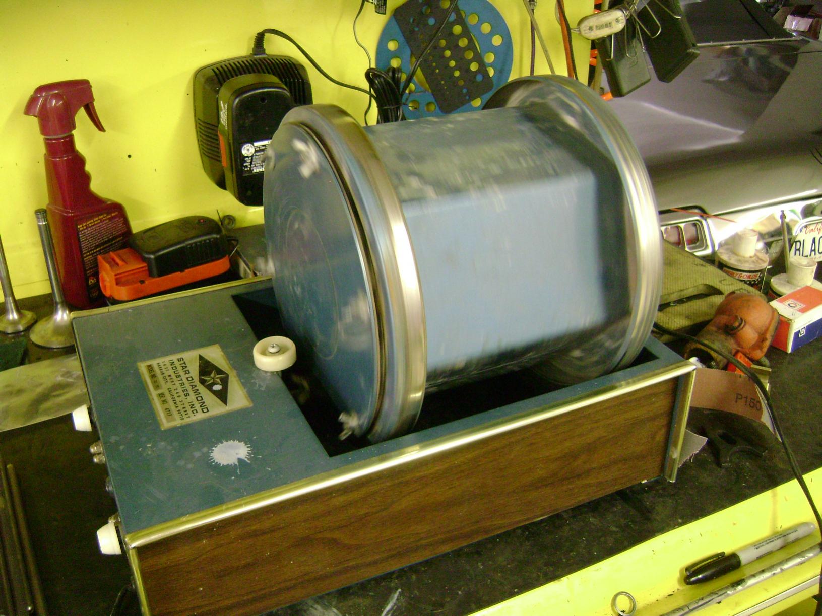

  26. I picked up a Thumbler tumbler at a yard sale and have used the green pyramids with a couple cups of CLR on rusty nuts and bolts. Also, "Black Magic" sandblaster media works pretty well.
  27. I saw some green pyramids on the HF site. Gonna look at em tomorrow. How big are your pieces and do they get the nooks/crannies pretty good? THX
