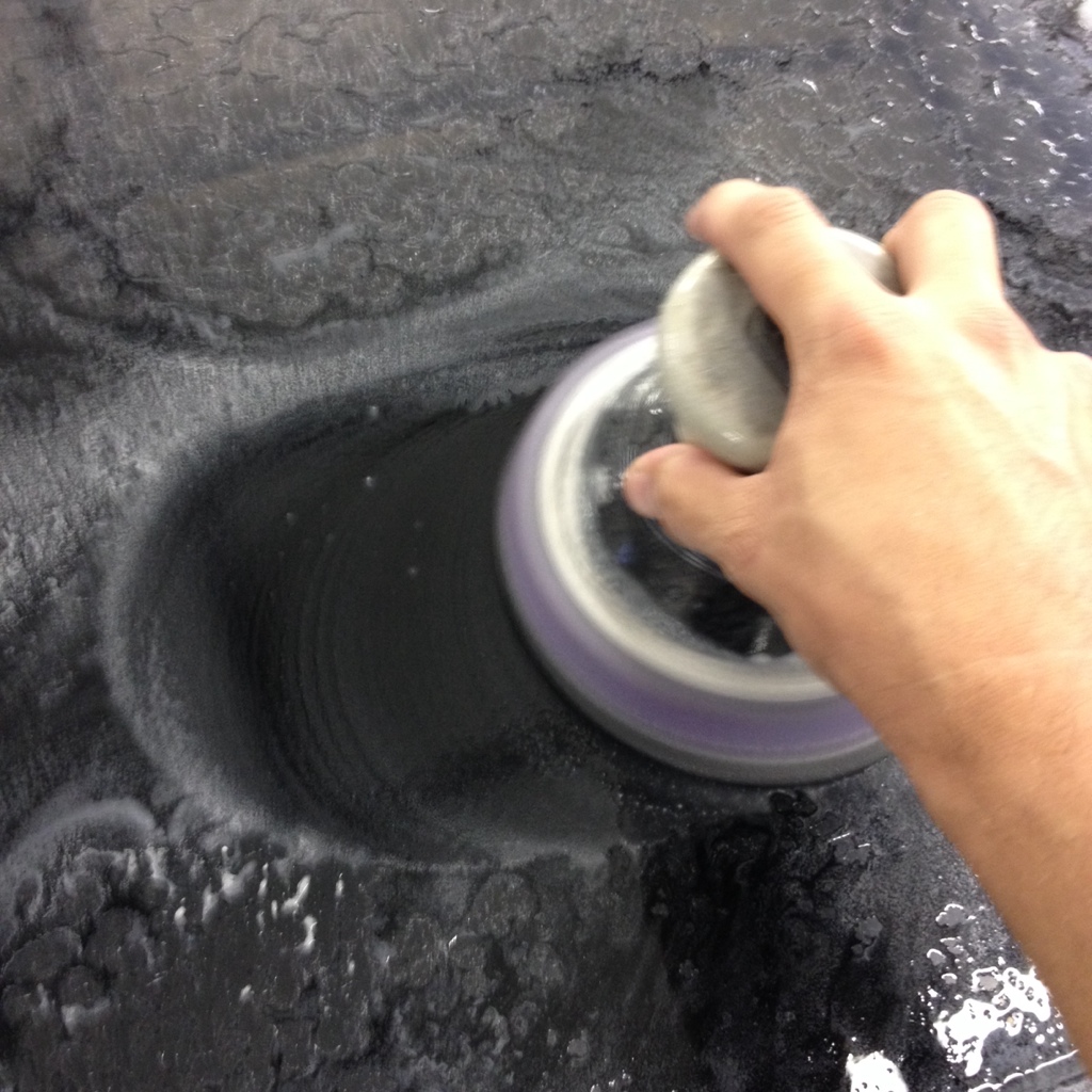

    Ok sorry for the delay but I finally have a few minutes to update my thread! So I haven't worked on my truck as much as I would like but after I started feeling better I hit the ground running trying to get caught up at work, business has been good so naturally I've been working on other cars rather than my own. So far I have got everything cut n buffed and currently reassembling the truck. I really wanted to document the color sanding and buffing portion but due to being so busy I didn't take a lot of pictures. If you have any questions about buffing feel free to ask.
  6. rob bob
    Joined: Aug 18, 2011
    Posts: 446
    rob bob
    from Canyon TX

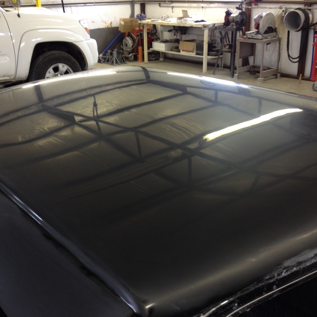

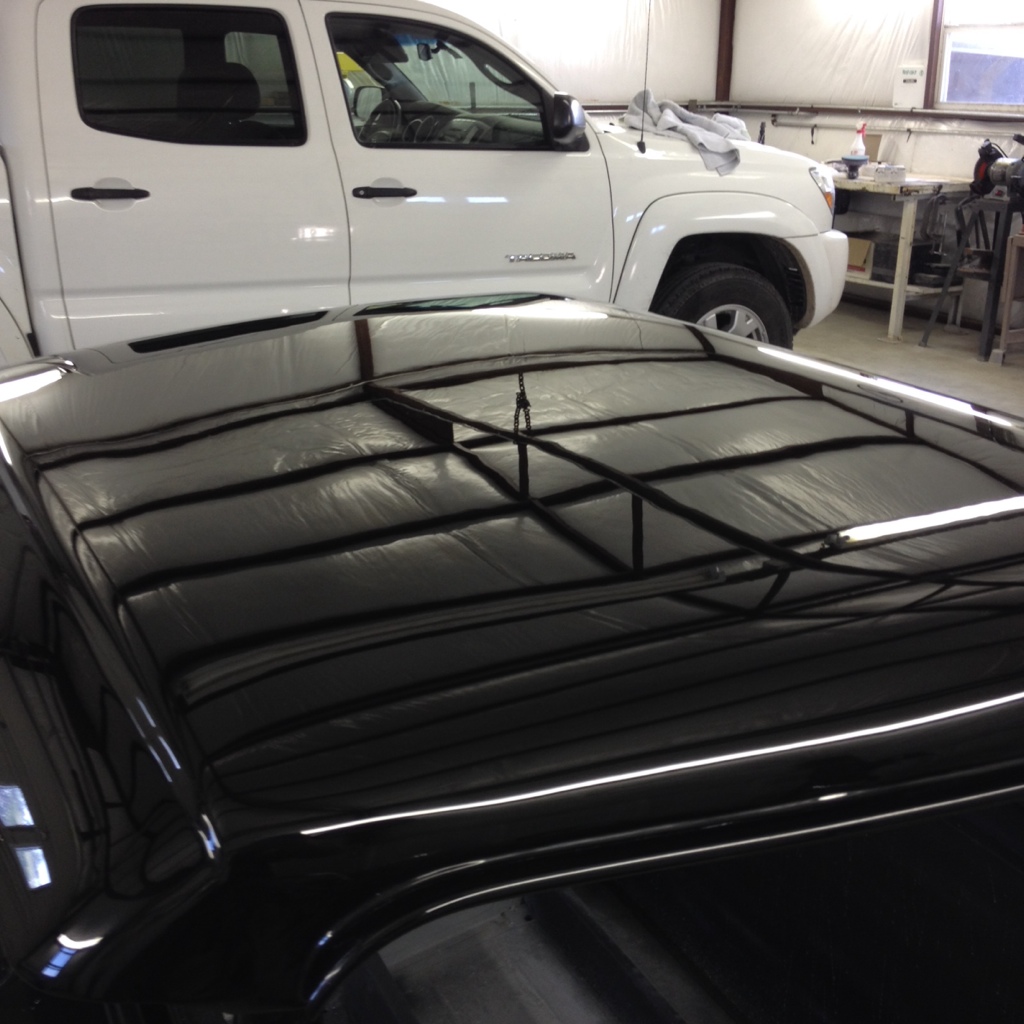

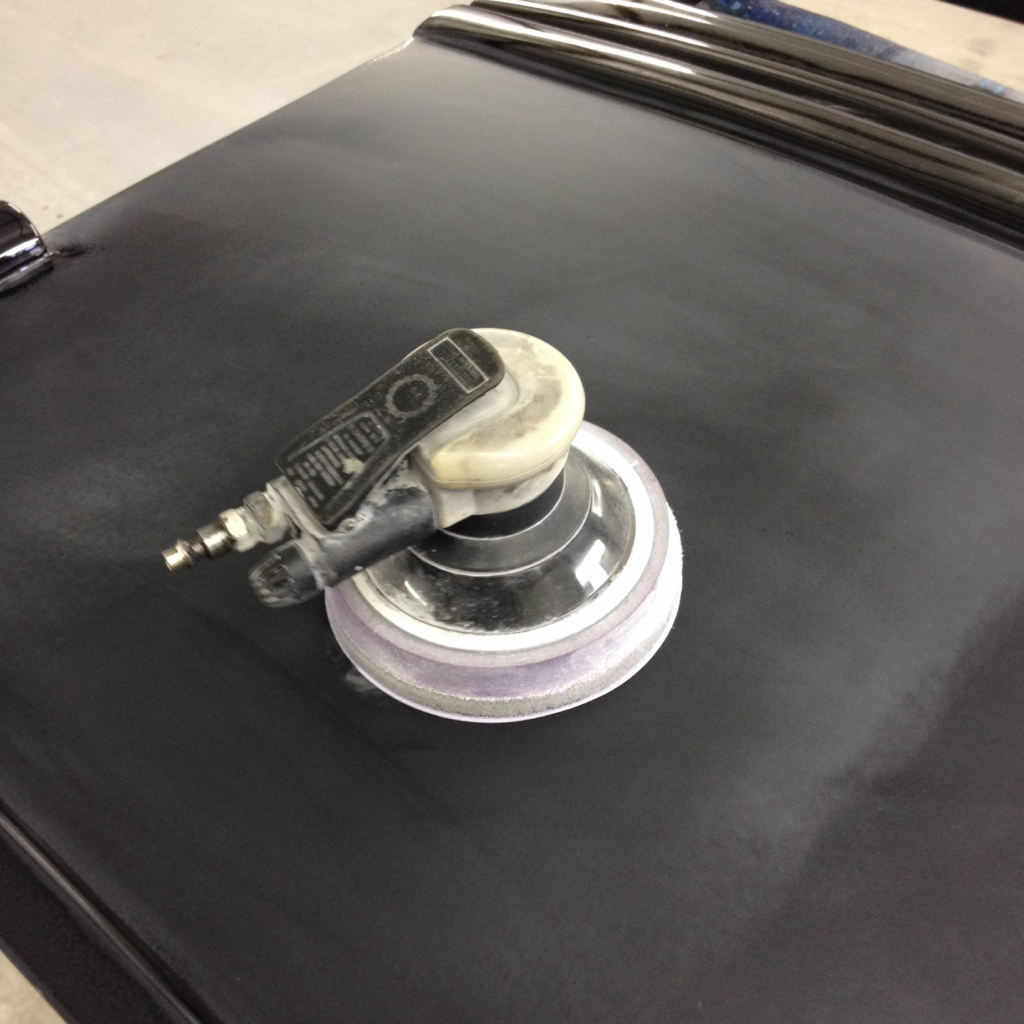

    So buffing to me is a big equalizer if you know how to cut and buff you can make shit paint jobs with cheap clear look pretty good, I always thought to myself I'm not a good painter I'm just a good buffer. Just a quick run down of the process I start with 1200 grit cut the orange peel down either with a block or DA in this case I used a DA first then a block. After that I use 3M Trizac 3000 grit on the DA on black I like to take it one step further an use 5000 after the 3000. ImageUploadedByH.A.M.B.1472001107.436196.jpg ImageUploadedByH.A.M.B.1472001148.667103.jpg ImageUploadedByH.A.M.B.1472001196.990757.jpg Now with the 3000 on the DA ImageUploadedByH.A.M.B.1472001249.433521.jpg After the 3000 you'll start to notice the shine coming back. ImageUploadedByH.A.M.B.1472001376.181717.jpg Now after 5000 ImageUploadedByH.A.M.B.1472001417.452535.jpg ImageUploadedByH.A.M.B.1472001467.063934.jpg

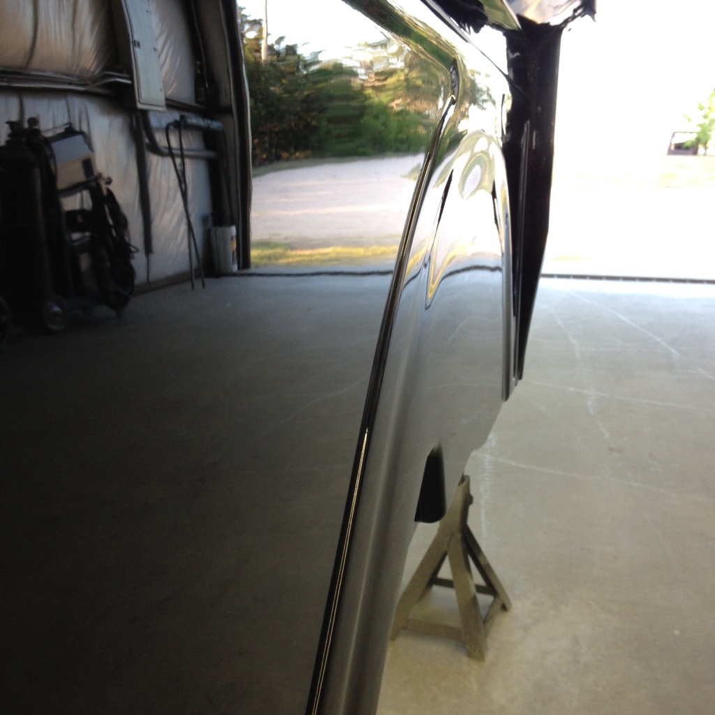

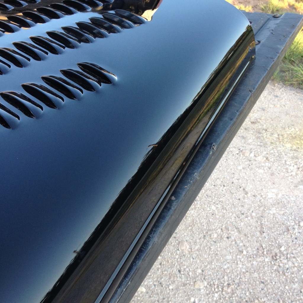

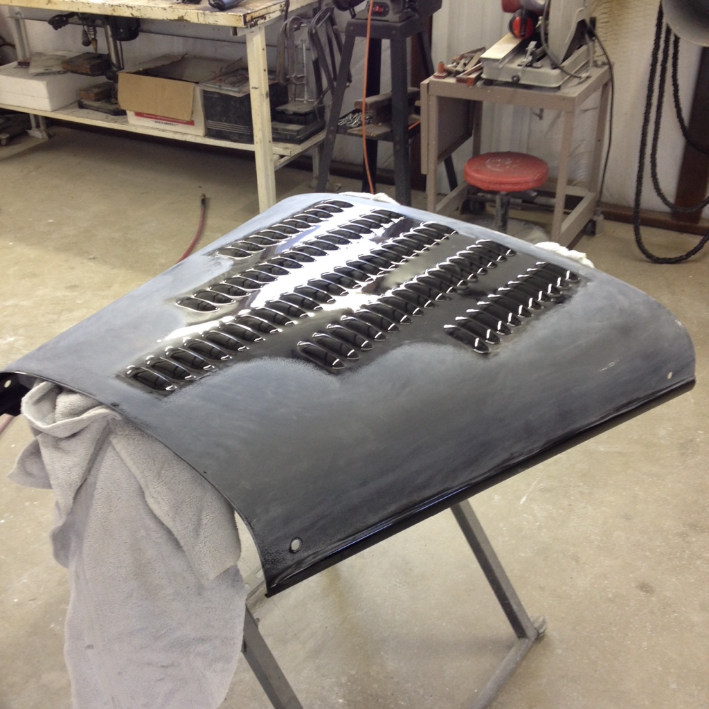

    I didn't get any pictures of the buffing stage but I use all 3M products with the exception of Wizards cutting compound. With buffing you have 3-4 stages
    Step 1 : cutting compound with a wool pad or cutting foam pad.
    Step 2: black compound with black foam pad.
    Step 3: blue finishing compound/ machine glaze wit blue pad.
    Step 4 (for black or darker colors) swirl/ hologram remover.
    Here are a few pictures after buffing.
    ImageUploadedByH.A.M.B.1472002443.661707.jpg ImageUploadedByH.A.M.B.1472002489.025251.jpg ImageUploadedByH.A.M.B.1472002524.855048.jpg ImageUploadedByH.A.M.B.1472002548.832698.jpg ImageUploadedByH.A.M.B.1472002587.581921.jpg ImageUploadedByH.A.M.B.1472002608.185894.jpg ImageUploadedByH.A.M.B.1472002646.043014.jpg ImageUploadedByH.A.M.B.1472002671.841656.jpg ImageUploadedByH.A.M.B.1472002711.063026.jpg ImageUploadedByH.A.M.B.1472002740.225250.jpg

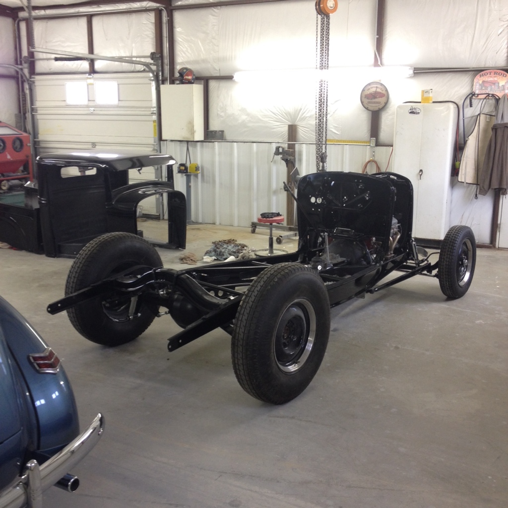

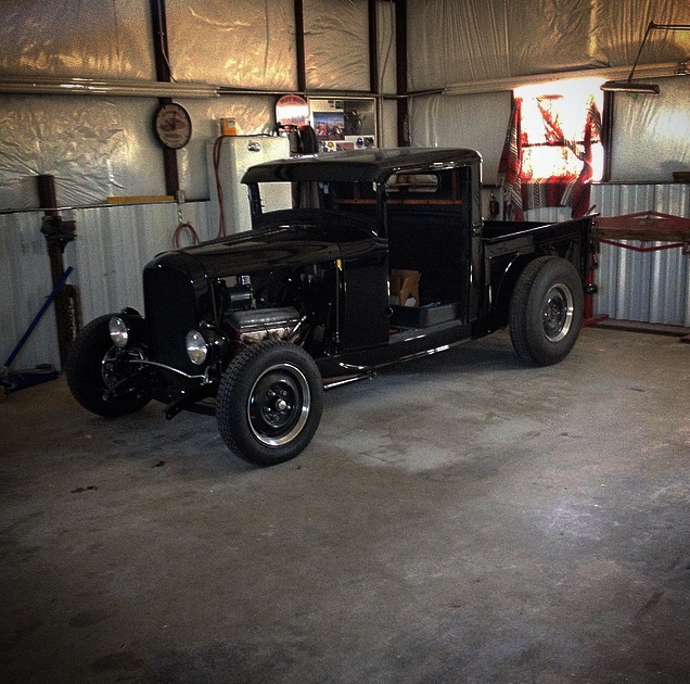

    Just a little update to keep everyone on the edge of your seat. It's starting to come together nicely! ImageUploadedByH.A.M.B.1475458409.276233.jpg

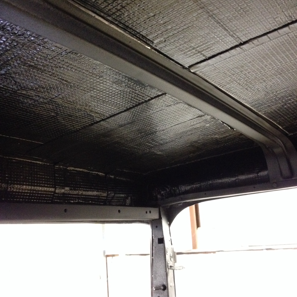

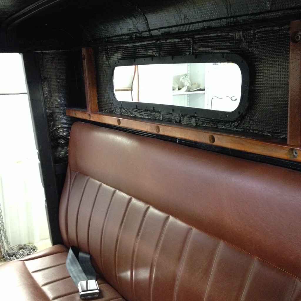

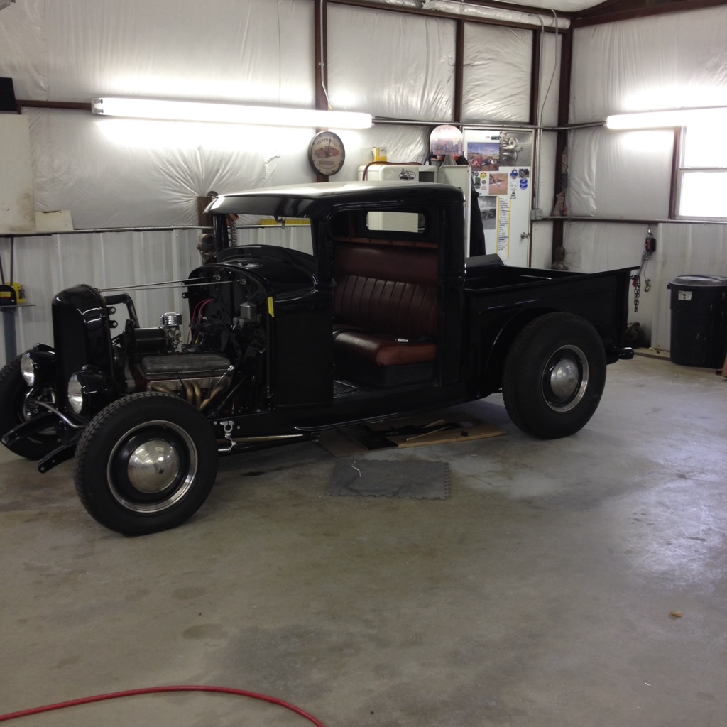

    Nothing crazy just a little update slowly getting everything back together. I got all the sound deadener installed in the cab everything is tight and insulated well, seats back in and most of the wiring is done. Just a few more little things to finish up and it's off for glass and a full interior. ImageUploadedByH.A.M.B.1478383657.429437.jpg ImageUploadedByH.A.M.B.1478383772.819971.jpg ImageUploadedByH.A.M.B.1478383797.311150.jpg

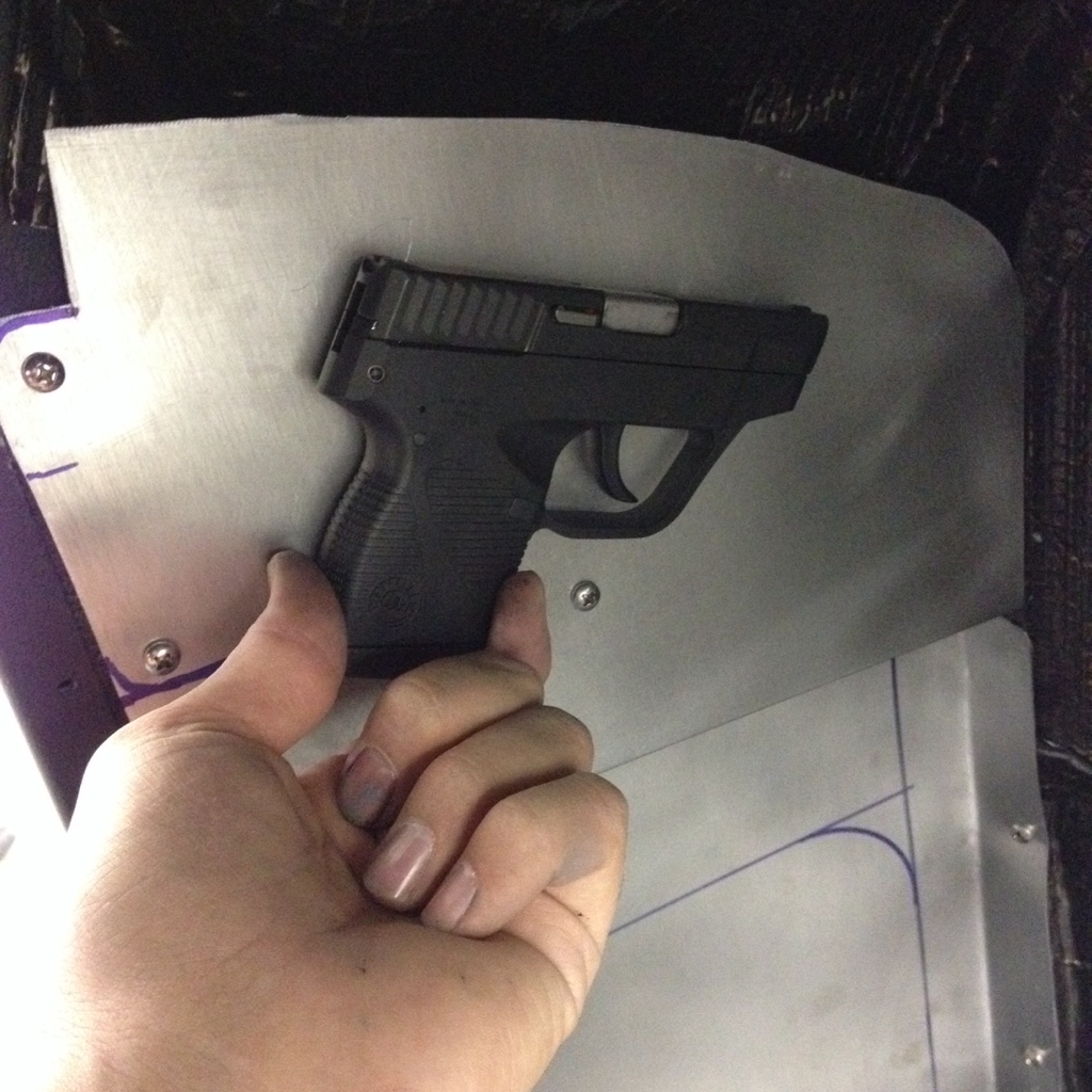

    One of the thing I wanted on the interior was aluminum kick panels with a tan diamond stitch insert (the same color as the seat) as many of you 32-34 truck owners on the hamb may already know there's not much foot room in these trucks. The way I made the kick panel on the drivers side maximizes room and allowed me to still have the accent of raw metal in the cab. ImageUploadedByH.A.M.B.1478384404.959302.jpg ImageUploadedByH.A.M.B.1478384436.475357.jpg I'm also working out a way to mount my anti-theft device. ImageUploadedByH.A.M.B.1478384537.444116.jpg

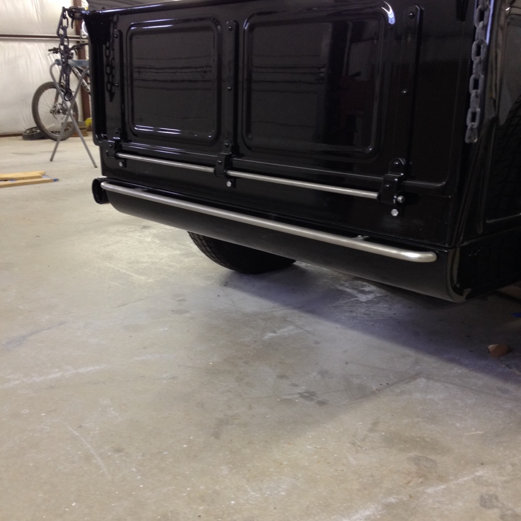

    I've got the tank mounted, tailgate back on and nerf bar in place I really love the flat finish of the stainless in contrast to the black gives it a cool old hot rod feel. ImageUploadedByH.A.M.B.1478385066.015059.jpg Lastly I have been experimenting with the wheel treatment and I like the look of just the centers so far but that could change. ImageUploadedByH.A.M.B.1478385263.611368.jpg ImageUploadedByH.A.M.B.1478385304.699468.jpg ImageUploadedByH.A.M.B.1478385339.585954.jpg View attachment 3370414
