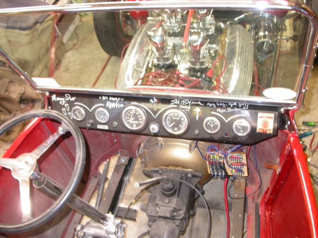

    Your build deserves a vintage steering box. If you could find a Ross like I put in my roadster I think it would work for you. SANY0001.jpg DSCN4024.jpg

    Mustang years to use.....see this pic. Use the short shaft.

    If that's your car above, don't use a mustang box. Go with a 37-48 Ford box. Flip it 90 deg. And build a bracket or even weld on a flange similar to an F1 box.
