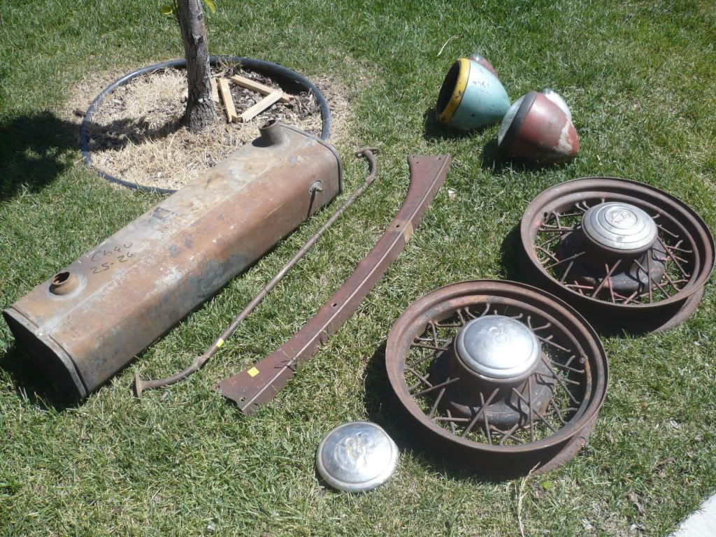

    Haven't been able to work on the truck lately but I just got back from the Spokane swapmeet and I picked up a bunch of good stuff.
    A couple of Guide (682?) headlights with the running lights on top. I was walking around with them for a while and had a couple people stop to talk to me about them.
    The guy that I bought the headlights from also threw in a shift nob with the deal.
    28/29 grill shell. The bottom is a bit rough but I only paid $20 for it so I couldn't pass it up.
    A Chevy gas tank that I think I will put in the bed right behind the cab. I'd like to find a mechanical gauge to go in the opening on the left so I don't have to mess with an electric sending unit and another gauge on the dash.
    I also bought two 17" Kelsey Hayes wires, three V8 hubcaps to complete my set, a Model A headlight bar and dash molding. That's the first time I've been to the Spokane swapmeet, and it was definitely worth the drive from Pullman and the weather couldn't have been better.

    Nice build you have going. The AA rails added to the front of the frame is a good idea. That Chev tank will look good. Talked to you about the gas reserve valve at the swapmeet.

    Yes! Thanks for the advice. I might hit you up for more details on the reserve valve when I get down to installing the tank and running fuel lines. I've seen your car around before, good finally to put a face with the car!
