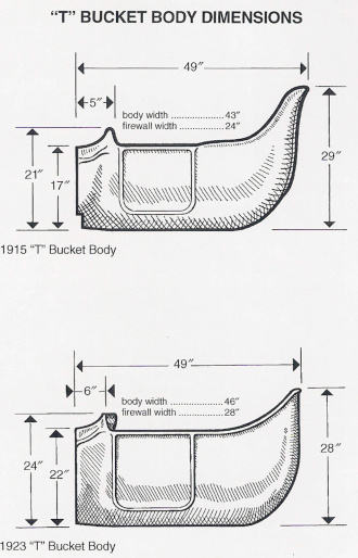

    I am curious how wide the rear of the cab on a roadster pickup is? I am starting with a t bucket body. To make my RPU,and thinking of widening it a little . any thoughts?

    You may have to give more information, to get a response. If you're talking about a 1923 Ford, a T bucket body actually is the same as a roadster pickup.
  3. If you mean a Model A, '28/'29 or '30/'31?
    Best I can do

    My t bucket body is a 1923, so it looks like I would only gain an 1" at the firewall , and 3" in the rest of the body not sure that it would be worth messing with cutting it down the middle and having to do all that fiberglas work!
