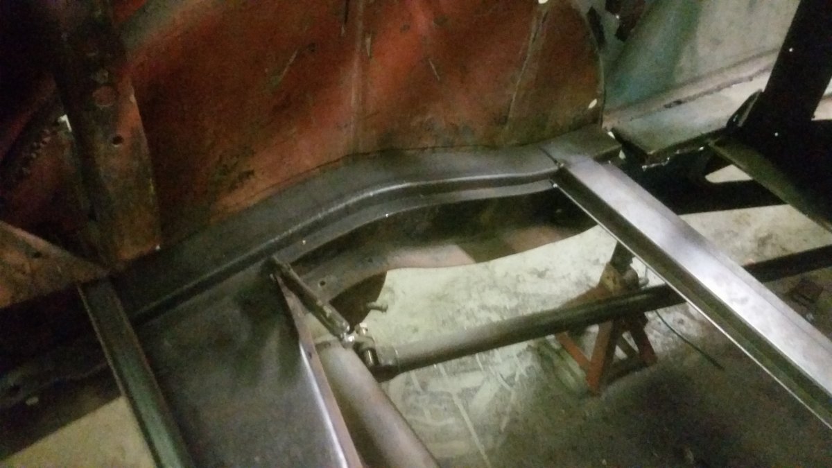

    started to fit the rails I made
    next three pics are of how fucked my body is. over an inch out at the a pillar and the same at B . cowl post is flush to frame on pass side. and hanging over 2" on drivers. most of the problem is in the cowl and it is welded together . fun fun
    ill be rebuilding the whole thing I guess. stay tuned for subrails from scratch

  8. Atwater Mike
    Joined: May 31, 2002
    Posts: 11,624
    Atwater Mike
    Great build, found it only today! Definitely reminds me of around here...my project is a '27 T touring, like the one pictured next to your frame a few pages back...
    Very intrigued with your sub frame channels, and the bends to follow the '32 'kick ups'.
    Best channels I've seen, please mention how you bent them. (Rolled?)
    Thanks

  9. bct
    Joined: Apr 4, 2005
    Posts: 3,154
    bct
    Thanks,.Just sheer force and a common pipe die . Flange got a bit rippled but hammered out straight. Could have shrunk it wit a torch (or tried too) but it didn't come to that.

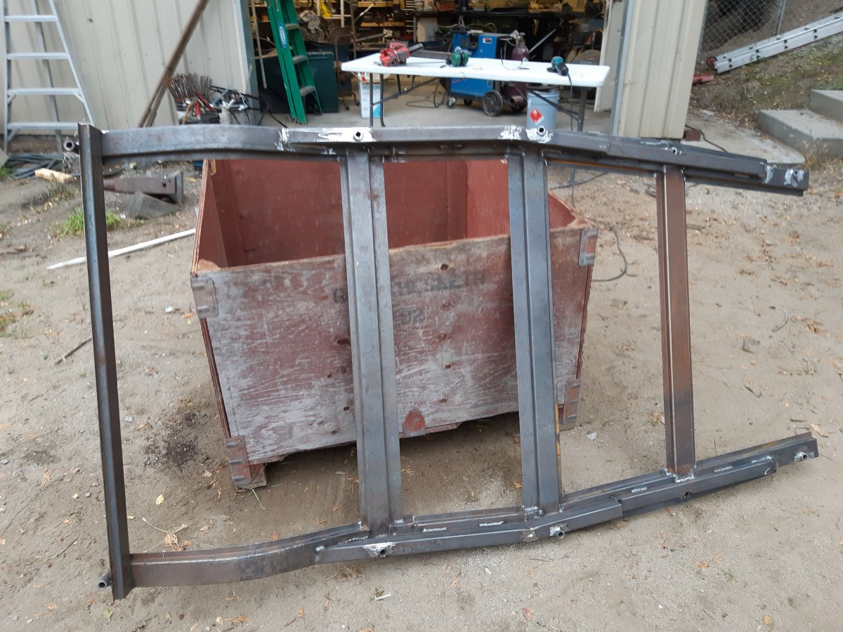

    Headway on my sub rails. It is a fun project and I'm lucky to have a square frame.

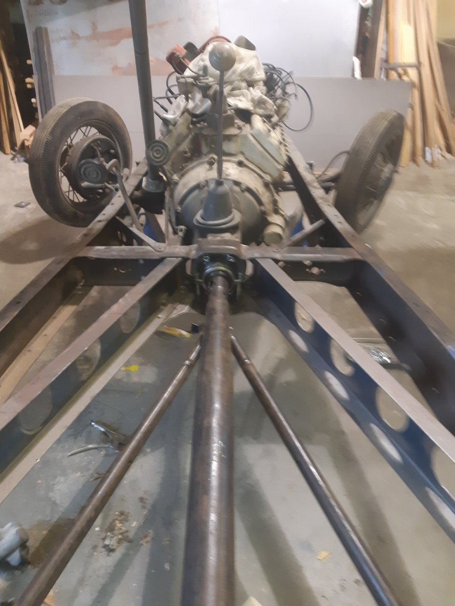

    20191016_150101.jpg 20191016_165009.jpg 20191016_165054.jpg 20191016_150101.jpg
    Finally some slight progress.

    bct
    Hoping for a hollow drive shaft

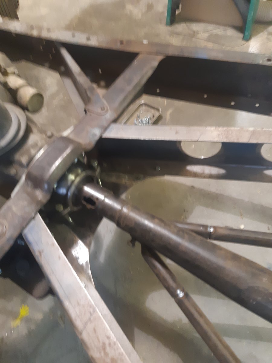

    bct
    Torque tube is ready to weld.

    20200106_113431.jpg 20200106_133954.jpg 20200106_134012.jpg 20200106_134026.jpg 20200106_134037.jpg
    Got my tt welded and bones shortened. Moved the mount to the tapered area I hope its happy there. Sleved the joints in my bones and will need to repair one split seam.
    Anyone got tips on how to reproduce the odd weld beads on the bottom of wishbones?
    chryslerfan55 and RICH B like this.
  25. bct
    Joined: Apr 4, 2005
    Posts: 3,154
    bct
    Fyi 17 inches exactly came out of the torque tube and about 6 for the wishbones. I did not have to adjust the angles at the mount bolt but it is slightly tweaked. I'm going to add some heat to them when I tighten it up tight
