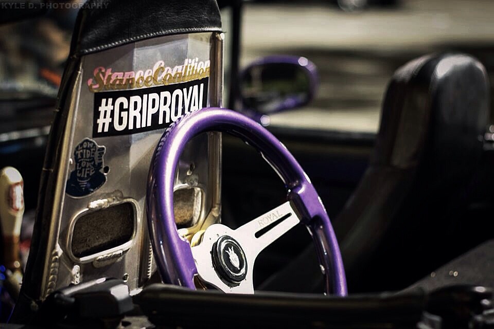

    My best input here would to purchase kirkey aluminum racing seat, drill and rivet at your leisure. To do this you'd have to do the rivets from inside the seat so you don't get stabbed by the part that bulges out. Here's a picture of my seat in my race car, for an idea. ImageUploadedByH.A.M.B.1393394547.739201.jpg
