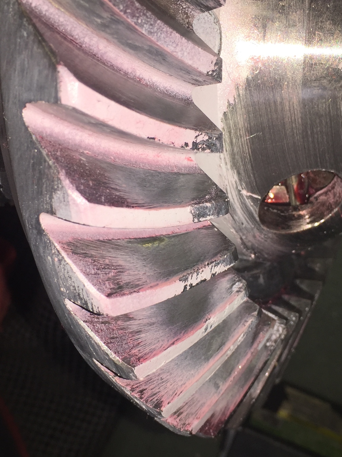

    Opinions on my pattern please fellas?! Just set up this ford 9"
    Thank you in advanced

    First of all, check the backlash of the gear (hold the pinion still & shake the gear) to make sure it's within specs. Probably around .008" - .012", but check to see what it should be, according to the manufacturer. If it's not, set to the correct backlash and try it again.
    If the backlash is OK, then the pinion is too close to the ring gear. Change the shim .003" to .005" to move it away from the gear, reset your backlash and try it again and see what it looks like. The contact on the drive side of the gear should be a little off the toe of the tooth and centered more on the tooth between the top & root of the gear tooth.

    Thanks tagman, I will double check my backlash but I believe it was .009. If it is within spec I'll change my shims and get some better marking compound tomorrow and give you an update

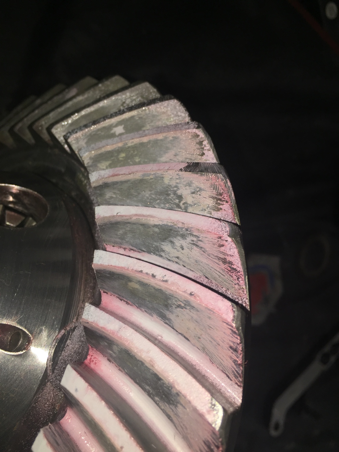

    My backlash was correct, so I change the shims as you suggested. I'm hoping to have some better marking compound delivered today. This time around I tightened my backlash a bit.

    Coast side doesn't look bad, but hard to tell on the drive side. How are you exerting a load on the gear as you turn the pinion? You can't really duplicate the "as driven" load, but you should put a good drag on the gear.

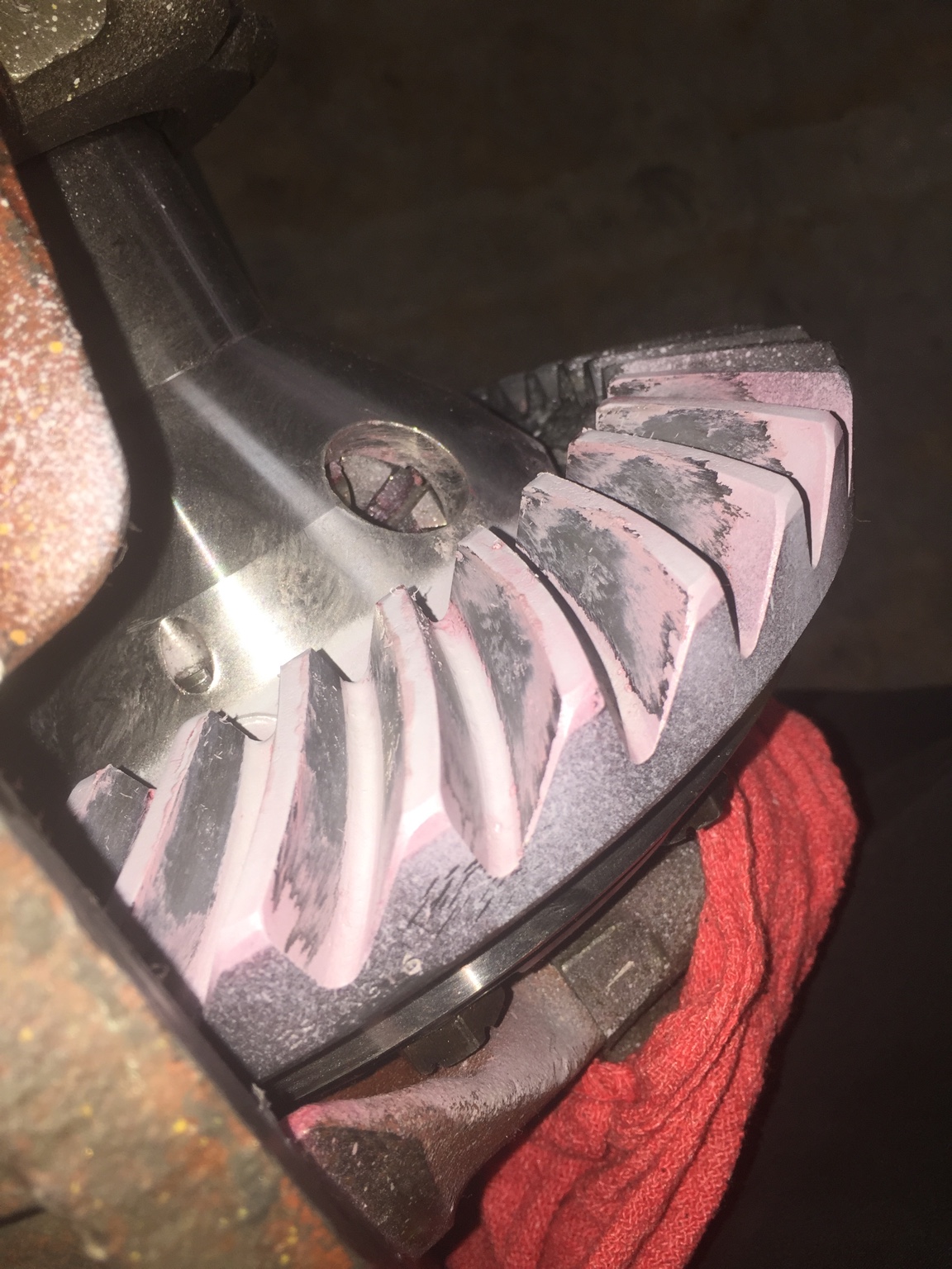

    The pinion preload is set to 15 pounds with the new bearings. I took a weight with the rope and wrapped it around the yoke to add more resistance. As I turn the ring gear it picks the weight up. All I could find is gray primer....nobody in town had actual marking compound. Thank you for holding my hand in this process! [​IMG][​IMG][​IMG]

    Coast side looks good. Only one pic of the drive side and it's hard to see what you have. I'd also like to see a pic of the pinion drive side. The drive side, obviously, is the most important, since 99% of your heavy load & driving time is on that side. Shoot for a good pattern on the drive side and the best you can get on the coast. You have to pretty much accept whatever is on the coast side, since to change them independently would require a change in the cutting & processing of the gear set.
    Pre-load on the pinion, is NOT the same as working load on the gear. The greater the load on the gear (from weight of the vehicle upon acceleration, etc). will tend to make the tooth bearing contact spread along the pitch line towards the heel of the tooth. The ideal pattern would be full tooth contact at the heaviest load to support the tooth strength of each member, without any heavy concentration (heavy, dark lines) of load at the top, root, toe or heel of the tooth. It would be very difficult to check the contact pattern under full load, so we try for a contact at the toe, centered on the tooth surface.

    Not too bad, but I'd like to see it a little more to the toe, so that under load it'll have room to move back towards the heel.

    Almost looks like the pinion needs to go back in just a tad.

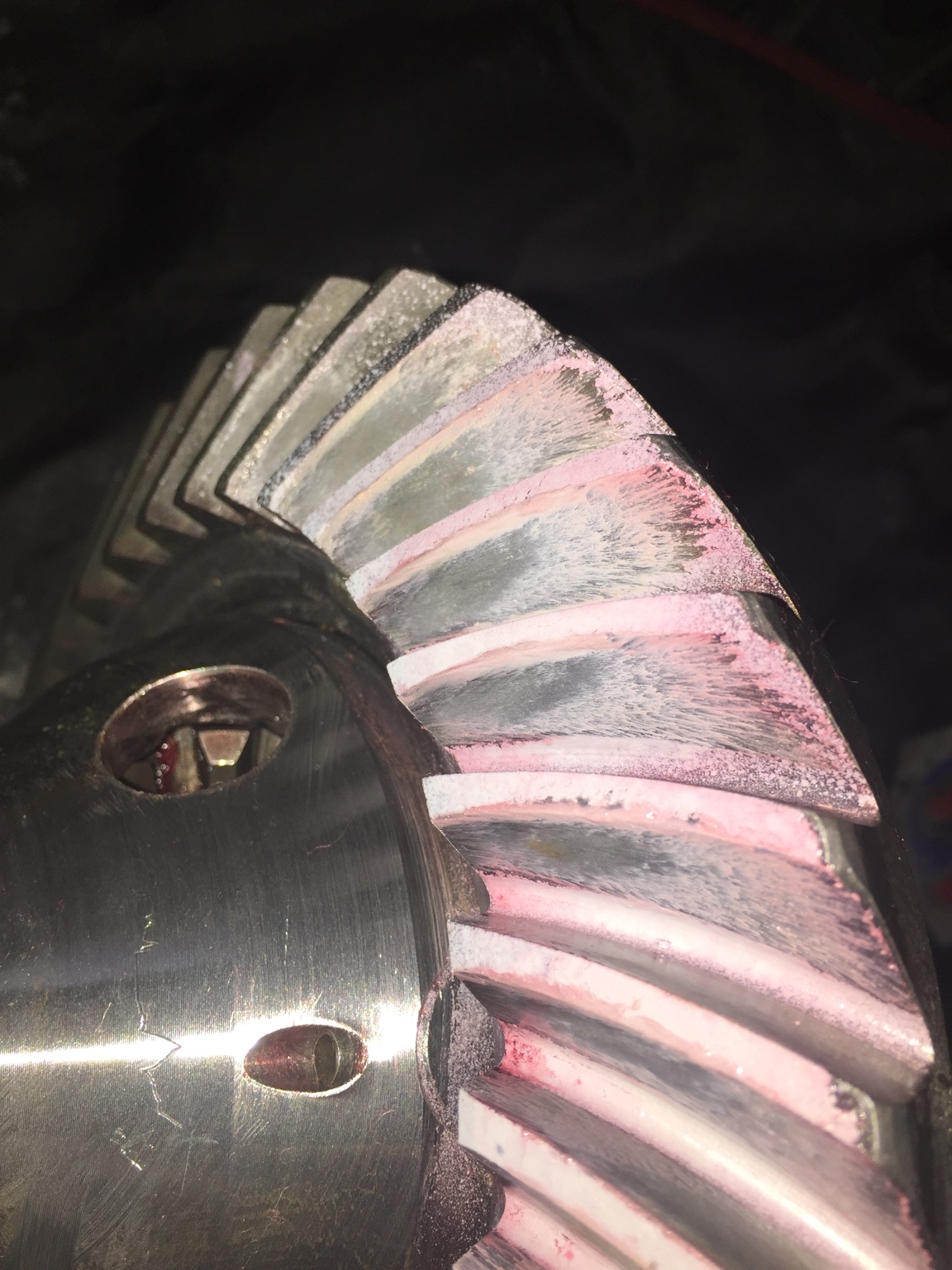

    Okay, the last time I added a shim I added two because they were suck together :doh:!!!!!! Sometimes I'm my worst enemy!! Removed one shim and reset back lash to .007.

    I think I need to pull one more shim based on my last photos, right

    If the shims are around .003", I'd agree with you.

    I removed the shim and found one that was .003 thinner. The backlash is .008. I hope this is good! Looks decent...I think[​IMG][​IMG][​IMG][​IMG][​IMG]

    Looks to me like you nailed it, my friend. Congratulations on spending the time & effort to get it right. You should have a nice, quiet set of gears that last a long time.
