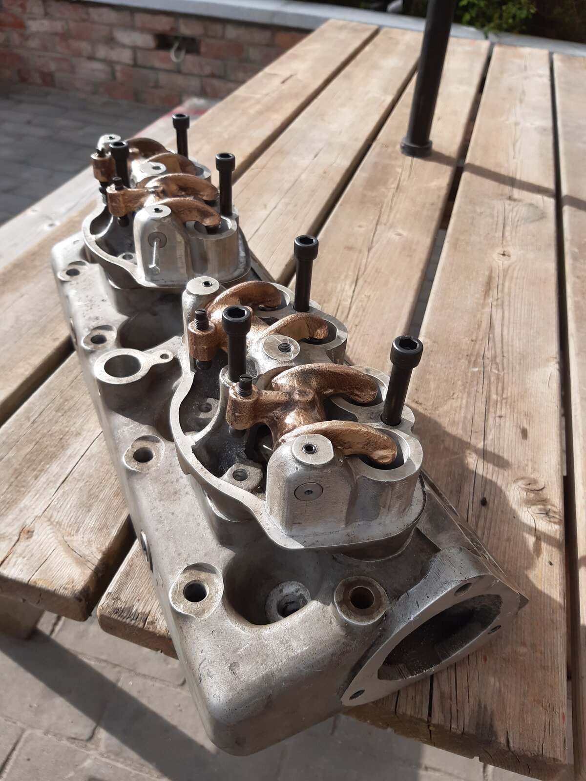

    Glad to see you are making progress. I found myself in a similar banger situation last year... and wound up machining mine from round bar.
    Cool stuff is never easy... That’s what makes bangers special;)

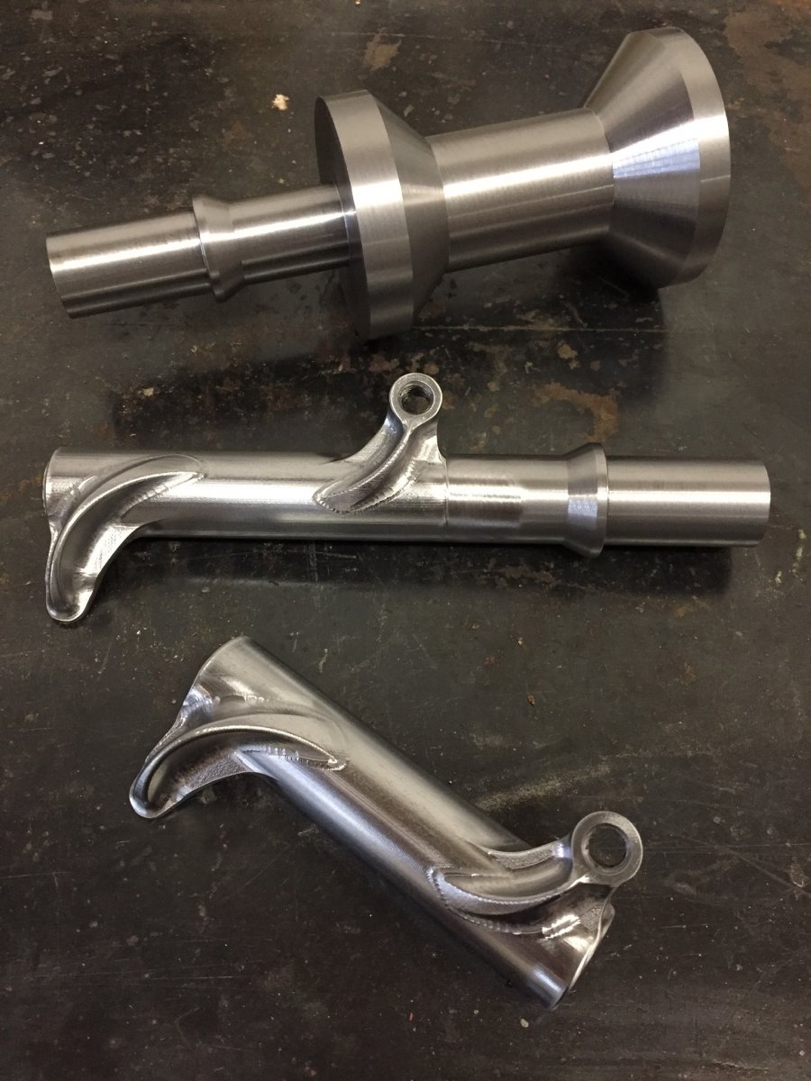

    Rockers and shafts now machined, remaining work includes drilling the oil galleries etc. Getting there one step at a time.

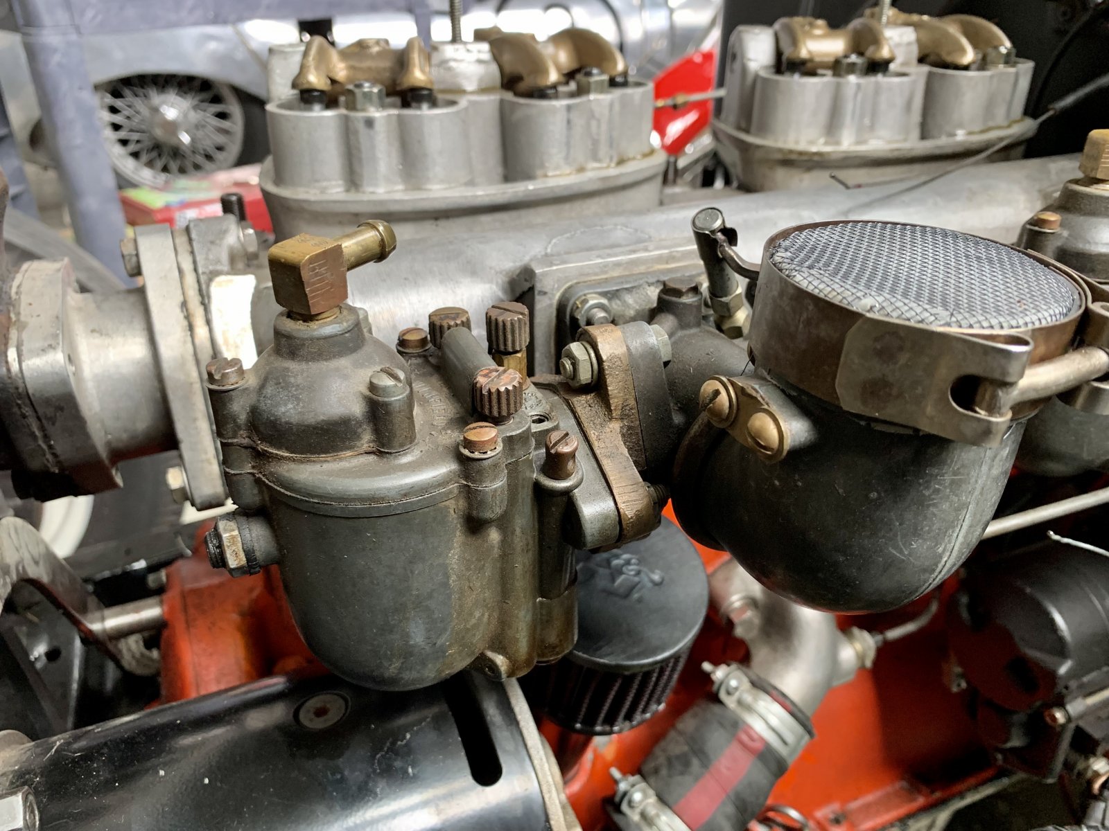

    Thanks for the advice. That job will wait til next week and I'm sure there'll be an update to post here-hopefully a positive one. I cant see any markings on the carbs to confirm the size so I'll measure them when i take the manifold off. Here's photos of them in situ.
