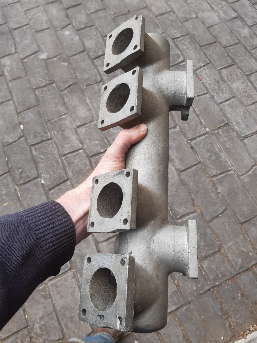

    I have an alloy 4 port Riley head and I'm looking for some info. It's old and unfinished and has a huge inlet manifold. It all appears to be in good condition but the machining was never finished. Anyone have any info? I'm after any history and any dimensions for rockers etc. so parts could be made to get it finished.

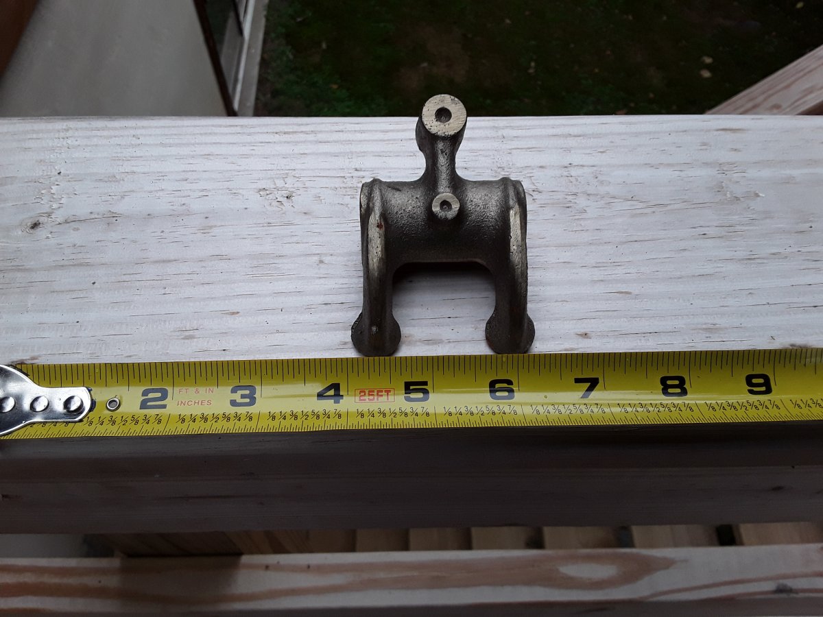

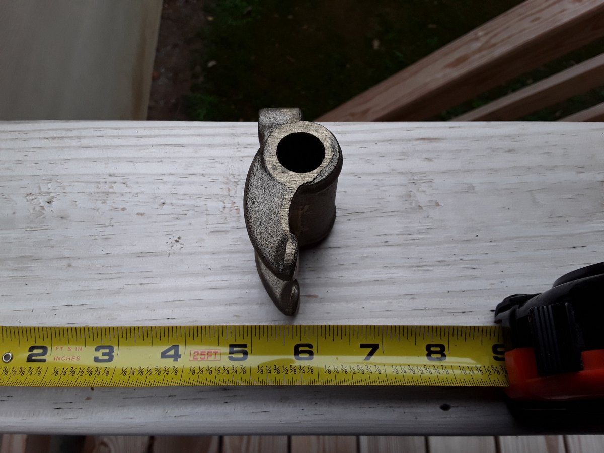

    My bronze rockers![​IMG]

  12. I believe you will need to make your own. Very little 4 port stuff out there. The one in the photo goes to an unmachined Butler I have. If you are not going to use Winfield carbs I would be interested in the intake as long as the intake ports are 1 3/4 and it's not for D size Winfields.

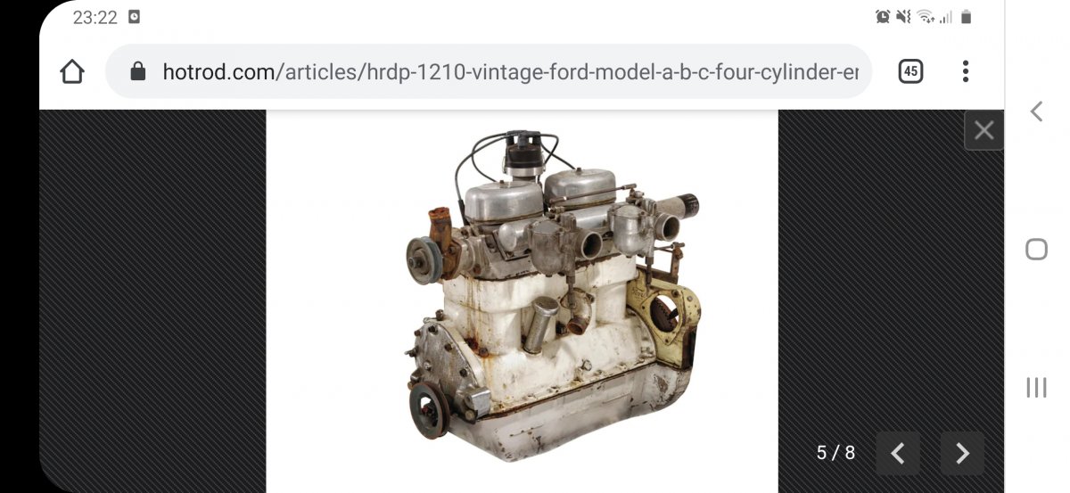

    Are the springs just normal springs or is there a cup type deal in the aluminum bore? Never seen this much info on the Aluminum Riley 4Port, had a cast iron one dated 1934 back in the 1970's. That Intake is setup for Riley side draft carbs I believe. I'll dig out my Riley book and post what I find tomorrow. Bob

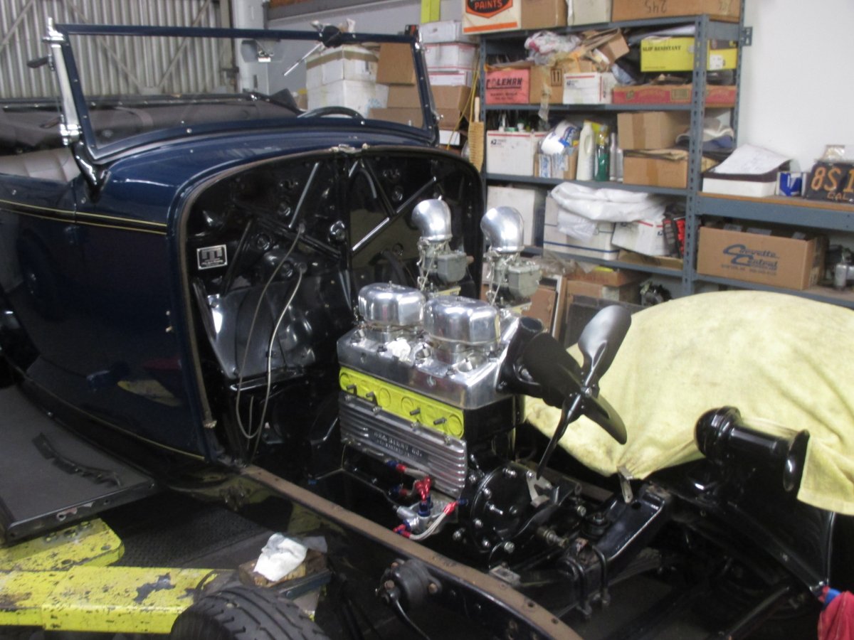

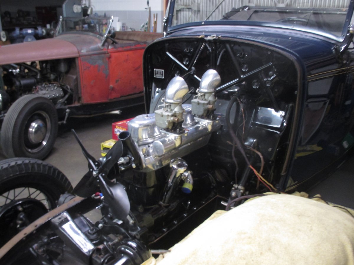

    Here's few more pic's of my Riley for comparisons.

    [​IMG] Rockers look so much better than the early ones, do they get pressure oil some how? Bob

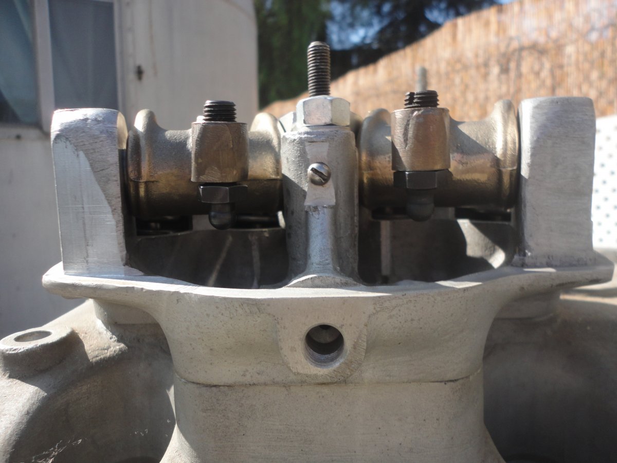

    George Butler improved the rockers! There are a couple threaded ports on the side of the head to bring the oil up. It's pressurized. Here's a pic I borrowed from the HAMB . I talked to an old racer and he said they soaked a sponge in oil? Don't know if it's true or not.

    Felt pads soaked in oil were common back in the 1920's - 1930's, most races were 20-25 laps. Bob

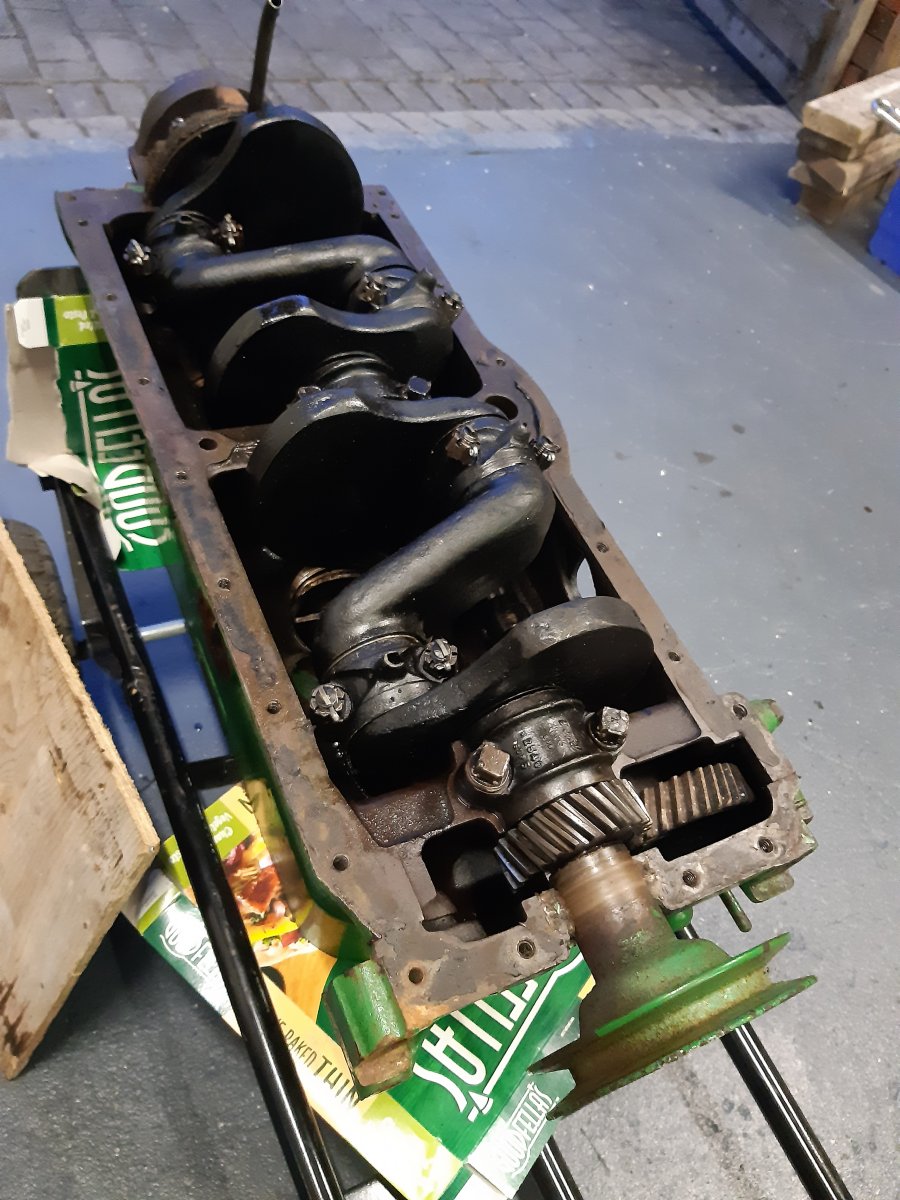

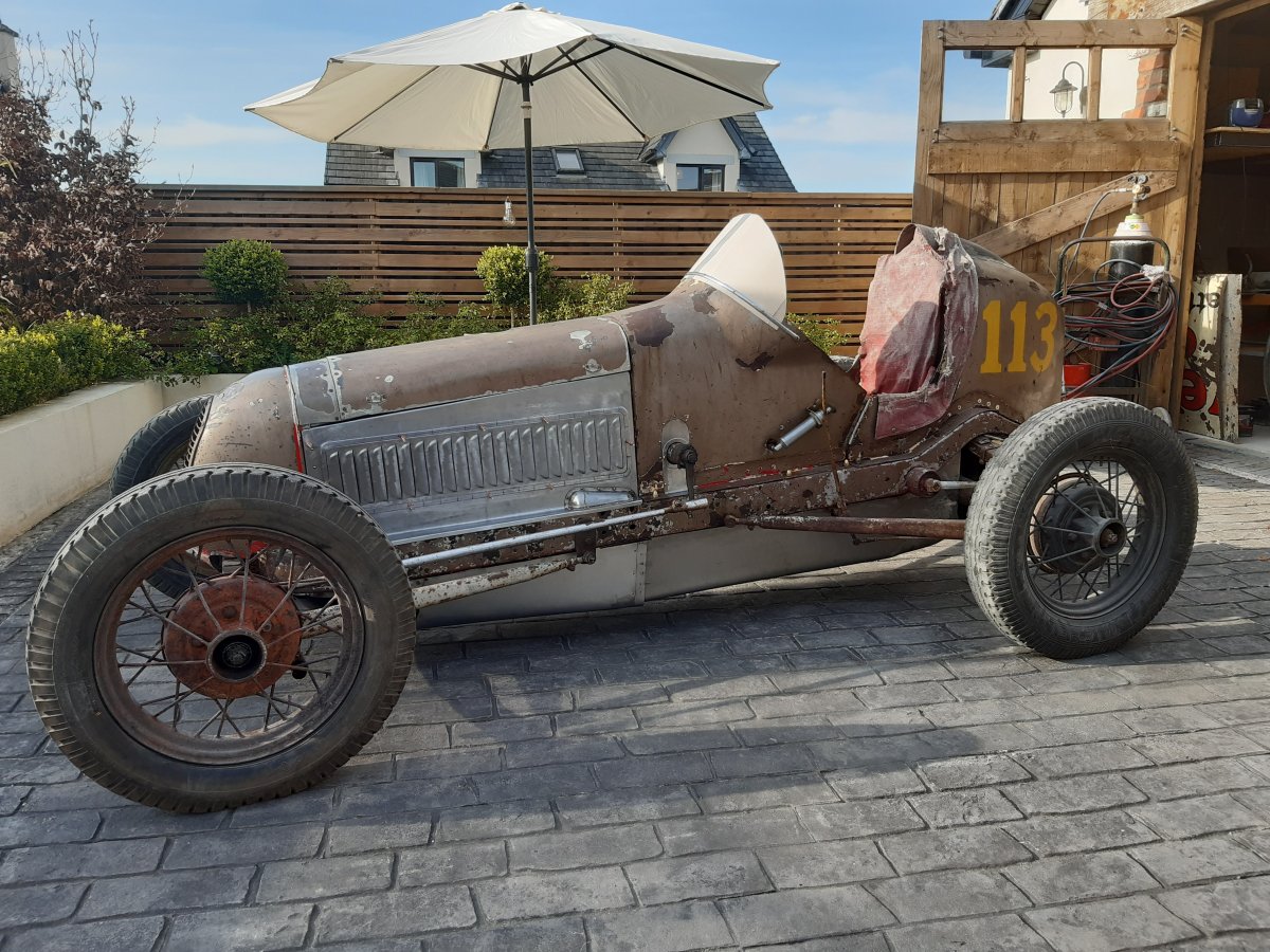

    Hey Rick, thank you for your reply and excellent information. I am based in Carlow, Ireland, now you'll understand my difficulties with parts......I bought the head to run on my B in my sprint car project. I sent the engine to England to get shells fitted and the shaft drilled to get pressure feed to the rods.

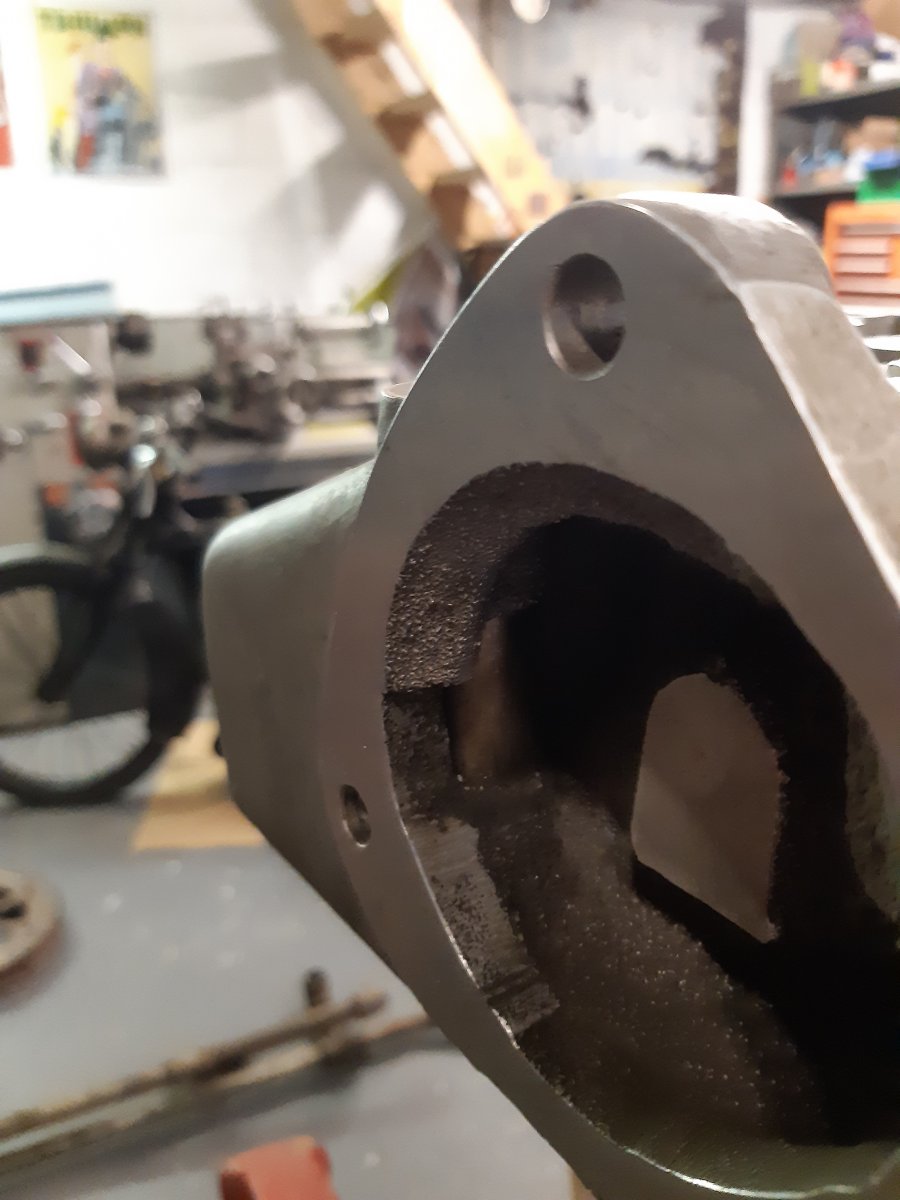

    From earlier advice it sounds like the head I have is possibly a Butler cast as the single stud hole beside the water pump flange is fitted with a steel sleeve through the water jacket.
    The manifold and ports are 1 3/4 bore.
    The push rod holes look narrow, were these opened up to a larger size prior to assembling? Same with the oil feed to the valve train, on mine the feed holes are not bored. Any advice on completing this woul be greatly appreciated.
    I have a good foundry near by, I'm going to try to copy the rockers in the photos kindly sent earlier in the conversation my fear is that if I get it wrong I will do damage and I want to avoid that.
    Many thanks for your information if there is an accurate drawing of a rocker arm I would be extremely grateful to see it.

    Would anyone have or know of anyone who would 3d scan a rocker? Or have a rocker to sell? I discussed it with the foundry today and they think it's an easy part to make. Any help with this would be appreciated and would get this racecar and its 4 port back on the track.

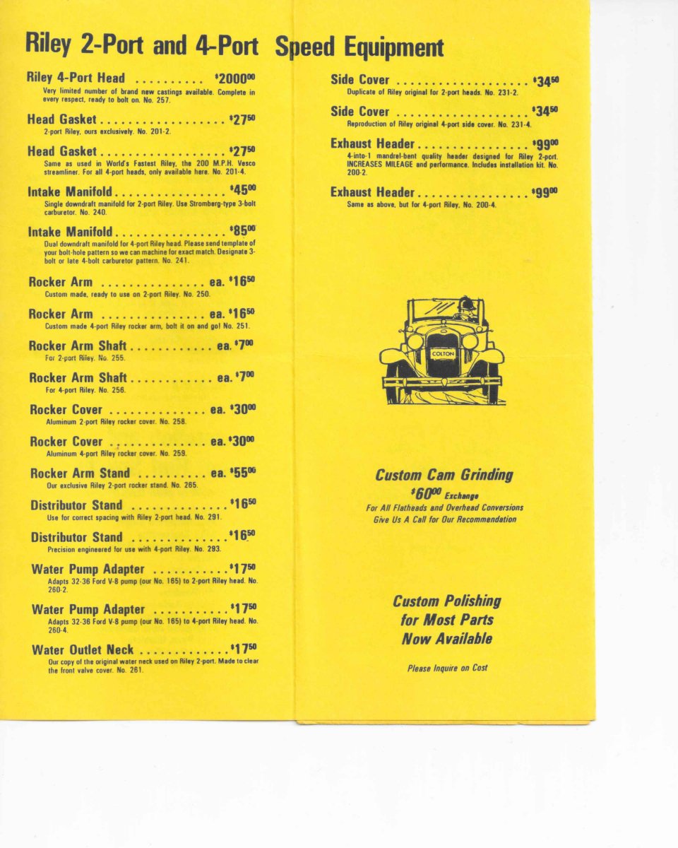

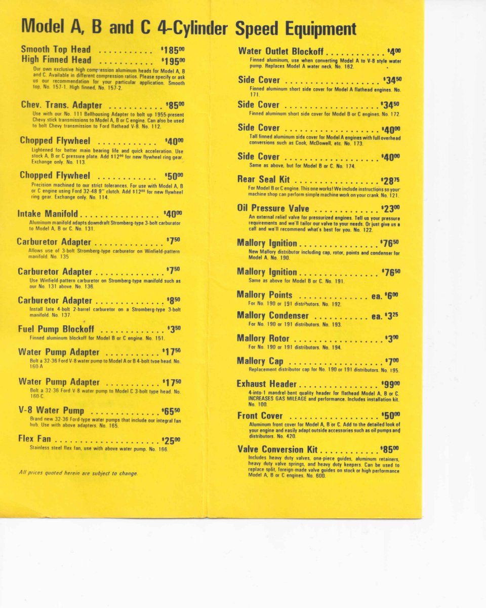

    Here's a cool book if you can find it, it's out of print. Here's also a flyer from a shop that used to sell Butler Riley's, it was behind Colton Auto Parts. I'll ask around on the Rocker.

    Again many thanks all for your excellent information. I will try track down a copy of the book. What year is the brochure from?

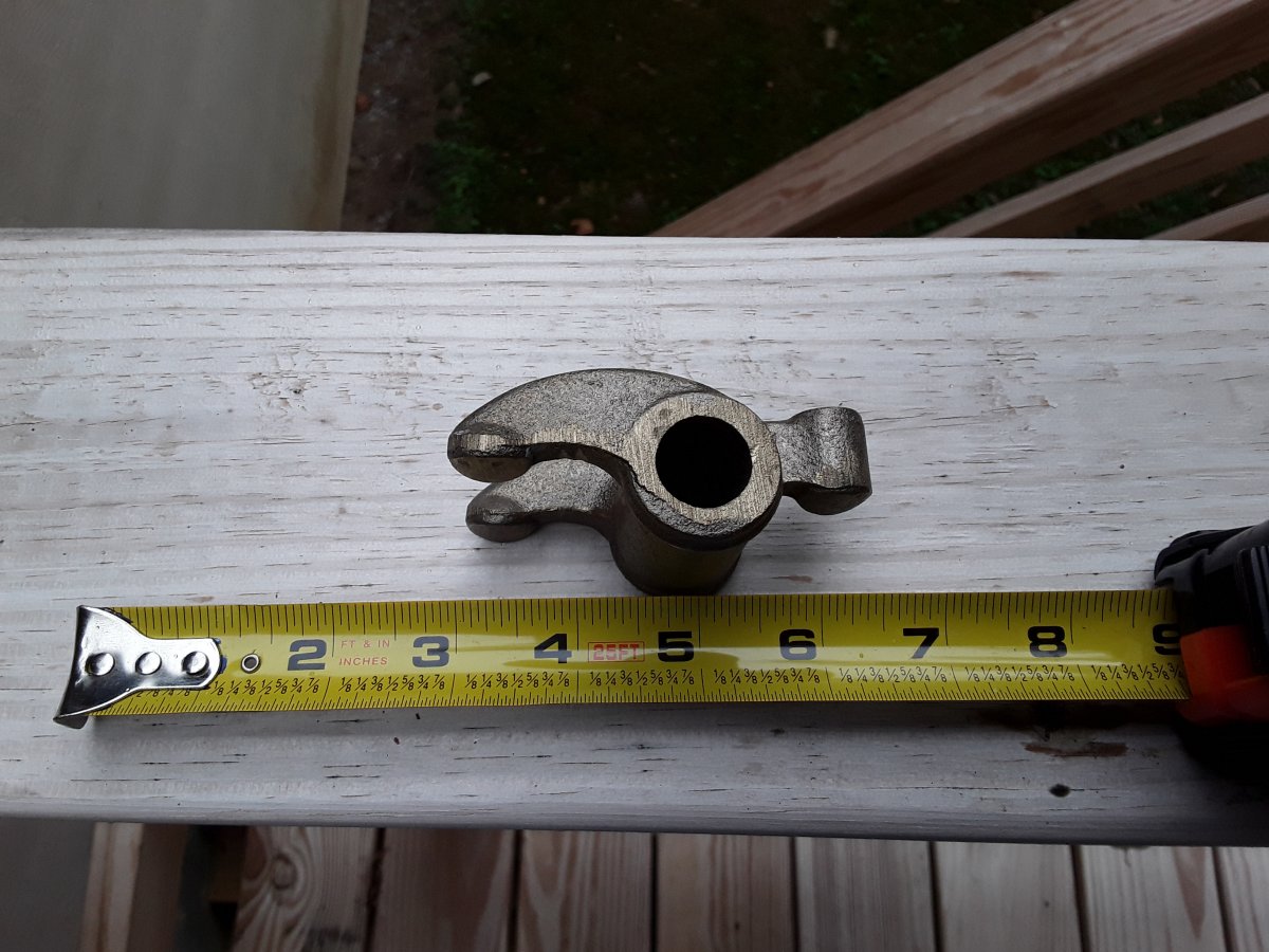

    Get one on eBay right now @$45.00 plus postage. Bob

    Brochure is from the 80's. Dan Iandola did an article for Rod & custom several years ago that has some good info, also there is a small book
