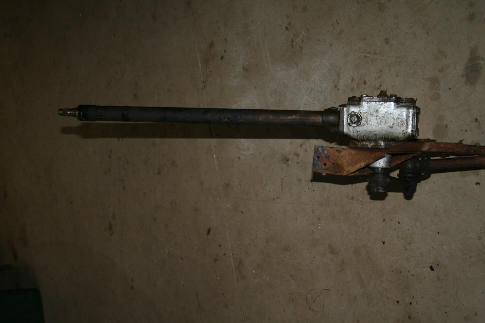

  29. JSBriggs
    Joined: Nov 9, 2006
    Posts: 122
    JSBriggs
    from Auburn, CA
    Here is a Land Rover box. They are fairly cheap and plentiful.
    -Jeff
    Dannerr likes this.
