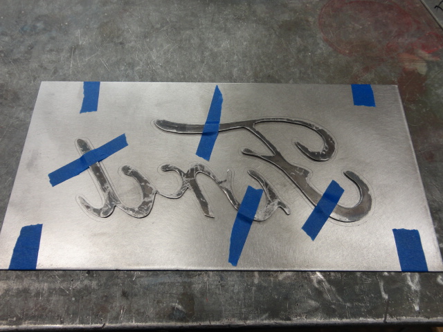

    Here's a simple run through on a Ford script I had been trying to make
    for quite awhile. I've had trouble with distortion on such thin material. I ran into
    a guy at a swap meet selling stuff cut with his plasma cutter.
    He said his plasma cutter could do it no problem. Well it was a problem
    , but it was close enough for me to straighten the dies, and clean every thing
    up. I left a set of dies with him, but never saw them put to use. This is 18 gauge cr.

    The first pic in post 138 shows the die, but realize there is a piece of 19 gauge
    under it. You scribe around it , than remove the female die so you can place in the correct position.
    Than you tape it in postion, next you place the male die on top. So we have a stack of bottom to top.
    female die, blank piece, male die. now we press the piece. don't forget the WD40. you have to pry them apart.
