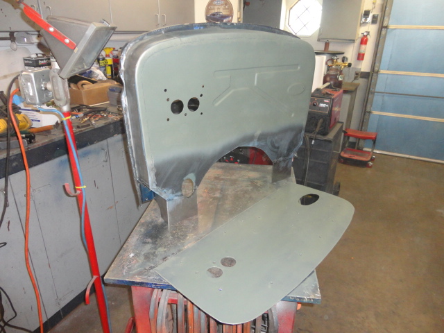

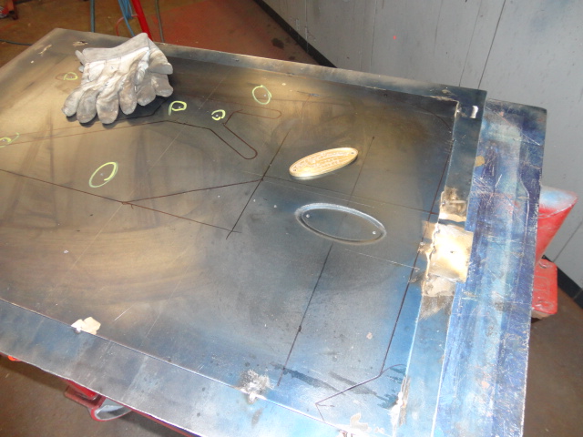

    Here's the dies I used to press the firewall. I cheated, and used my cheap
    mill to do most of thr work. Most of my projects were done with saws
    files, and hand tools.

    The vin tag is pressed in from opposite direction. I saw pic on one of the cars from England,

    The main design ready to press. You want to stretch the metal into the
    die not pull it from the surounding area. Don' forget the oil.

    Sharp eyes will note the last pic is hot rolled with scale. I was not happy with my first
    pressing, and used some hot rolled to see what the problem was. It worked so well, I'm
    using it. You didn't really think I was done wih that firewall yet diid you!
    I'm using a firewall mounted pedal assembly, and want no flex .
    I'musing 1/8" plate which will be plug, and edge welded to the back upper half.
    There will also be support rods tieing dash, and steering column together.
