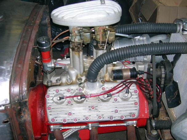

  9. JimA
    Joined: Apr 1, 2001
    Posts: 4,796
    JimA
    My friend Lynn Bird did the slick metal work on this. The gain was 4-inches- the toe board area was returned to stock config. after the upper was reversed. NO foot room was lost, but 4 more inches really helped with distributor clearance.

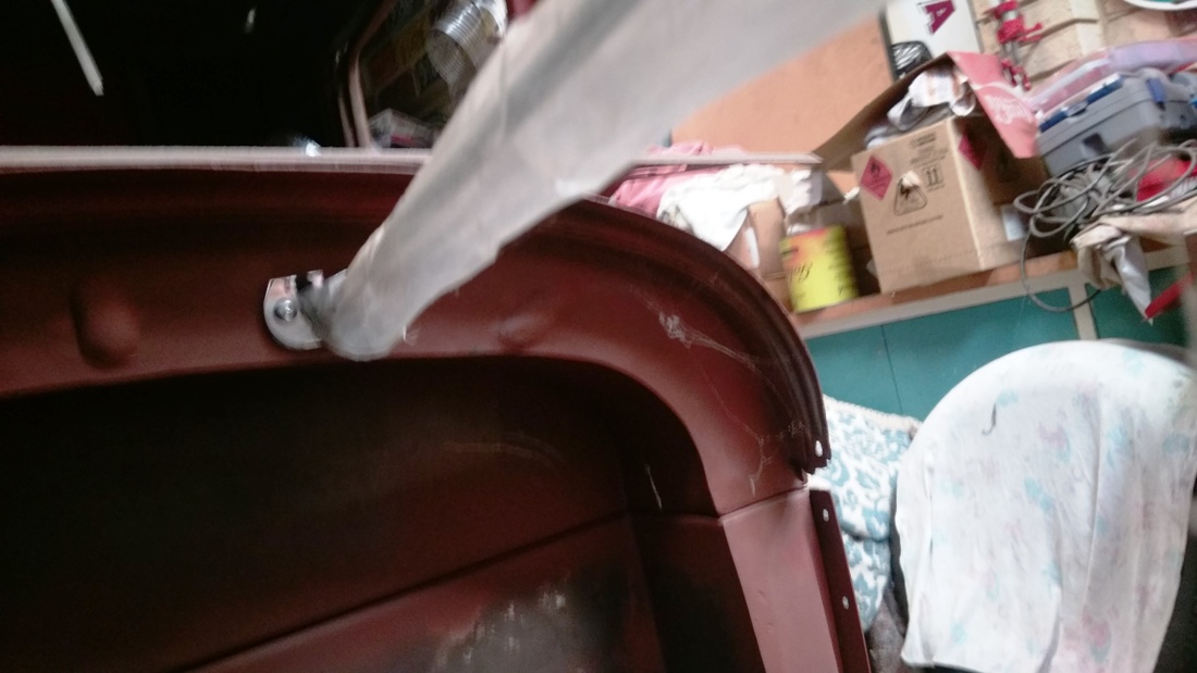

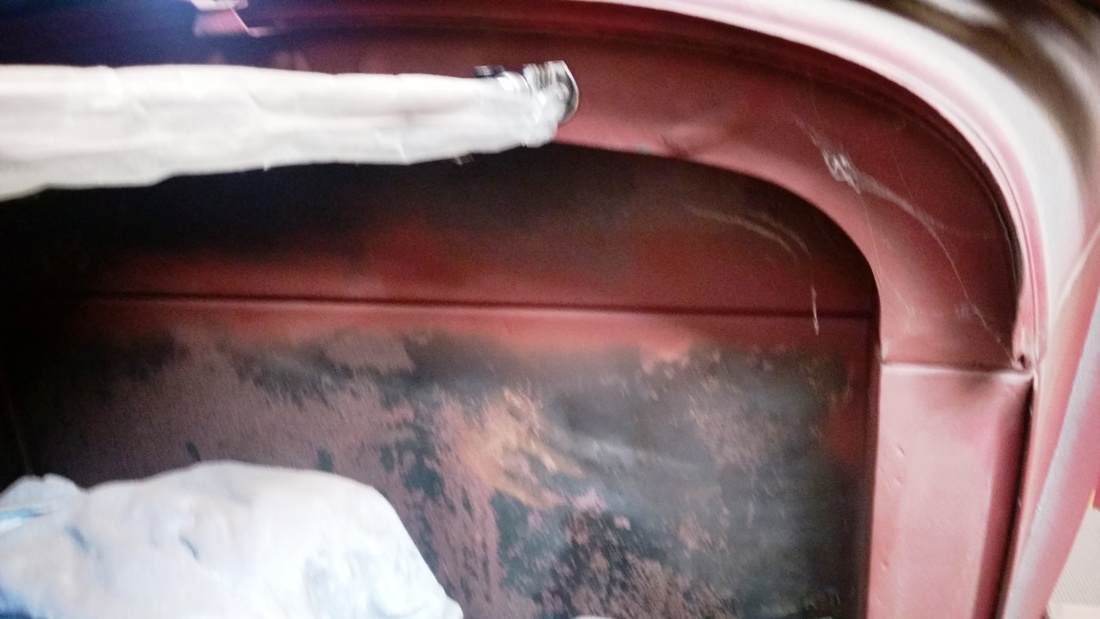

  17. This is my 1931 Ford model A body, which is not channeled, with a 4" recess built into the firewall, which is the perfect size for a small block Chev V8. It leaves plenty of foot room, and as far as I know would not cut into the original gas tank position. It's a bit hard to tell, because the gas tank was cut out of my body when I bought it, however a friend of mine has the same body with a functional uncut gas tank, and he is running the same recess as mine has.
    brianrupnow has attached this image:
    kidcampbell71 likes this.

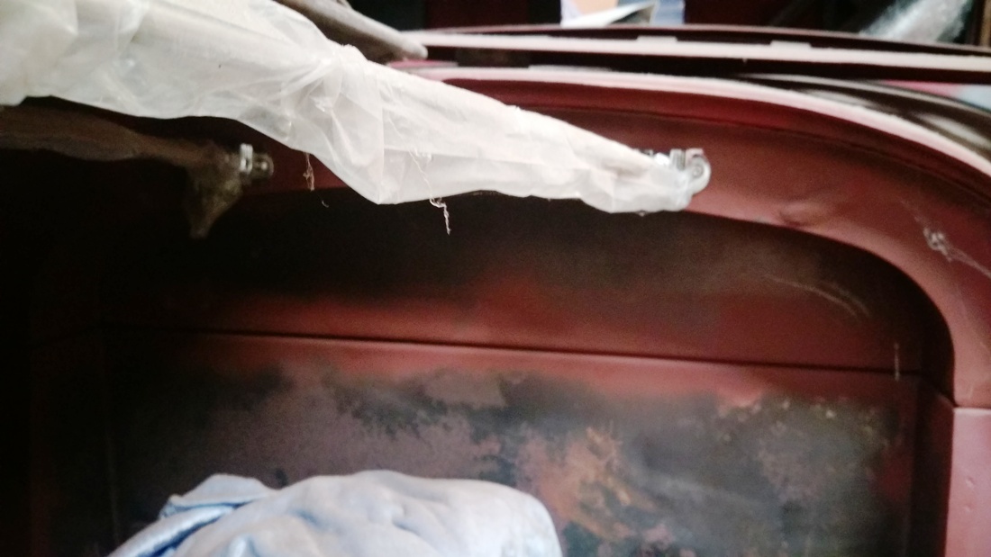

  18. I know that this isn't what you asked for, as far as a reversed firewall goes, however----This is a non reversed firewall that I built a 4" recess into, and it worked out very wall. The recess does not require a lot of complex metalwork, and it leaves more clearance under the dash.
  19. Now thats FOOSE. Change it, but make it seem like it wasn't. Damn nice work!

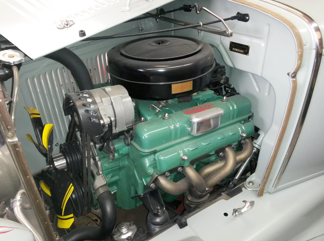

  22. Canuck
    Joined: Jan 4, 2002
    Posts: 1,048
    Canuck
    Reversed along the line of spot welds, then a section cut out and by using a hammer formed band to gain a additional 3". Custom rad support rods to place the rad in stock location. That Buick is a long engine.

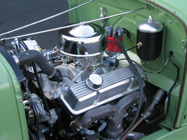

  23. fiftyv8
    Joined: Mar 11, 2007
    Posts: 5,120
    fiftyv8
    from CO & WA

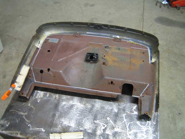

    For a SBF or SBC engine in a Model A you could consider what I call recessing the firewall about 4 inches.
    In some cases reversing a firewall may achieve that magic number.
    I am not a fan of using a wheel barrow bowl for this purpose, but then again each to his own.
    A recess done with a bit of forethought, no cutting corners and a decent amount of effort should provide a decent outcome.
    For a 28/29 Model A firewall I like this type of recess.
