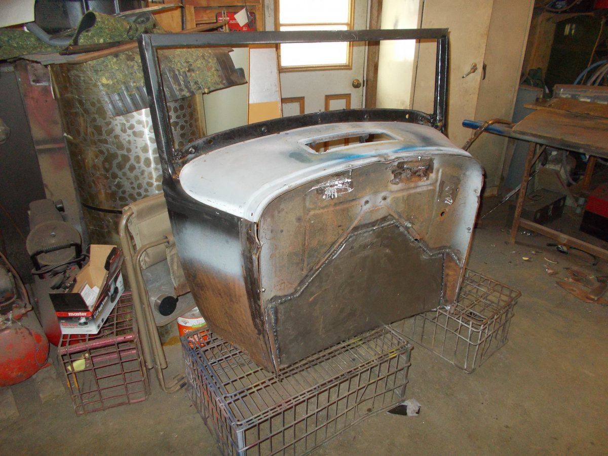

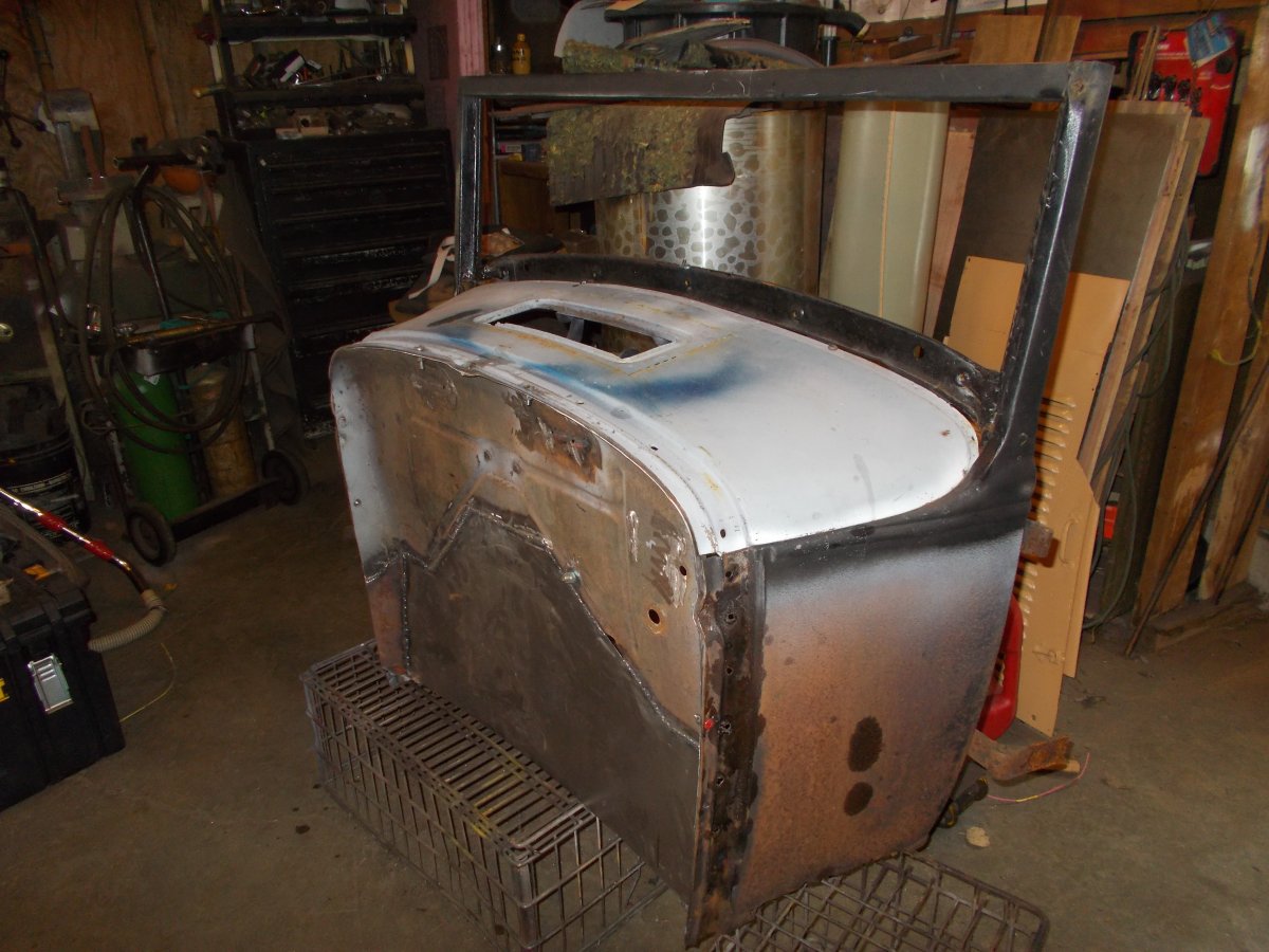

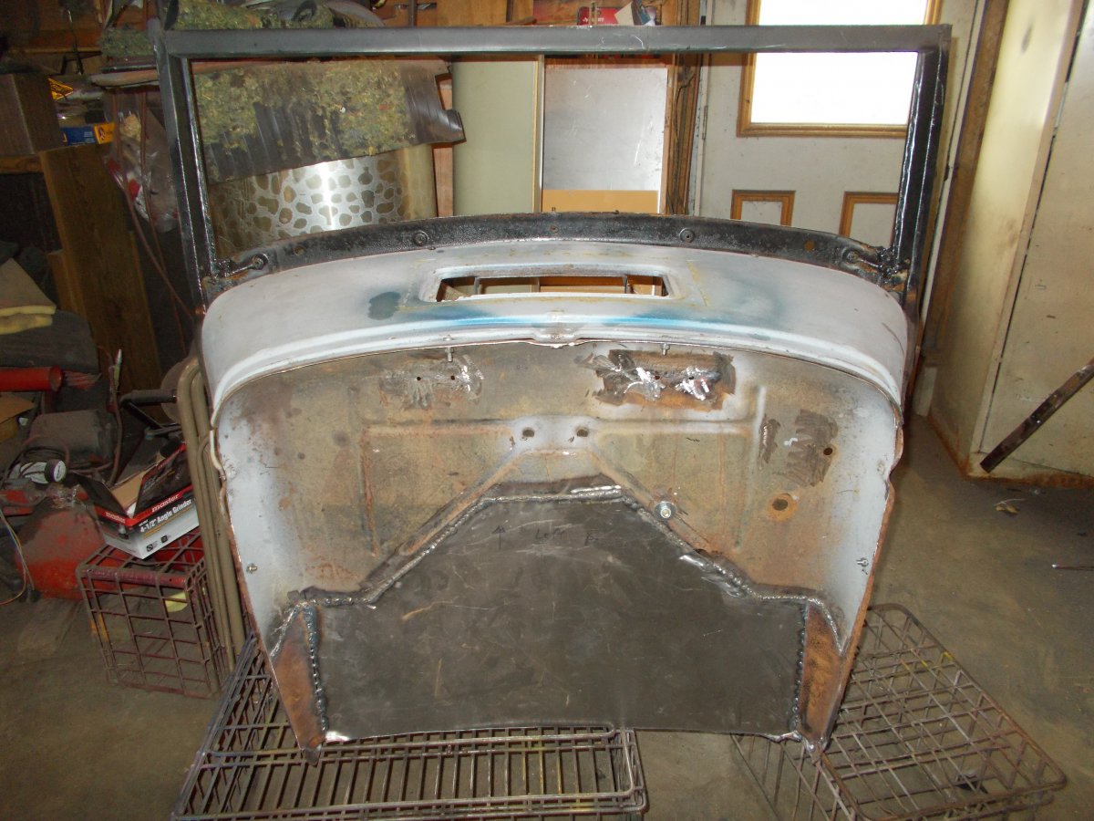

    Playing with a '30 coupester, saw and liked a reversed firewall here on the hamb…
    I did it 30 years ago but I narrowed a '30 to put in my '28 tudor…
    I removed the '30 firewall...
    trimmed out the hot air and hot water heater holes...
    cut a piece of steel to fit, welded it in...
    I will bend the toe boards back and trim off the lower firewall for now, trim later...
    to extend the firewall's outer edges down to the frame I used the curved outer edges of a scrap '30 firewall...
    welded them in, not long enough, so I will make plates to mount the front of the cowl...
    still have some welding, grinding, sanding, redrilling and tapping waiting...
    but after some attention the old girl should turn the trick...

    firewall is not flat, has a slight bow top to bottom... the steel flexed to fit no problem...

    Upon further review,
    The stock firewall gets wider as it gets further from the radiator...
    being reversed, the firewall get bigger as the cowl gets smaller... the 1/8" offset at the upper and rearward edges forces the tank upward... can get it close but too tight...
    I will remove that 1" offset all around... making about 1" less room... but still a big difference from stock...

  7. sloppy jalopies
    Joined: Jun 29, 2015
    Posts: 5,256
    sloppy jalopies

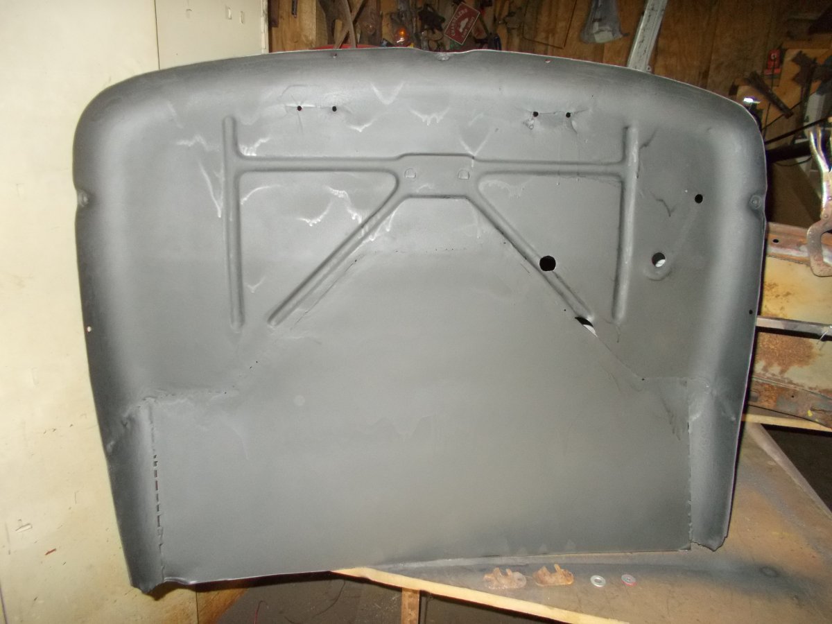

    I removed 2 screws at the top... 2 rivets at the base...
    about six spotwelds each side...
    I spray bomb the section of the cowl that the firewall welds to black...
    when dry I lightly sand that "channel" …
    the spotwelds will be low, stay black, now easy to see...
    I drilled them out with a 1/4" bit... then hammer and chiseled the remaining bits of spotweld…
    easier than I expected...
    going to cut off the 1" outer, offset flange from the firewall so it will fit better when reversed on Thursday…
    try and remember to zap some pix...
    you can just see the 1/4" holes along the hood offset...

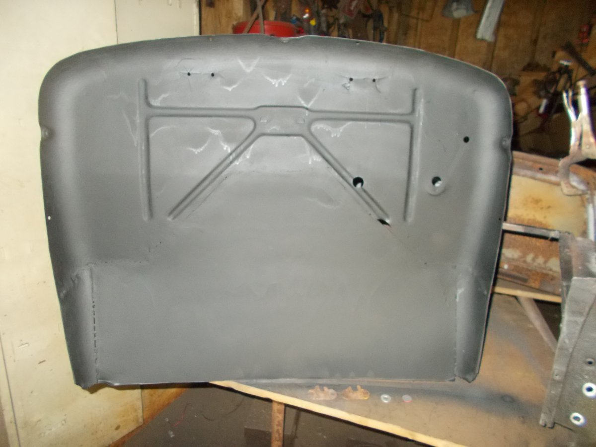

    Removed the outer 1" flange this noon, the firewall fits much better now...
    [4] 1/4"-20 bolts hold it in for now...
    … the 1" outer strip... FREE if it helps mount a flat sheet firewall... [tank bolts would line up] DSCN3546.JPG
    Didn't need rear distributer clearance...
    Just want to run a stock hood.

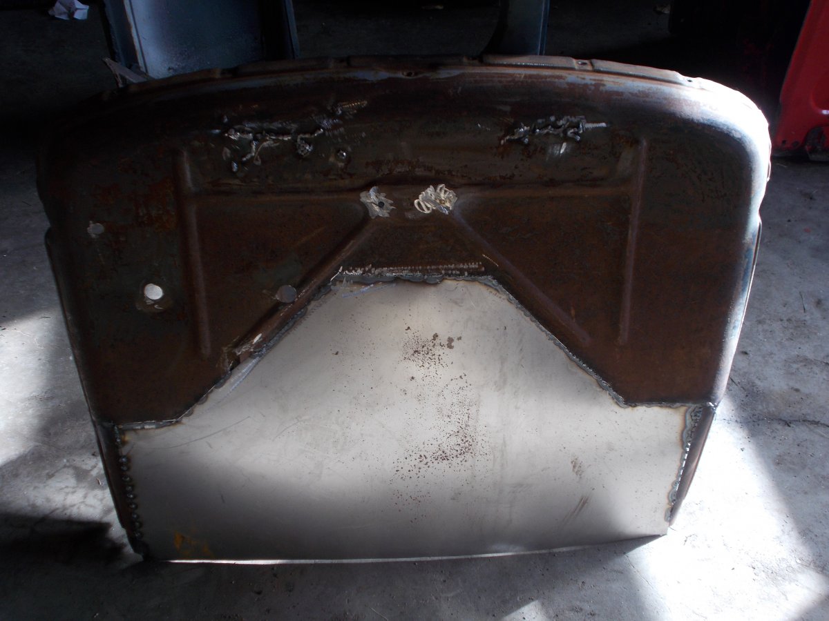

    Funny how the inside of Maine firewalls are so much less pitted than the outside...
    DSCN3564.JPG first pass grind n' sand... spray bomb...

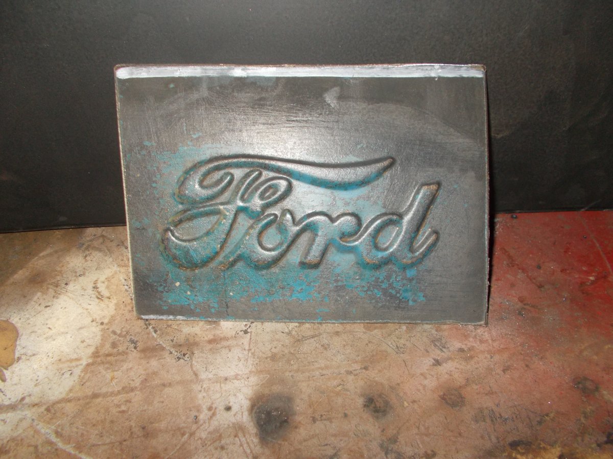

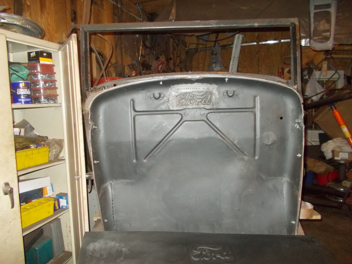

    Thinking about welding a ford script centered 3.5" below the embossing in the firewall... opinions ? DSCN3539.JPG DSCN3563.JPG

  16. DOCTOR SATAN
    Joined: Mar 21, 2014
    Posts: 710
    DOCTOR SATAN
    from okc
    Ford backwards....driver returns on foot
    wheeldog57, Budget36 and Bandit Billy like this.
  17. Bandit Billy
    Joined: Sep 16, 2014
    Posts: 12,372
    Bandit Billy
    My earlier comment I couldn't help, I'll blame the Theraflu I'm taking but it is likely the Cap'n Morgan's and Fireball I added to it. By all means weld it in! It will look very cool and personalized.

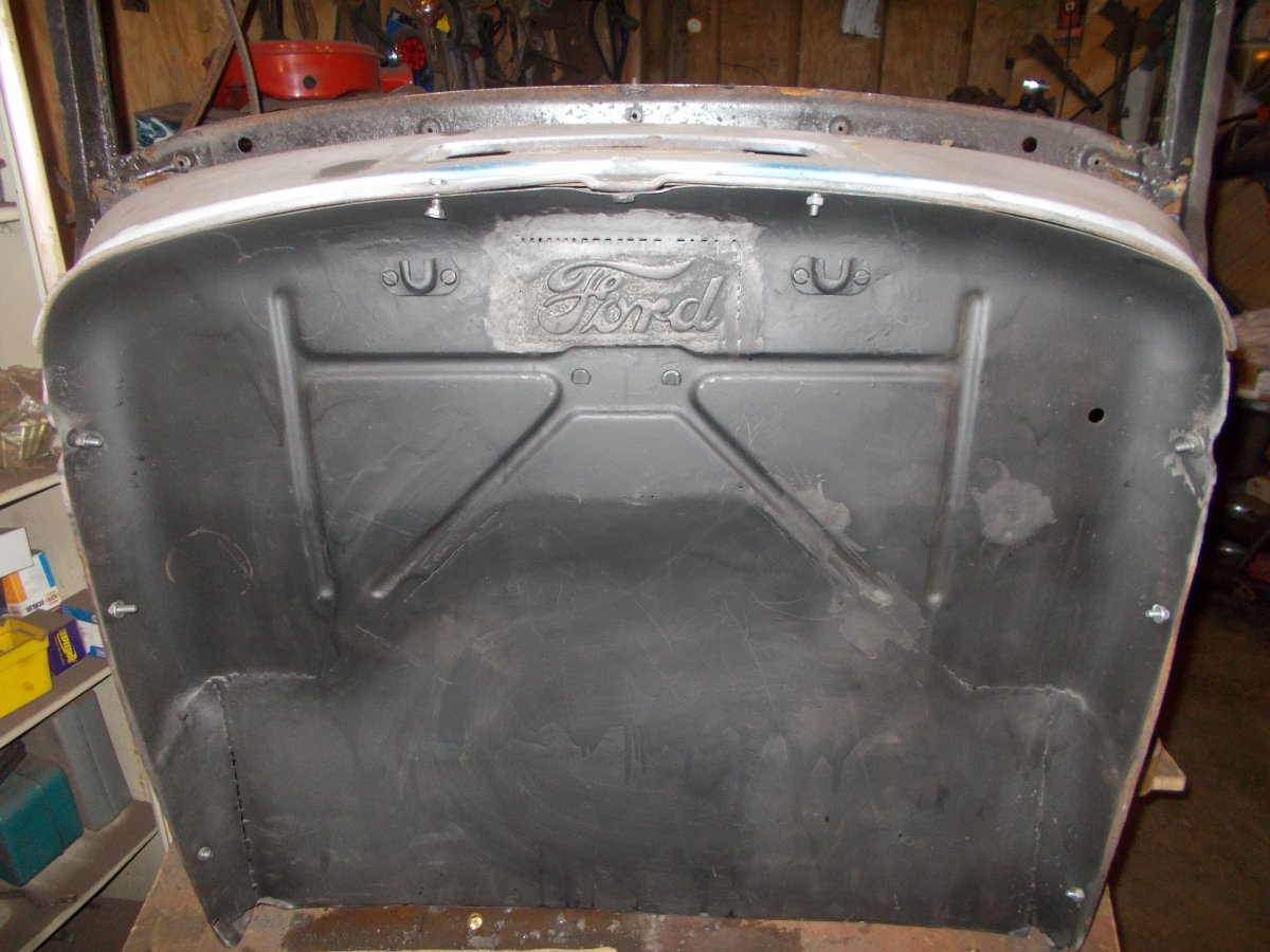

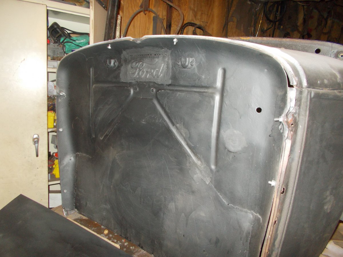

    Many people don't like the look of a reversed firewall but I do. Nice work. Can you make a second one and send it my way?

    the Ford script grafted into the firewall looks great !!

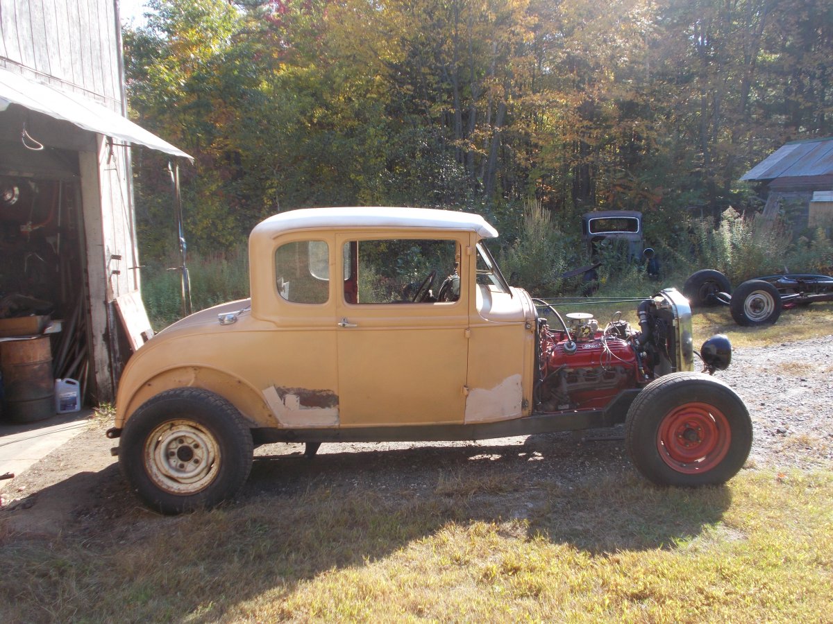

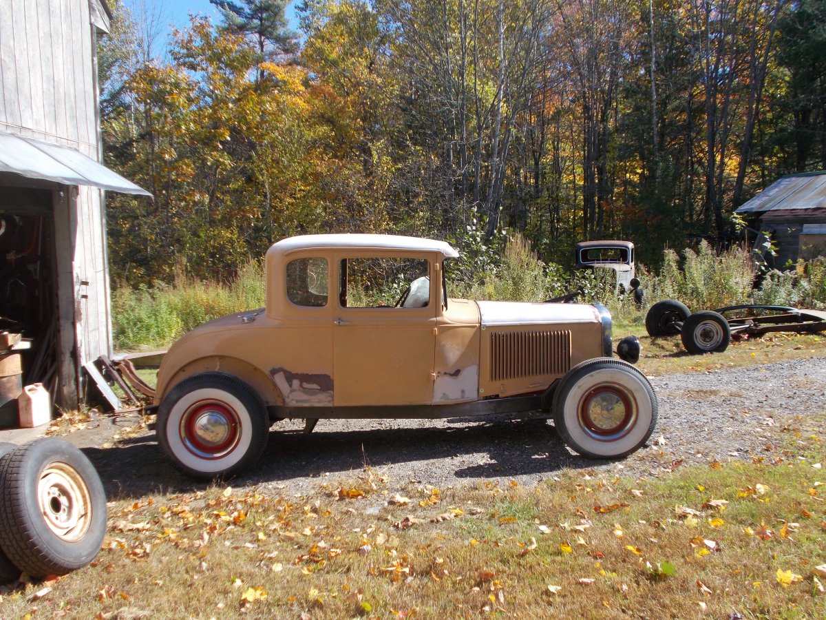

    wish I had done it to my coupe last winter when I had the chance...

    If you slide the body forward 3", where is your rear wheel/tire radius going in the fenderwell?
    It already needs to go back a couple + inches.

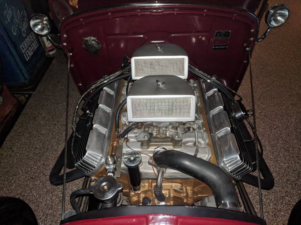

    I learn a lot on the HAMB, & I contemplated the reverse firewall. Personally it looks totally backwards. With all respect, many of you have put in a lot of work to make it blend in reasonably well. But the Model A has an "outie"
    I cheated with 32 rails, then no problem fitting a Nailhead into a '30 with original "Outie"
