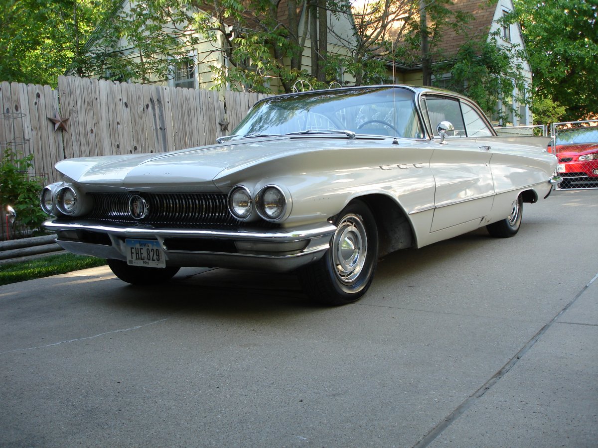

  1. I've got a '60 LeSabre Coupe that I bought of the Las Vegas CL back in March. I really like the look of the Supreme 5 spoke with a reverse offset. The Buick still runs ball bearings up front. Don't know if there is a roller bearing swap available. Are the reverse wheels gonna chew up my bearings? What about extra stress on the other front end components? I've heard it a million times, but never actually talked to someone who had bearing failure happen to them because of reverse wheels. Should I be concerned?
