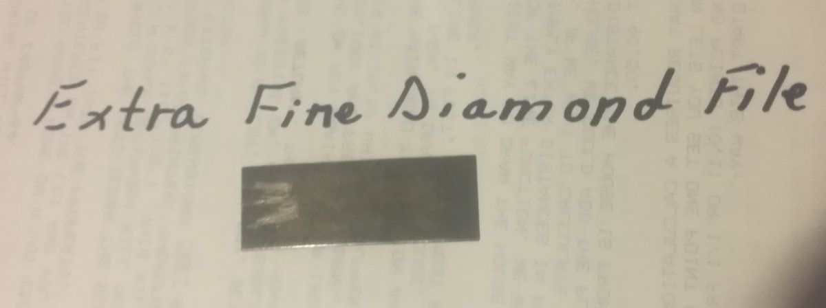

  16. This is a picture of the extra fine diamond file that I use. The size of the board is approximately 3/4 by 1 1/2 inches.
    I purchased it from a hardware supply, and separated the plastic handle leaving the thin metal rectangle with the diamond matrix.
    I don't even have to remove the points. I just place the file between the contacts, hold them square with light pressure of a screwdriver, and file until the oxidation is removed. Then I flip the file over, and do the other contact. There is virtually no parent material removed during the process.
    On the left side, you can see the oxidation that I removed from the points.
    It works like a charm.
    Bob
