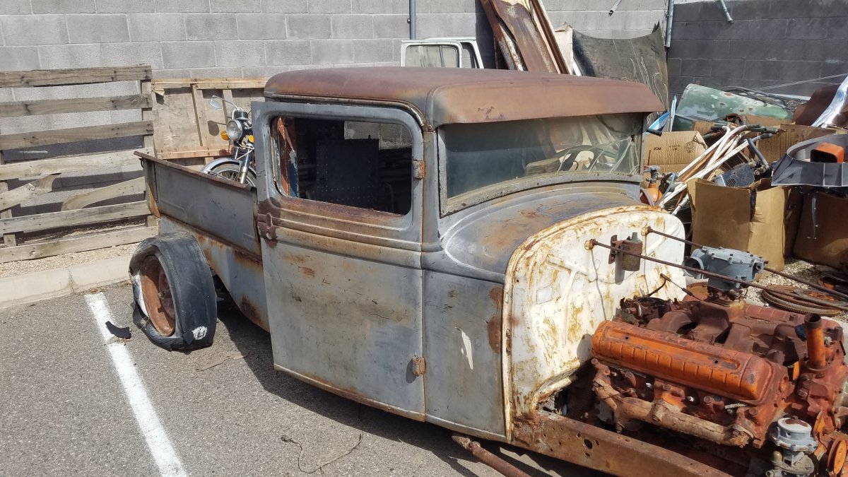

  1. About a 2 years ago , I came across this OLD Hot Rod 34 Ford Truck found on one of them interweb ads. Got the truck home and not sure what I was going to do with it at the time with so many irons in the fire already. So I tryed to sell the truck at the Good Guys show Spring last year.. LOTS of interest but no one really stood up to the plate and made a offer, So back home it came and got pushed into the back 40. Meanwhile as time went on I had got parts and pieces for another build I was doing at the time. But some bad judgment calls on CHEAP parts that put that build into a category of unsafe, I looked at that 34 Truck HMMMM this might be a quick easy build.. As the Bones looked to be good.
    The truck as found..

    Pulling that Olds out and finding out it was JUNK, Tryed to find another to replace but nothing local at the time. also found out it was going to cost a lot of $$$ to rebuild one of those old beasts if I did find one. So at this point decided to do what everyone else has done the last 70 years put a SBC in it considering I knew I had a good runner sitting..

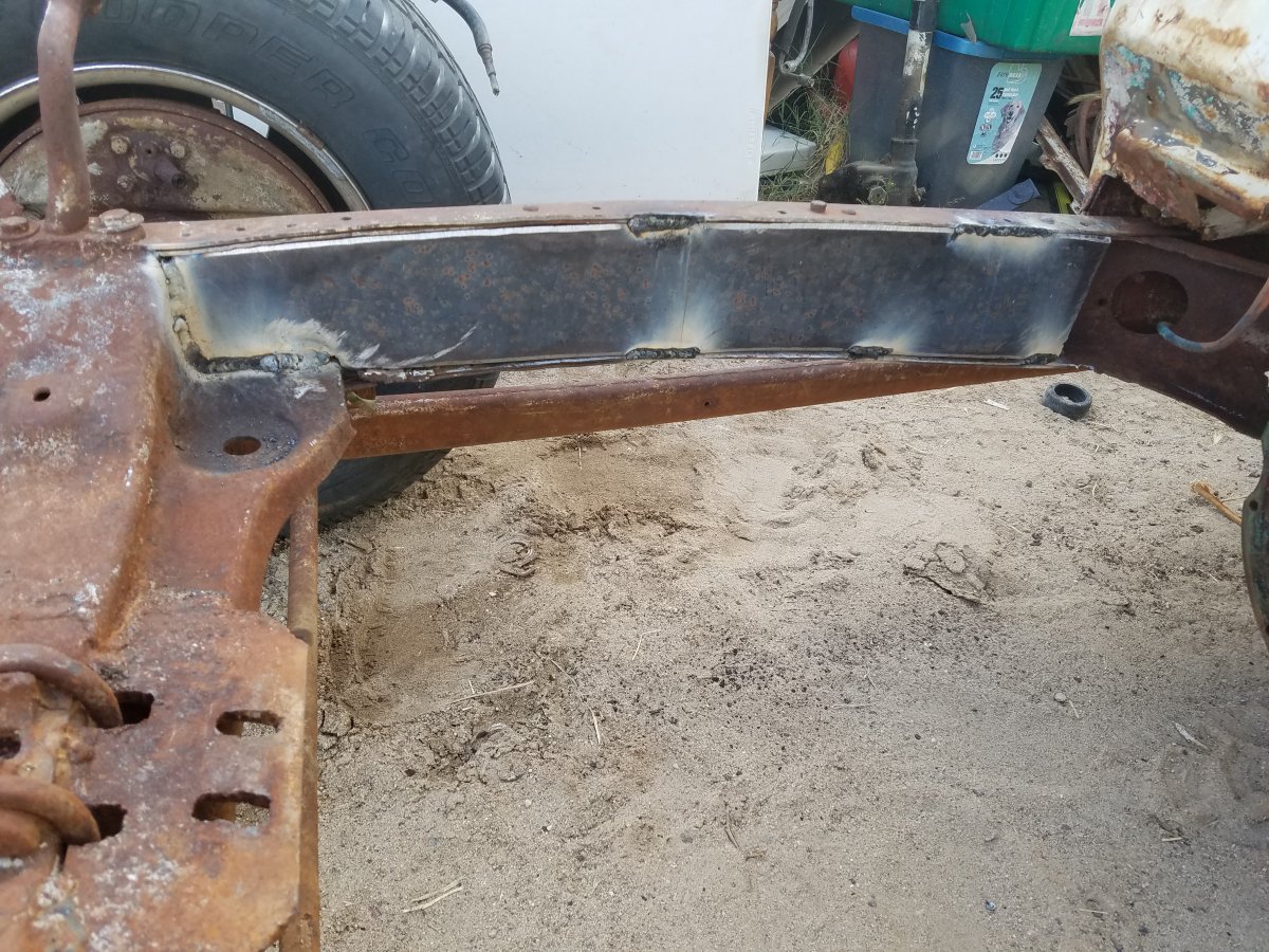

    I knew that the Frame needed to be boxed so the front half was done..
    At least this pic was saved?

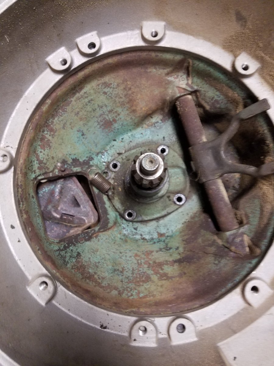

  7. Being a Old Skool build wanted to keep that look. It did have juice brakes already on it, Good starting point. Found a set of Buick 45 fin drums so had to adapt them on to the original hardware..
    Took them to work and turned on brake lathe, Getting the correct angle and bit was the trick,
    Damned missing pics again of how it was set up..
    Some unique backing plates I found on that auction site, They was bare casted no trim work was done, What a chore that was to make fit especially in the spindle area..

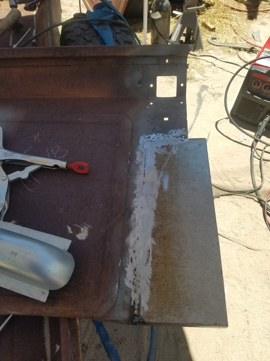

  8. Did find a 33/34 bed, As we know these things hung off the back like a over size load.
    Let the Bobbing begin.. If I recall cut about 18" off the back to get proper look.

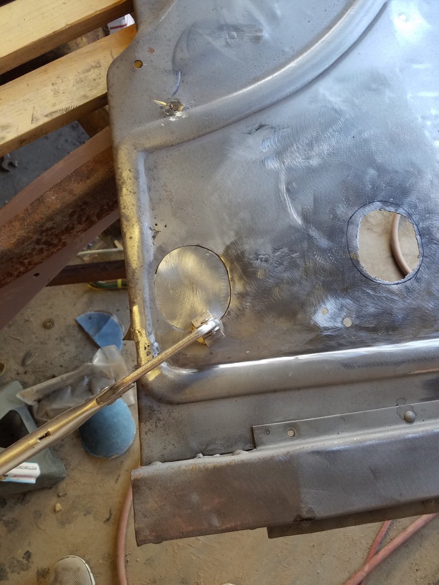

    When I ordered new rear pockets due to rust, Got the wrong years UGH, Instead of sending back, waiting for the correct ones got the body hammer out and started to form over a Piece of 3/4 plate to square off..

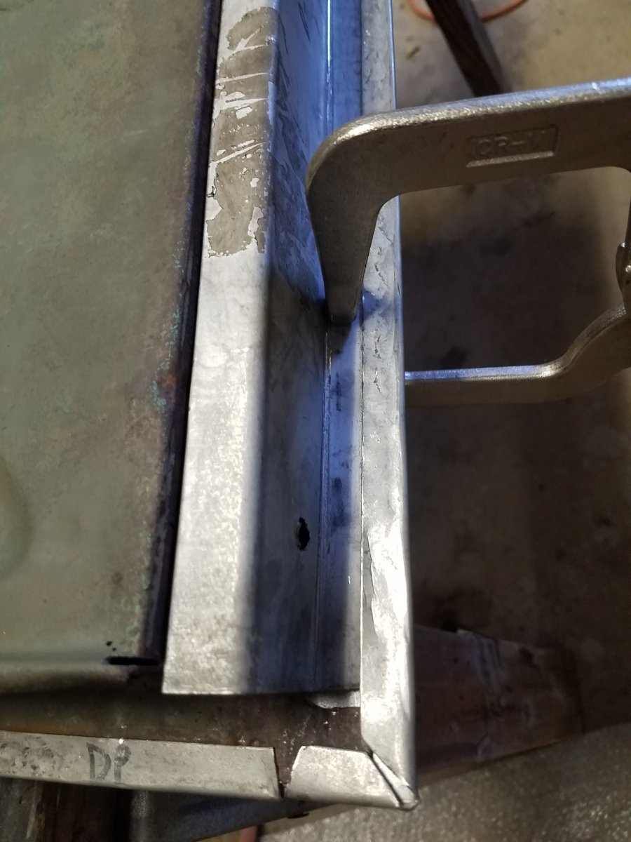

  9. The cab being Channeled The bed has to be done also..
    Can see where a cab corner had to be replaced.
    Moving the filler neck hole..

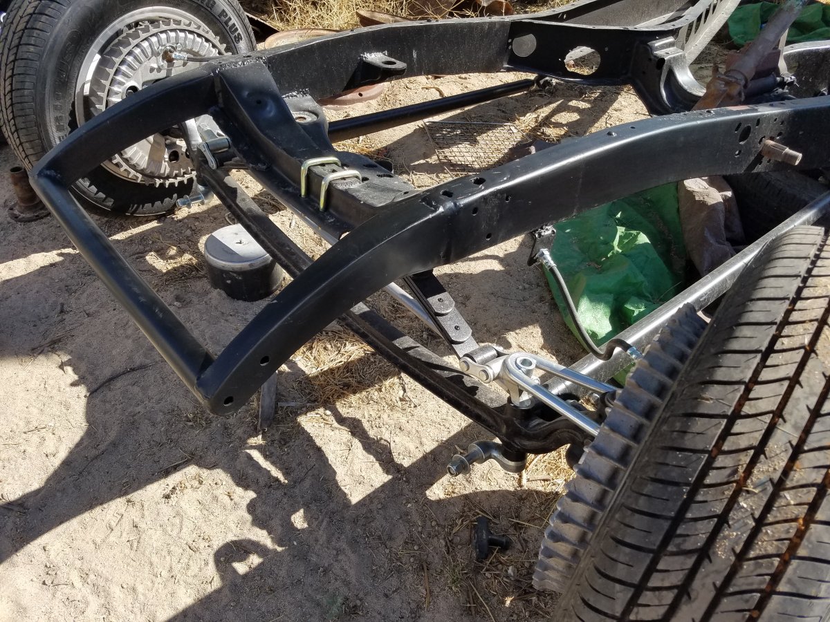

    Frame stripped and sand blasted.. Then metal primer and paint, Used Rust oleum satan black.
    I have used this stuff on a couple different chassis OT vehicle and it works well..

    got any dried shots of the chassis black? Been thinking of doing the same on my current build. Liking the idea that it would be so easy to touch up if I had to change something or it got a major ding
  24. Tim,
    I measured inside. Dash to back and door jamb to door jamb.
    Frame has been outside so it dirty I can get like that if you want?

  26. Here it after baking in the AZ sun for a few months.. Just wiped the dirt off by hand real quick,,

    That’s perfect man I appreciate it!
    I think I miss remembered the cab dimensions. I think a 33-34 pickup has a different firewall and gives more foot room than the 32 and that’s where my thought came from.
    did your spray the black paint or brush it? Looks great
