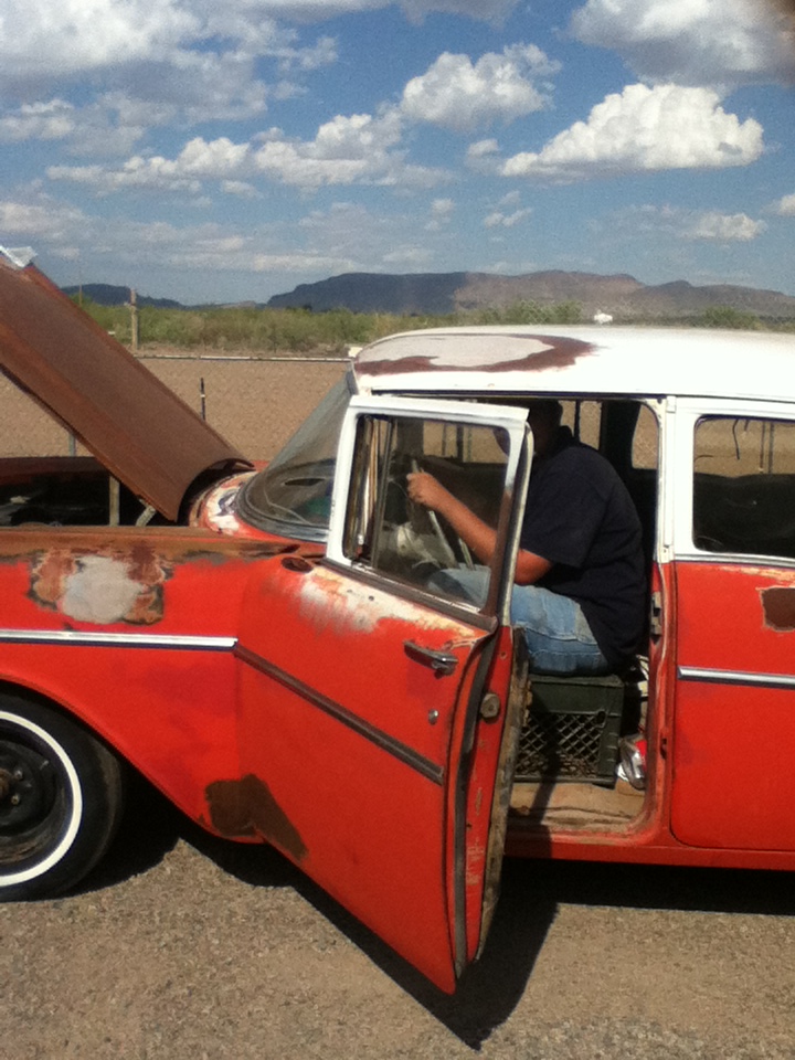

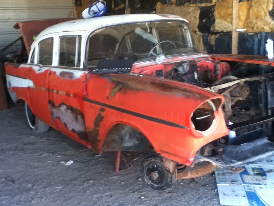

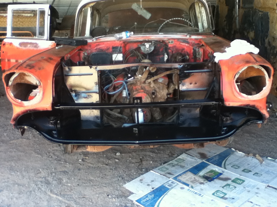

    To start off with, i am a 16 year old high-school student who has been infatuated with the 57 Chevy all my life. When I was two years old, my dad bought a 57 Chevy Belair 2dr Hardtop that was set up as a gasser. I guess i am biased in the fact that I beleive the 57 is the most beautiful Chevy ever and the 58 is the ugliest. :p (sorry lovers of the 58 Chevy) Anyways, i was on summer break in Deming, New Mexico at my grandparents house. The day after i arrived, my grandpa and I were driving around and I spotted this 57 Chevy sitting in backyard. All I could see was the left tail-fin from the back, but I immediately knew it was the car I NEEDED. :eek: We stopped and BOUGHT THE CAR with the cash I had been saving up for such a project. I was like a little kid in a candy store when we brought it home. I started digging through the trunk, finding bits and pieces of this car that had been sitting for 20+ years. The tires even held air!!! We stripped the car of all its chrome and gutted the interior. It is currently awaiting paint the one of the local body shops. We got the engine to run, but we don't know what it is.:confused: I beleive it to be a 283 or a 327. I cannot see the numbers on the bellhousing, but the numbers on the front of the block ahead of the right head is F070TS. It is an original I6 car so who would know. It has power pack heads, but has 327 valve covers and a 2 barrel rochester carb. I will try to get to the numbers on the back of the block, but if anyone can tell me what it is based on the front number, I would greatly appreciate it. :D
  2. Philroy
    Joined: Jul 9, 2012
    Posts: 150
    Philroy
    These are some pictures.

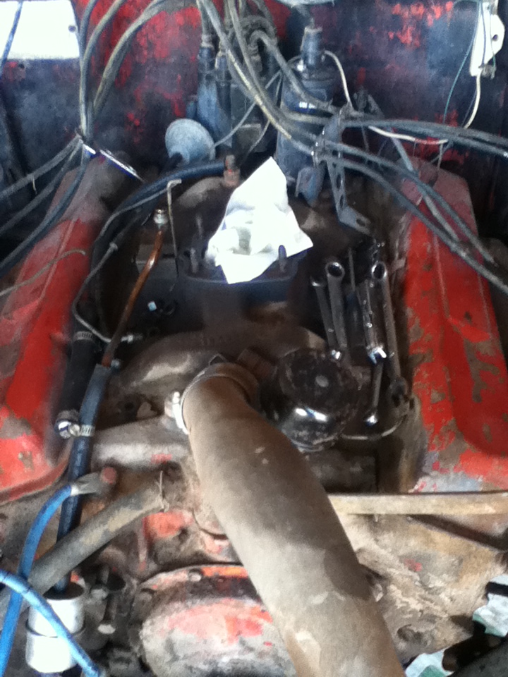

    Probably an early 327, assuming that it is really just an S suffix. Look at the numbers more closely, see if that T is really a number such as a 1, which looks like a I the way chevy stamps them.

    Squirrel, I have looked and It might be an I. I am not sure. The way it is stamped, it looks like a T. I am not sure. I will probably be rebuilding the engine this winter. Either in our shop or in power mechanics class. I will try to remember to go to the bodyshop tomorrow and see. mr 57, there is one quaarter-sized rust bubbling area on the right rocker. besides that and a quarter-sized spot on the fenders, thats it for rust.

    The reason I think it might be a number, is because of how they numbered the blocks. Having a zero right after the F means it is a 4 digit date code, since you only have 6 characters total, that means the suffix can only be one letter. So the T has to really be a number, and the S is the suffix.
    S was used for the Powerglide equipped 327 from 1962-64. Should be 250 hp, with a 4bbl carb. But who knows what's been done over the years.
    also you can look for casting date codes on all the cast iron parts like heads, manifolds, block, transmission, rearend, etc. Letter followed by two to four numbers, like B 25 7. Letter is the month, A=Jan, B=Feb, etc. Next one or two numbers are the day of the month, 1 = first, 25=twenty fifth,etc. Last number is the year, it sometimes has two digits, 7 would be 1957 (or 1967 or 1977) but if it has something like A 23 57 then it would be from 1957.

    I will take my magnifying glass and look to see if it's a 1. If it is a 1, does that mean it was made on june 7th of 61? I know its not a 57 block because it has the place to bolt on side mounts.

    The stamped numbers do not have the year, only the month and date. 0701 is July 1st, and you need to find the casting date code on the back of the block to figure out if that was 62, 63, or 64. I doubt they were already making 327s on July 1st 1961, but I could be wrong. btw I was almost two months old on July 1st 1961.

    I went to the bodyshop and scraped the crud off of the casting numbers.:cool: Squirrel was right on the money. The number is 3782870:eek: which indicates, according to the neighbor's sbc book, that it's a 62-65 327:D:D:D. And, that is a 1, not a T on the front number. Carmak, how much would you be looking to get out of your canopy?

    If you have some more time to look at it, see if you can find the casting date code on the back of the block. Should be in the same general area as the casting number you found, but possibly on the other side of the engine, and smaller. Then you will know what year it is.

    I looked at a 1958 283 block, it's on the pass side, just to the side from the center, not far from the distributor base.
