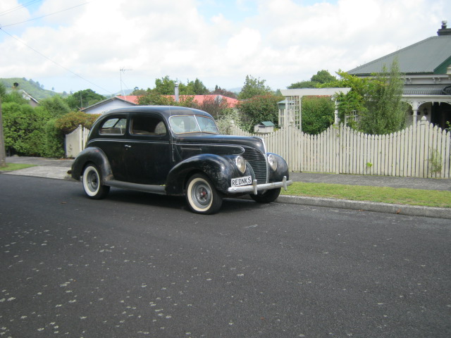

    Rapid progress here Rod. Beach hop here we come?? Neat ol car for sure. I did try to talk to mates into the Masterton one but they had coupe eyes, duh!! That was a nice ol original car , but they had no vision.

    That's a nice dry car to start with, your lucky.
    I was surprized to see the locking glove box and the clock on a standard model, I guess they offered those either way back then.

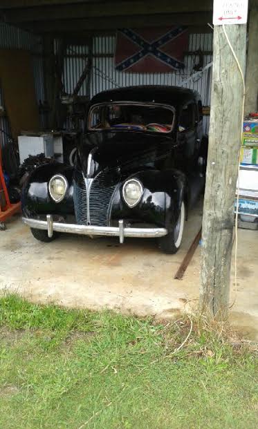

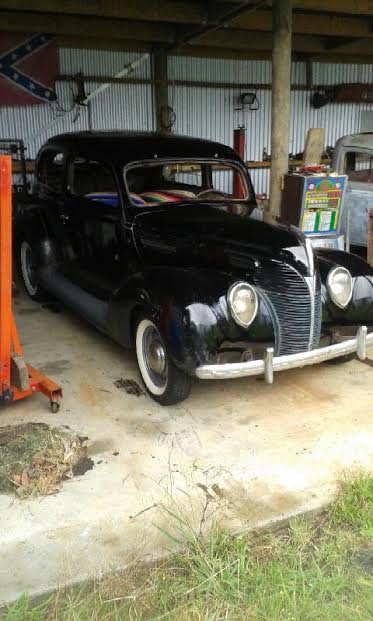

  10. Got the new brakes all buttoned up yesterday and took Wifey to the supermarket in it. There probably ain't many wives out there that would be comfortable balancing the temporary gas can between their legs on the passengers floor! :eek:
    Snapped a couple shots while it was out, The silver paint won't be staying on the wheels , I'm leaning towards a copper color but am open to suggestions ??
    Will be running ribbed beauty rings and '42 Passenger car caps .
  11. Nice car..I like your plans for it.
    Wheel color choice?..hmm black, or chrome reverse.
  12. Gloss black was my first thought but I was worried they might be a little "lost " on a black car?
  13. I think black would work well.JW
  14. Looks good rod!just an idea Cream or copper,with caps and rings??...
  15. Caps and rings are on the way , I've ordered a set of '42 caps . They're a nice simple cap and I think they'll look good with ribbed rings . Still undecided on copper or black for wheels yet.... might depend on the mood on the day the 'gun get's loaded !

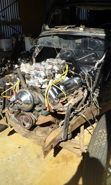

  20. unnamed (56).jpg unnamed (59).jpg unnamed (58).jpg unnamed (57).jpg unnamed (59).jpg unnamed (58).jpg unnamed (57).jpg unnamed (56).jpg Little more progress today . Slotted the Olds in for a test fit . Very happy with how it fits .
