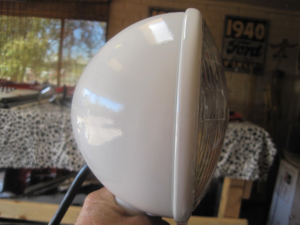

  4. Here is the finished product. Upgrade to H4 halogen bulbs with old school traditional lenses make for a bitchin' pair of headlights and one more option for the Curbspeed Coupe. I am going to attempt to use a hidden single receptacle under the edge of the frame to plug in different set of headlights quickly. We'll see if it works. Need to finish my set of Owlites soon. The other finished set are Arrows. IMG_3862.JPG IMG_3860.JPG IMG_3860.JPG IMG_3861.JPG

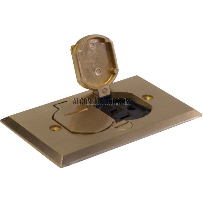

    How about one of these? Vintage looking. ;)
  15. LOL I actually have some old 20 amp outlets from my place up north they are even the dark Bakelite (correct word here?). Neat idea to make my headlights quick connect. ;)
