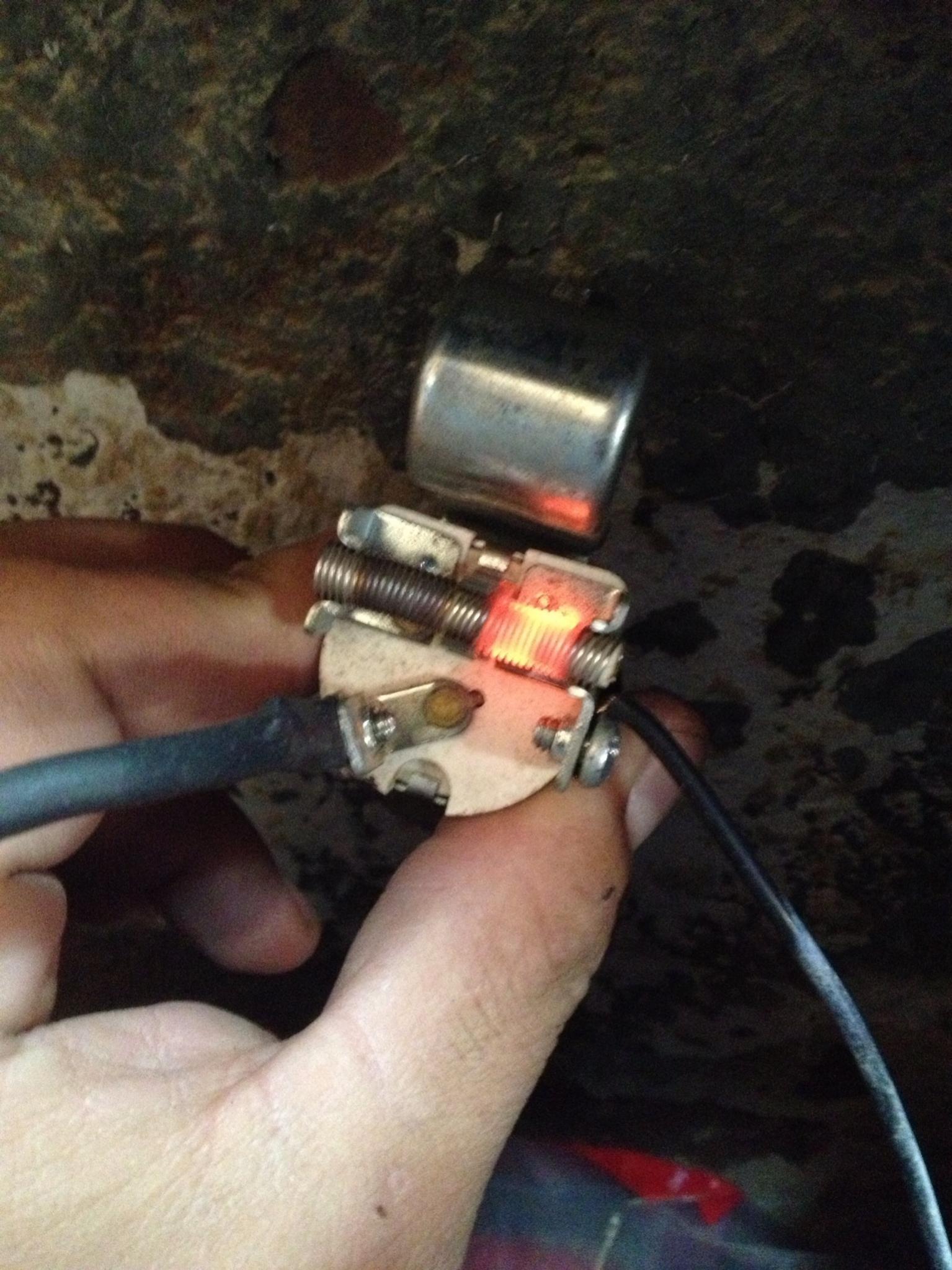

    I have a 1951 ford f1 and I have the original 6volt heater. The truck has been converted to 12v. I have a universal heater switch with a built in resistor. The coil is getting glowing hot. What is the fix for this? Any help would be greatly appreciated. Thank you

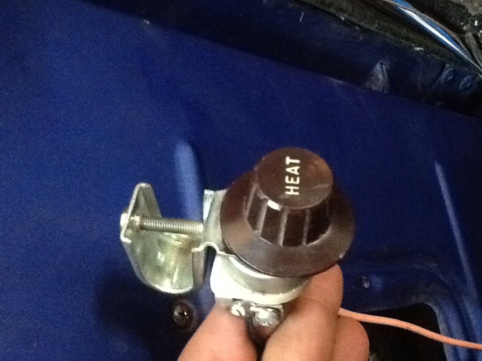

  3. jt7282
    Joined: Sep 29, 2009
    Posts: 149
    jt7282
    from Midland Tx
    Here's the switch

    If you get a ignition resister 1.5 ohms they are white ceramic used to reduce current.
    If you were to drop 3 volts that would cool it down. 2amps x 1.5 ohms = 3 volts
    That would be placed inline with switch.

  7. Install this in series in the power line to the switch.... this will be the cheapest/easiest solution short of a new motor. The resistor will get very hot so mount it where it won't cause problems; inside the heater in the fan airflow would be an excellent place.

    A resistor converts voltage to heat. Resistor size is directionally proportional to heat it gives off. I know that doesn't answer your exact question but that's why it's hot.

    Is there a tag on your 6 volt motor giving the amperage draw ? If your 6 volt motor draws 5 amps at 6 volts it would draw about 2.5 Amps at 12 volts so now we want to use Ohm's Law to reduce your motor back to 6 volts
    So if we take 6 Volt / 5 amps we get 1.2 Ohms and 6 volt * 5 amps we get 30 Watts
    So if we take 12 volts / 2.5 amps we get 4.8 Ohms and 12 * 2.5 amps we get 30 Watts
    So if my guess of your motor being rated at 5 amps is correct your field winding resistance whould be 1.2 ohms.
    So if we subtract the 1.2 ohms from the 4.8 ohms we get 3.6 ohms; we want a
    resistor that would be around 3.6 ohms and we want a resistor rated at least 30 watts.
    If it were me I would get a resistor rated at 100 watts and mount it to a piece of aluminum to act as a heat sink (because it will get hot). Here is an e-bay link for a 10 ohm resistor but if you let them know when and if you order it you can specify a 4 ohm resistor. http://www.ebay.com/itm/1PC-100W-Wa...393?pt=LH_DefaultDomain_2&hash=item2ecab26c59

    It gets hot because it is a resistor.

    Yep, a resistor switch is basically a little heater just like the electric heater with the coil of wire element. If it doesn't get hot it isn't working.
    There is the off chance that you may have one with the wrong rating for what you are doing but every resistor like that I have ever used will brand you in short order if you touch it when it is on.
  19. One other thing needs looking at; the switch. Installing a dropping resistor to reduce voltage to the motor will introduce additional load into the circuit across the resistor. I can't say that reducing the motor voltage will reduce the motor amps enough to offset the load from the resistor, so the switch may be undersized. A higher-amp-rated switch may be needed once the motor speed is finalized.
