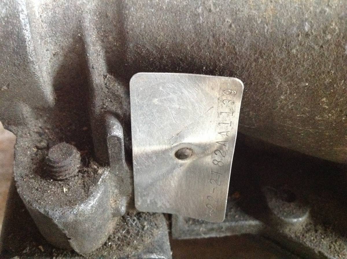

    Looking to acquire a TH200-4R as a replacement for a PG behind a 327/300 in a full size Chevy. Found this but the tag looks to have been scoured clean. From what's visible can only tell it's of '82 vintage, Three Rivers, etc. Anyone spot indicators to narrow it down a bit more to verify desirability?

    The 200's do not have a removable tail housing. They are a one piece case like the one in your pic.
  3. Hnstray
    Joined: Aug 23, 2009
    Posts: 10,961
    Hnstray
    from Quincy, IL
    Yes, that is a 2004R. If you are buying it as a core, planning to rebuild it, it's looks like a good start.

    • 1982-1985 transmissions use a two letter code on the tag & 1986-1990 transmissions use a three letter code with an "F" at the end of the code
    • 1982-85 transmissions use a 13 digit numbering system to show what it is & when it was built. These numbers are on the bottom of the transmission tag below the letter code {EXAMPLE: 123 2T85CQ1234}.
      • The first three digits are the Julian date {the date the transmission was built, julian date is the start of trans production so 001 would not be january 1st.
      • The 4th digit is the Plant Shift the transmission was built {1=1st shift; 2=2nd shift; 3=3rd shift}.
      • The 5th digit may be a letter or number & is the code for the Hydramatic plant that the trans was built at.
      • The 6th & 7th digits are the model year of the vehicle the trans was originally installed in.
      • The 8th and 9th digits are the two letter code of the transmission & denotes internal parts & valve body calibration of the unit.
      • The 10th through 13th digits is the serial number of the unit.
    • 1986-1990 transmissions use a 15 digit numbering system {EXAMPLE: 9 123 2T86CZF 1234}.
      • The 1st digit is the Calender year the unit was built.
      • The 2nd,3rd, & 4th digits are the Julian Date {see above}.
      • The 5th digit is the Plant Shift the trans was built.
      • The 6th digit is the Hydramatic plant the trans was built at.
      • The 7th & 8th digits are the model year of the vehicle the trans was installed in.
      • The 9th & 10th digits are the two letter code of the transmission & denotes internal parts & valve body calibration of the unit.
      • The 11th digit is the letter "F". This denotes that the trans is a 200-4R {GM decided to add a third letter to the code that will show what transmission family it is, 200C = "B", 200-4R = "F", 700-R4 = "M", etc...}.
      • The last 4 numbers are the serial number of the unit.
    200Rs were found in:-
    • 1981-'88 Buick LeSabre and Electra RWD
    • 1981 Century
    • 1981-'87 Regal
    • 1981-'90 Cadillac Fleetwood, Deville and Brougham
    • 1982-'90 Chevrolet Impala and Caprice
    • 1981-'88 Chevelle, Monte Carlo, Malibu and El Camino
    • 1984-'87 GMC Caballero
    • 1982-'90 Olds Delta 88, 98 and Custom Cruiser
    • 1983-'88 Olds Cutlass 4-4-2 and Supreme
    • 1983-'89 Pontiac Bonneville, Parisienne and Safari Wagon
    • 1981 Pontiac Firebird with 301
    • 1984-'87 Pontiac Grand Prix
      The transmission identification is on a plate on the right side of the case towards the tailshaft. This ID tag is usually held on by one rivet. The plate will have a two- or three-letter transmission code in large letters, and then a 13- or 14-digit identification number along the bottom:
      • 1st digit: month of production (A through M, skipping the letter "I")
      • 2nd-3rd: production day of the month
      • 4th: shift transmission was produced (1st-3rd shift)
      • 5th: assembly plant (T: Three Rivers, MI; J: Windsor, Canada; W: Warren, MI)
      • 6th-7th: decade and year
      • 8th-9th: or 8th-10th: transmission ID code
      • 10th-13th: or 11th-14th: transmission serial number

    Yes, as already identified, an AA code from an 82 Cadillac. If economical enough, you might consider picking it up for parts. I would be leary of it without the matching vb/gov combo. These are a set from the factory and mixing/matching is a hit and miss effort, and can result in a lot of frustration and trans fluid baths dropping the pan repeatedly trying to get the shifts sorted out.
