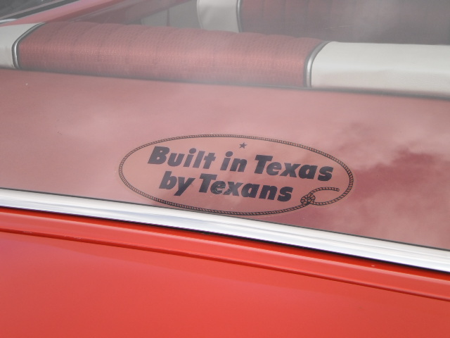

    I'd like to reproduce this one. My '51 F1 and my '51 Deluxe were both built at the Dallas ford plant.
