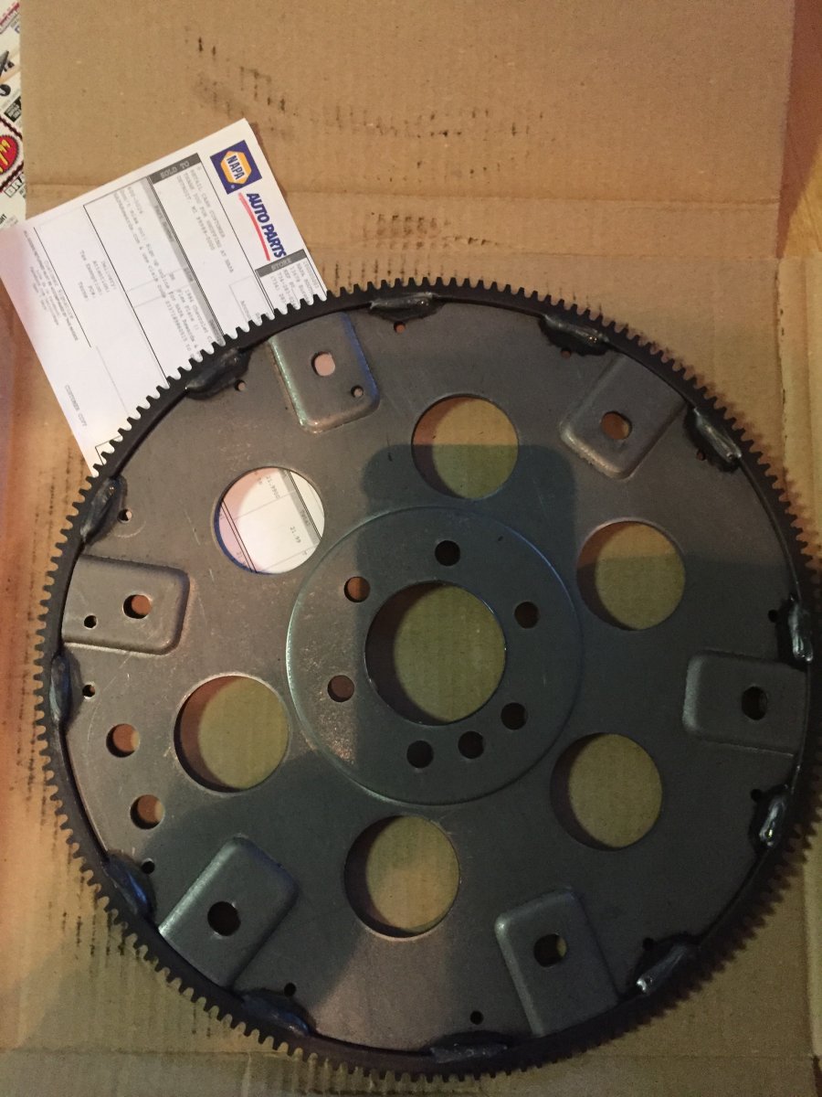

    IMG_0483.JPG Went to my local Napa today and picked up the flex plate to put the 700r4 behind the mighty 250 I6.

    Original rear axle gear was pretty low by today's standards but should be just about perfect with an overdrive transmission. And the six won't have enough HP to overpower it so, no reason to change it.
