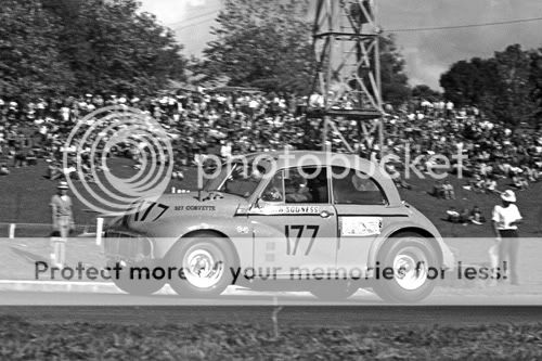

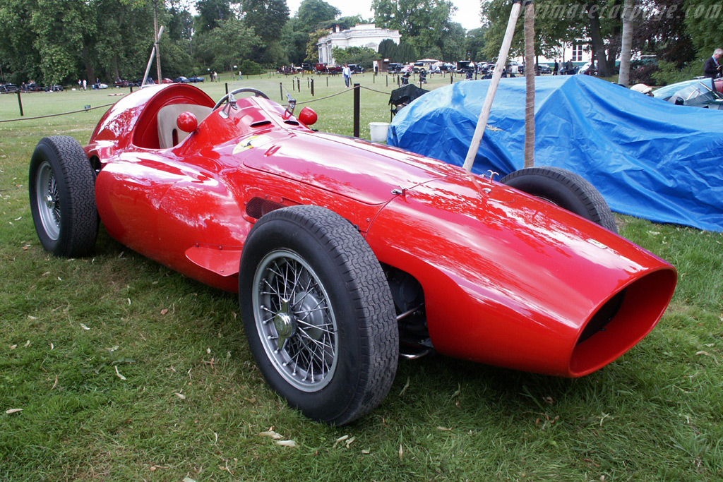

    In the 660s a Kiwi hot rodder , Garth Souness,took the chassis from this, replaced the Ferrari motor with a 327 SBC and put it all under a Morrie Minor ( Lowlite..
    raced it in All Comers class ..a national racing series in NZ for run what ya brung..
    Here tis
