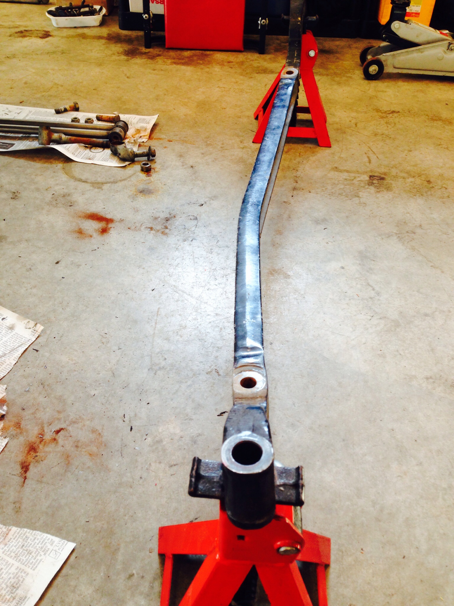

    I have a '33 Plymouth that was completed 30 years ago. I put in a used Ford dropped I-Beam with Four Bar front suspension. That axle was dropped 5" and stretched to 50" by Mor-Drop Axle Company. It served me well over the years.
    A few weeks ago traveling 60+MPH I ran into a drive shaft that fell out from under a truck in front of me on the highway. That impact bent my axle back about 4" to 5". I want to replace the axle with one that's 48" and a 4" drop. I've read a number of older posts on here about poor quality, possibly off shore cast iron axles breaking. I'm very afraid that if I had one of those under my car the results would have been a lot worse. I know this has been asked and answered several times but all those posts are quite old. Things change and I'd like to know more about the current availability. How do I make sure I'm getting a forged, made in USA, axle?

    Just get that on straightened.
    This is a Model A axle. You didn't hurt it:
    Hitchhiker and saltflats like this.

    I'd get a gennie axle and have Sid magnaflux it and drop it to your specs. He's the real deal.
  17. El KaMiNo KiD
    Joined: Jun 15, 2009
    Posts: 509
    El KaMiNo KiD
    After looking at that pic an original axle is the only way to go..
    gimpyshotrods likes this.
  18. RidgeRunner
    Joined: Feb 9, 2007
    Posts: 838
    RidgeRunner
    from Western MA
    The tour guide pointed out an axle like that hanging on the wall at Speedy Bill's museum in '08. Might have been that exact same one, IIRC he said Henry had it done to demonstrate how though they were. Impressed me enough That I'd follow the advice of others and get an original done to your specs by someone reputable if I were in your situation.
