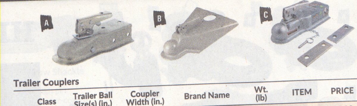

    DIYGUY and RoadsterDom like this.

    trailer hitch isn’t a bad shout
    That @swissmike tech tip is impressive
    I think a model a one is the wrong size , probably a question best asked on the ford barn but certainly using a bolt in cap is the best idea .
