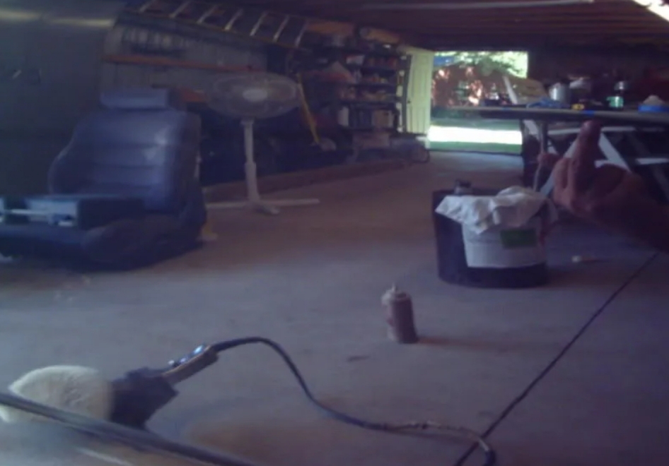

    Thanx @Bandit Billy and it's a no mud car too. I did do 1 little swipe of metal glaze to fill a weld spot, maybe the size of a biz card. I've posted these before, here's another view. That door is about 30' away and still a clear image.
    No pinstripes were harmed in the finish of this car...:rolleyes:

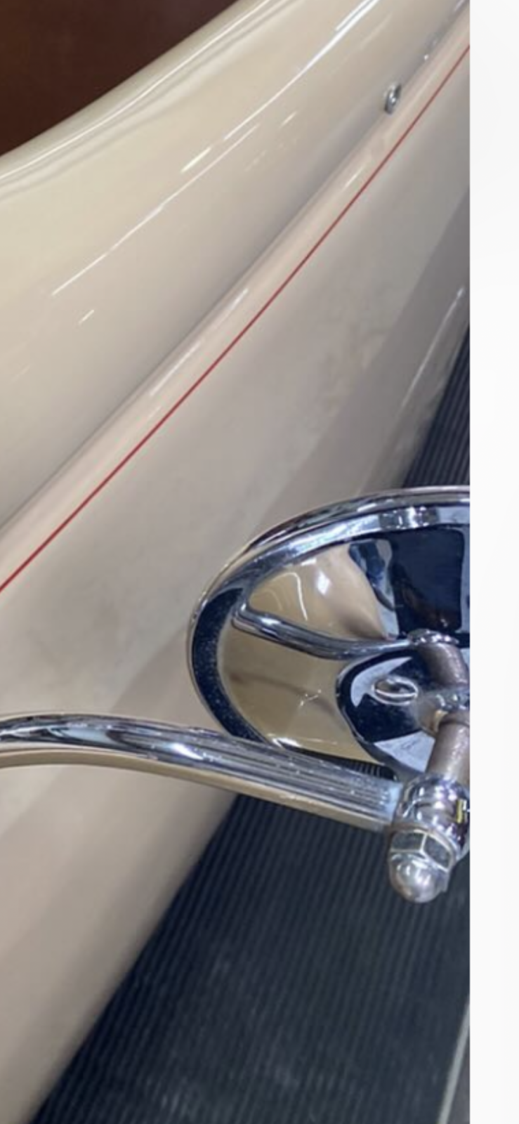

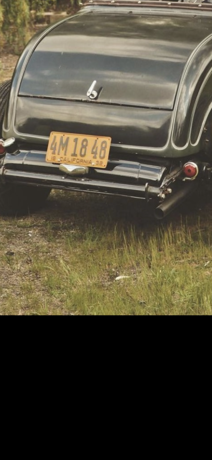

    F6F6319C-569E-488B-B8BD-2C8CBA125DF6.png Sorry for the delay on pics , I spaced it . There’s is a second car I want to remove pinstripes on , it has a nice paintjob ( not sure on what materials of paint were used )
    The roadster has white pinstripes , the other car has red pinstripe over a brownish/cream color . I am more concerned with not messing up the paint on the brown car. The roadster paint is old and weathered so it’s not as big of a concern .

    The car with the nicer paint job , red pinstripe .I know some guys love pinstripes they just aren’t for me
