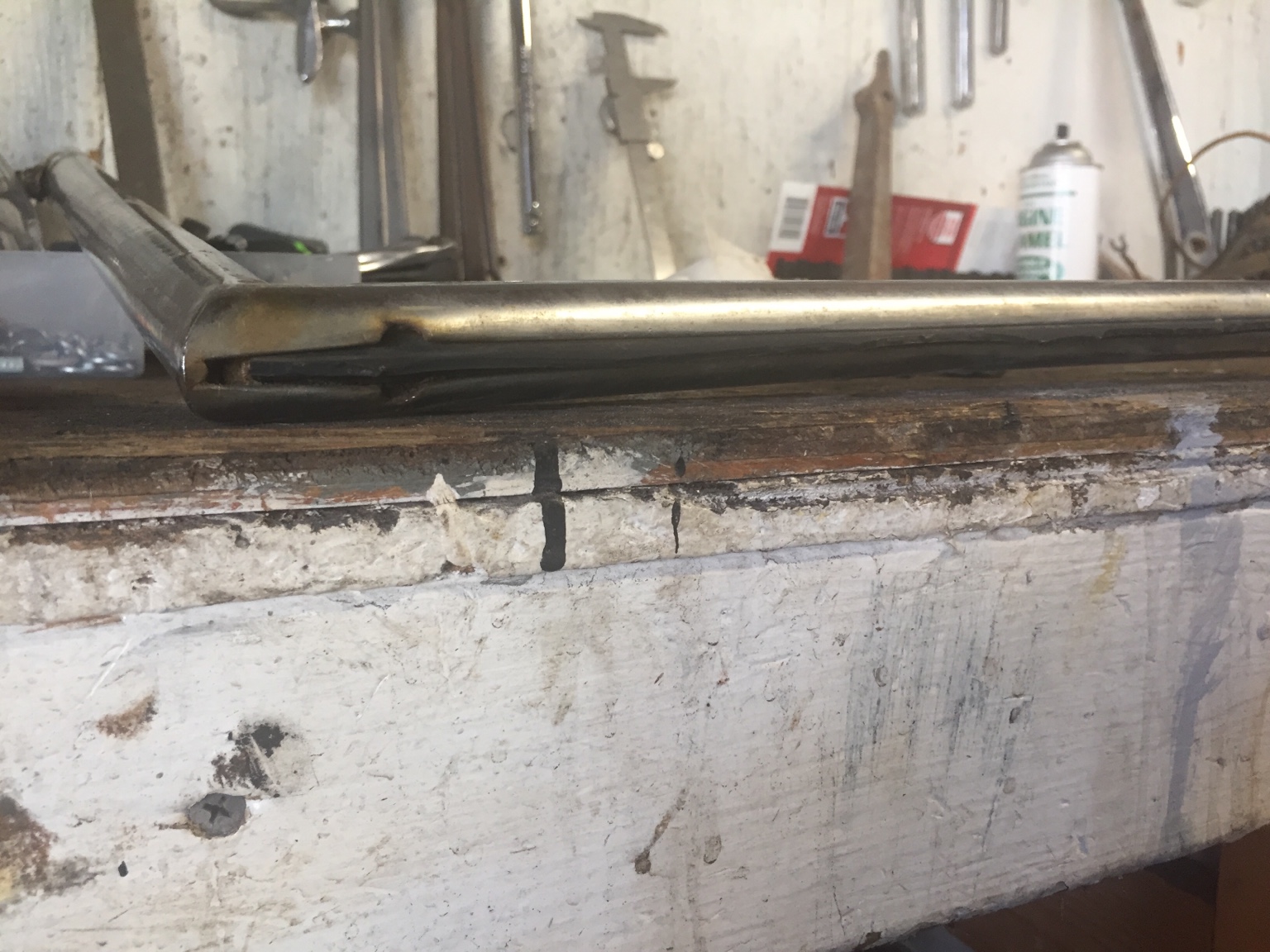

    I’m currently working on a 28 Ford open car and the rubber seal below the windshield has hardened like old plastic. When trying to remove it, it just breaks off in chips. It is a “T” shaped rubber extrusion that goes into a channel in the windshield frame. How do you guys remove this old rubber from the channel?[​IMG]

    Hammer, chisel, utility knife, dynamite. Or all of the above. You just have to chip away at it usually.... Ain't old cars fun?

    warm with a heat gun.

    Thank you for the help. I started by heating up the area and that made the rubber soft again. Then it moved a little easier and I’ve been taking it out piece by piece with a screwdriver and the help of soapy water [​IMG]
