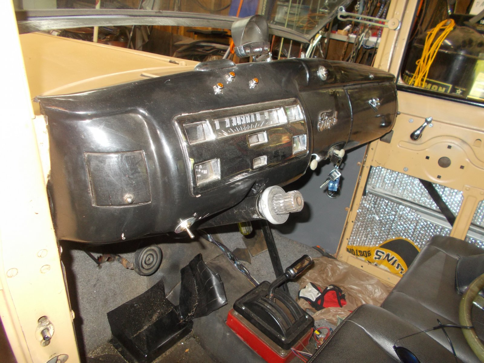

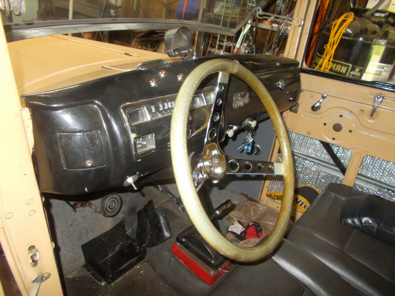

    i used the speedway hex hub as it would be faster to install the wheel than the spline when a bunch of us were getting gas, and blasting on down the road...
    but it wore faster and got a little sloppy after a few years...
    so i put the spline style on my coupe, slower to install [align] every time but seems a tighter fit...

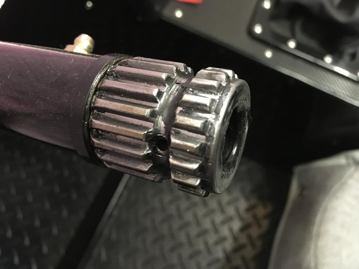

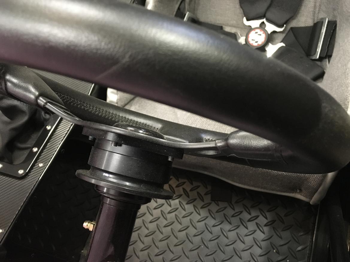

    Well don’t know if this helps or not but I used a roll pin/spring pin that I drilled through the undercut in the splined adapter and shaft. The roll pin/spring pin would have been sufficient but also added weld to adapter and shaft. For steering I wanted something robust and didn’t want to trust just roll pin or just weld. Should be noted that when steering wheel is on it encapsulates the roll pin so it cannot come out. Also drilled hole though adapter and shaft with pilot hole first so when did final drilled hole for roll pin it would be proper tight fit. The quick release I used has a ring you slide back to take off steering wheel rather then pin and there is very little play between between adapter and steering wheel. 7CEAD4BA-4179-44E7-AD0A-C60163D3C9E9.jpeg 203BE607-C6D2-49D6-9996-CCFA78CB54A5.jpeg

    I, like Pirate, have always used the spring loaded spline disconnect. Solid mount with no play.

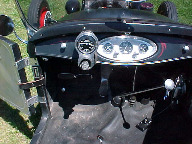

    You have a nice setup, looks like the PTO on my tractor. The female spline (on the accessory driveshaft) has a spring loaded pin to depress when removing or installing the driveshaft, such as when I swap the backhoe for the snowblower.

    The removable steering wheel looked very good to me but I cannot see how the hub is attached to the steering column......keep in mind mine is a "splined" column and I want something that just slips on it and bolts on......is that what this is in some way?
    Thanks.........dave in Illinois

    I love the looks of that but is the steering column itself also "splined" as mine is.
    Thanks..........Dave in Illinois

    No my steering shaft was not splined it was just round heavy wall tubing. The adapter slipped over tubing and I drilled for roll pin/spring pin and then TIG welded adapter to tubing. You might try going to the Grant Steering Wheel website. I think they do have some quick release adapters with internal splines that bolt on with a nut. You would have to know the dimensions of you spline.
