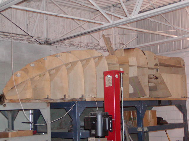

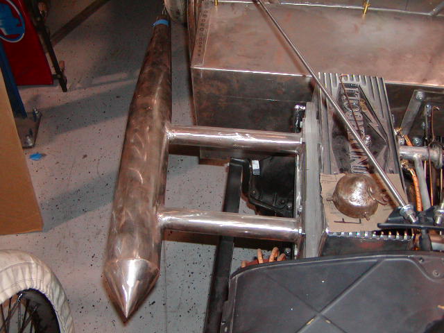

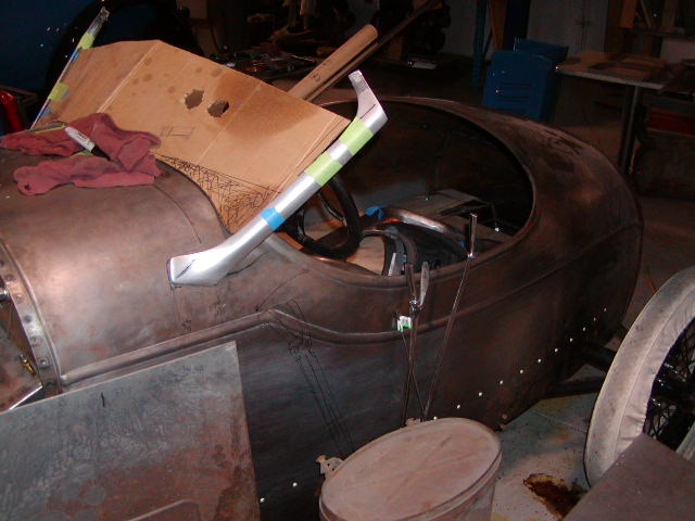

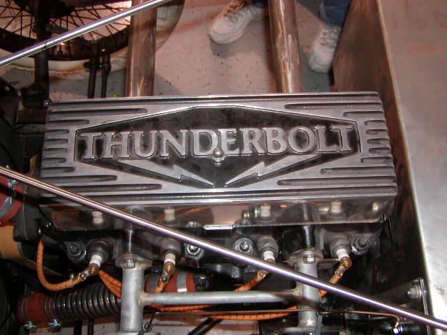

    Here are some photos I took of a Model T Speedster today that you might enjoy. Being built by McPherson College students here in Kansas.

    poverty, That car is sweet. Glad to see people working on cool stuff,AND have it recognised by the educational system as skills with merit.
    I have a couple Q's about that one
    Did they make the windshield posts?
    Is the front spring wrapped with rope just to protect it from scratches or would someone soak it with heavy oil to keep it lubed??

    Hi Corn Boy how are you doing? Not sure about the front spring wrap. Didn't ask. They did cast the aluminum windshield posts in their own small foundry and are still working on a center post trying to get one that's perfect. They showed me their wood pattern that was used for making the molds.

    They wraped the spring to keep the dust and dirt out ot the springs.
    Back in the day, most of the racers like that speedster were racing on dirt tracks and roads. Even Indy was dirt before they paved it with bricks.

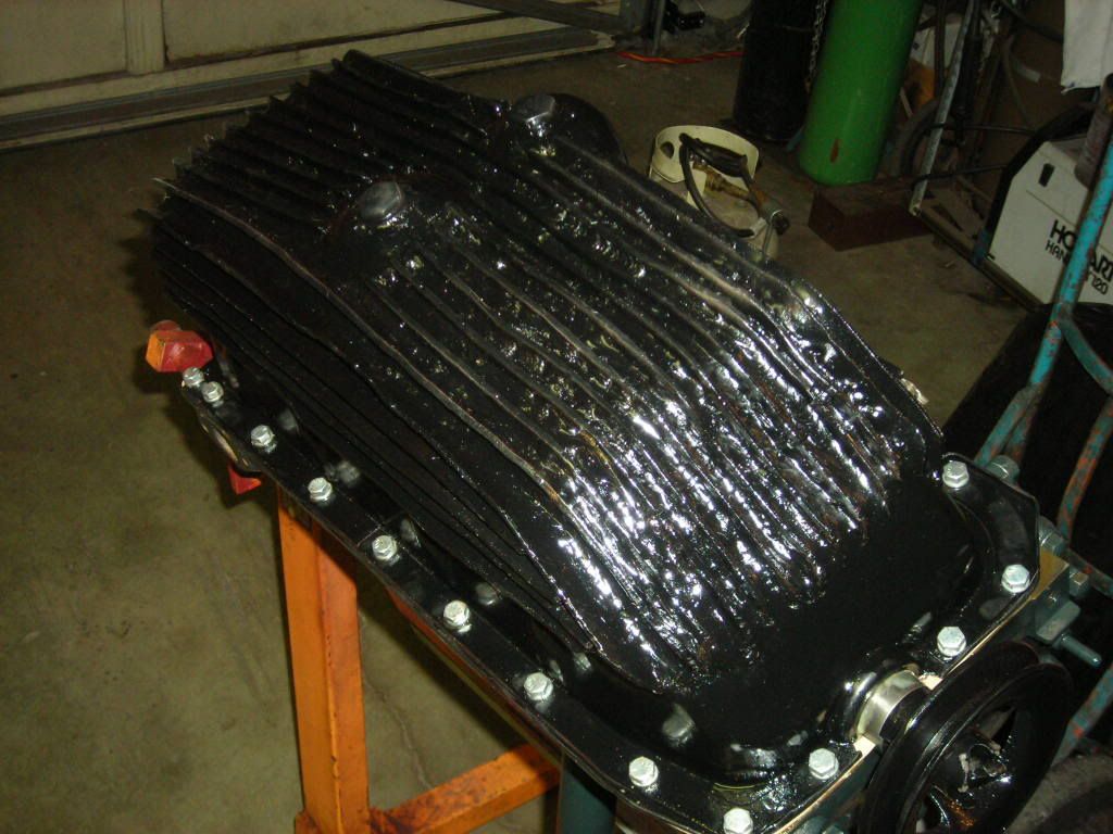

    Heres the pics of the pan. The dipper tray has been brazed in, note the double drain plugs. The friggin pan must weigh about 30 pounds! It does not look as bad in person, the light makes it look like a shittin mess!! Just buttoned her up tonight, gonna run it this weekend! Y'all keep yer fingers crossed :D
  22. I don't really know performance wise, as I havn't run it for more than about a minut at a time. Been fighting a rear main leak for a year. Get a flange cut and make your own!!

    That is crazy!!!!! someone spent a lot of time and braze on that pan.
    I hope the thing works out for ya. Looks cool!!! I wish I could find a finned aluminum pan that wasn't any deeper then a stock pan.
